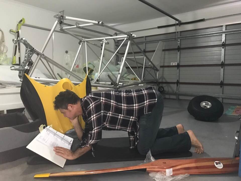

Note: this build is for the taildragger version of the Skyreach Bushcat, so bear in mind some sections may be a little different to the tricycle version.
So I won't be posting every time I screw a nut onto a bolt. Mostly I will highlight points of interest, tricks and solutions and general thoughts. Also I am discovering that I am needing 'special' tools sooner than anticipated, so in this first post I will list any special tools/materials and the section of the Bushcat build I first needed them in. That way if anyone else is building a Skyreach Bushcat they can see when they have to spring for them without having to buy them all at once. At the time of writing this, I was up to section 17. I would suggest it won’t take long to get that far.
Torque seal                                - Section 1
Pop rivet gun                             - Section 2 (not really a special tool as such, but I didn't have one handy so it goes in the list!)
Loctite 243                                - Section 12
Cable tension gauge                 - Section 14
0.82 safety wire                         - Section 14 (choose any unit of measure you like- miles, parsecs, cubits. I myself went for millimeters as that will have the best fit in the hole)
modified pointy nosed pliers     - Section 17
M6 taps (through and bottom)   - Section 25
special wheel bearing grease    - Section 29
loctite 572                                  - Section 53
