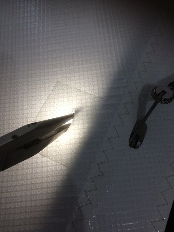

installing the first bit of trilam on the skyreach bushcat.

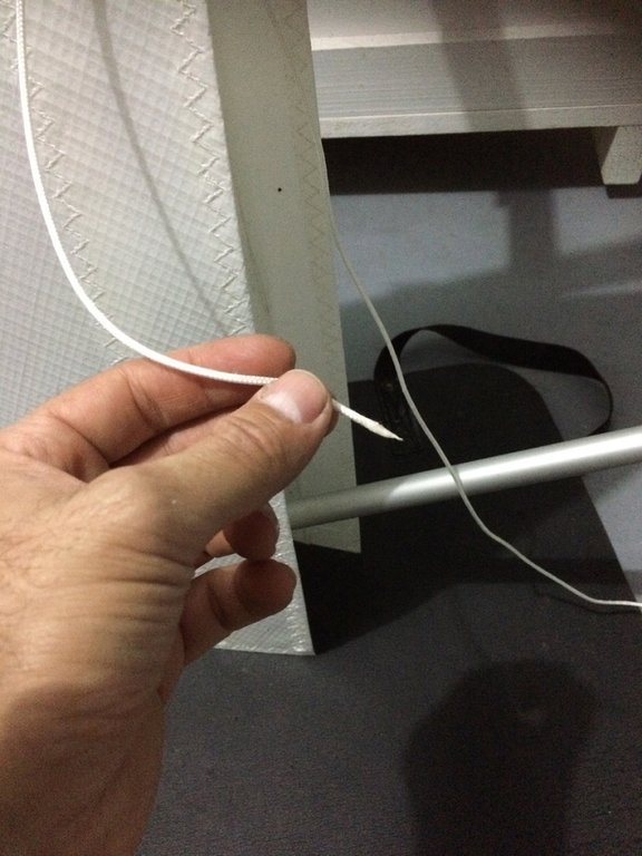

ive never been good at lacing my shoes so this will be a challenge ? but at least I can make it easier to thread the lace with some superglue on the end and rolled between wet fingers to make a ‘needle’. I’ve now perfected my technique. Ignoring the fluffy end of the string I soak about a 10mm section with superglue. When it has set I cut it on about a 45 degree angle. Then a bit more glue on the cut end.
also, save the leftover string! On a later section you need to lace the aft end up with a short length of string. Mine was too short! Luckily the leftover string from this section was longer ?
When the the covering is done, you will need to get a nut and washer inside the covering and onto a thread. I found by sitting that part onto a torch pointing up, I was able to do this without too much trouble.
