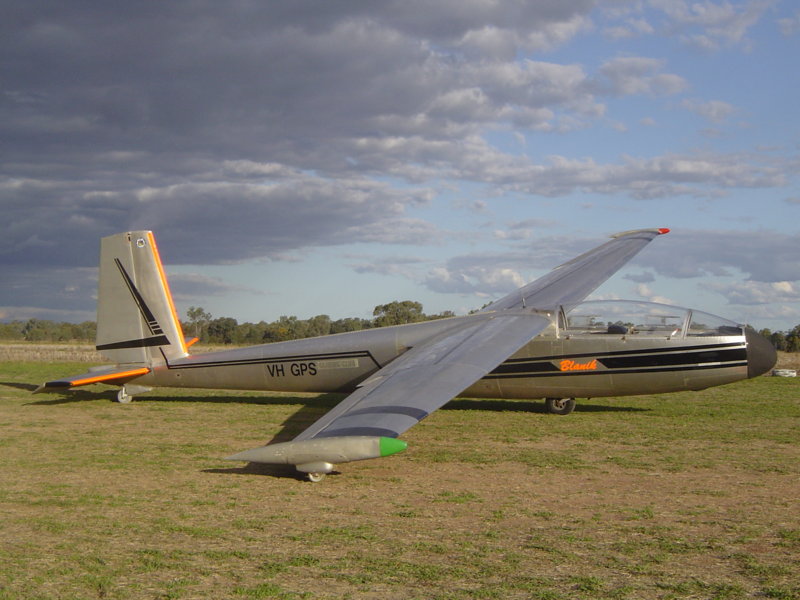

Blueadventures Posted October 9, 2013 Share Posted October 9, 2013 Hi Dafydd That was a great Mod you designed. A little history of the modified Blanik I fly is that when the previous owners (a club south west of Sydney) sold her thier reason was the preceived or apparant drag of the external reinforcing under the wing. When the new owner got her to Central Queensland they often compared the glide performance with the other glider and theres no difference. Then I bought her pre the grounding and I carn't say how happy I am that they sold off the modified Blank all those years ago. The one I have is VH-GPS and she flys great. Cheers Mike Link to comment Share on other sites More sharing options...
Blueadventures Posted October 9, 2013 Share Posted October 9, 2013 Blanik L13A-1 1 1 Link to comment Share on other sites More sharing options...

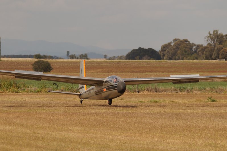

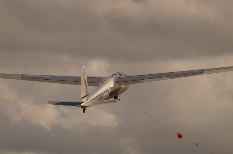

Blueadventures Posted October 9, 2013 Share Posted October 9, 2013 post: 315686, member: 5112"]Blanik L13A-1 Blanik GPS winch launch, in flight and flared for landing. Cheers Mike 1 Link to comment Share on other sites More sharing options...

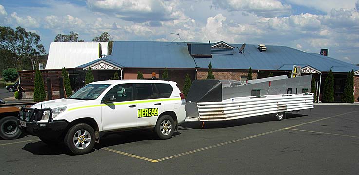

Dafydd Llewellyn Posted October 9, 2013 Share Posted October 9, 2013 Thanks for that. Here's what our one will look like (I'm still rib-stitching ailerons; the main life-extension work is complete). You're correct, the mod makes no measurable difference to the performance; we checked it way back by flying one with one modified wing and one unmodified wing; it showed no turning tendency whatever. I renewed my gliding currency a couple of weeks ago, on the Bundaberg one, VH-XQO; it still flies just as nicely as I remembered. 1 Link to comment Share on other sites More sharing options...

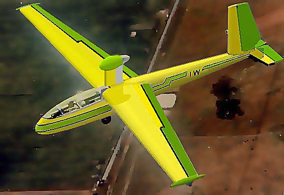

paulh Posted October 9, 2013 Share Posted October 9, 2013 A motor blanik - what sort of engine/motor and prop combination is envisaged? It would be interesting to know how much hp is required, and will it be purely to get to altitude and avoid outlandings or be enough for some motor touring? (need a big bump in the trailer for the motor pylon!) Link to comment Share on other sites More sharing options...
Dafydd Llewellyn Posted October 9, 2013 Share Posted October 9, 2013 A motor blanik - what sort of engine/motor and prop combination is envisaged? It would be interesting to know how much hp is required, and will it be purely to get to altitude and avoid outlandings or be enough for some motor touring? (need a big bump in the trailer for the motor pylon!) Rotax 582 DCDI model 99; single-blade folding pusher (experimental). It's intended to be a cruising motorglider; target is 80 KTAS at 50% power. My trailer has no problem with the engine pylon . . . 2 Link to comment Share on other sites More sharing options...
paulh Posted October 9, 2013 Share Posted October 9, 2013 Rotax 582 DCDI model 99; single-blade folding pusher (experimental). It's intended to be a cruising motorglider; target is 80 KTAS at 50% power. My trailer has no problem with the engine pylon . . . Thanks Dafydd - interesting aircraft 1 Link to comment Share on other sites More sharing options...

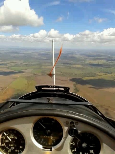

Dafydd Llewellyn Posted October 11, 2013 Share Posted October 11, 2013 Hi ExadiosMy Blanik L13A-1, VH-GPS, was back up in the air last Saturday. It was great to have her back up. I'm looking forward to many flights again this year and perhaps get the 300 kms done. I think this will be the third or fourth one back on line out of the original Llewlyn modified Blaniks. Cheers Mike Mike, I'd reply to your conversation, if I could get the thing to give me a "reply" button. meanwhile, in response to your question: Yes, it will have two seats; it will have an MTOW of 600 Kg in the normal category - i.e. a downgrade from the "cloud flying" category. However I'll not be certificating it; it will be under the Australian Experimental rules - see CASR 21.191(a) and 21.191(i). The reason is that the motor - Rotax 582 Model 99 (Type E gearbox) - does not have a TC; also I'm planning to use a single-blade folding pusher propeller, which will also be experimental. (The Hoffman option is out of the question, due to their ridiculous overhaul requirements). At that weight, the fatigue life is used at about 2.8 times the normal rate. The installation of the hard points in the fuselage for the engine pylon added about $2500 to the cost of the fatigue mod; I'll be building the rest myself. The engine mod. needs the nose bumper replaced by a wheel, to prevent it digging the nose in if you open the engine up too fast on takeoff; and I'm planning an improved tail wheel installation, with much better energy absorption, because if it does dig the nose in, it then comes down on the tail with a wallop when you throttle back. The Rotax 582 costs around $7000 here in Australia, complete with Type E gearbox, so the added cost of the powerplant is likely to be about double that. The reason I want to use the Rotax 582, is that it's an oil-injection motor, which means one can use it rather more like a four-stroke, than is normal with 2-stroke engines; it will cruise at around 80 KTAS on 50% power, so that's a significant consideration. There have been innumerable attempts at putting engines on Blaniks, including the L13J - but they have all failed, except the Riley one, because unless they are extremely "clean" with power off, they cause unacceptable buffet on the vertical tail. Link to comment Share on other sites More sharing options...
Dafydd Llewellyn Posted October 11, 2013 Share Posted October 11, 2013 Mike, I'd reply to your conversation, if I could get the thing to give me a "reply" button. meanwhile, in response to your question:Yes, it will have two seats; it will have an MTOW of 600 Kg in the normal category - i.e. a downgrade from the "cloud flying" category. However I'll not be certificating it; it will be under the Australian Experimental rules - see CASR 21.191(a) and 21.191(i). The reason is that the motor - Rotax 582 Model 99 (Type E gearbox) - does not have a TC; also I'm planning to use a single-blade folding pusher propeller, which will also be experimental. (The Hoffman option is out of the question, due to their ridiculous overhaul requirements). At that weight, the fatigue life is used at about 2.8 times the normal rate. The installation of the hard points in the fuselage for the engine pylon added about $2500 to the cost of the fatigue mod; I'll be building the rest myself. The engine mod. needs the nose bumper replaced by a wheel, to prevent it digging the nose in if you open the engine up too fast on takeoff; and I'm planning an improved tail wheel installation, with much better energy absorption, because if it does dig the nose in, it then comes down on the tail with a wallop when you throttle back. The Rotax 582 costs around $7000 here in Australia, complete with Type E gearbox, so the added cost of the powerplant is likely to be about double that. The reason I want to use the Rotax 582, is that it's an oil-injection motor, which means one can use it rather more like a four-stroke, than is normal with 2-stroke engines; it will cruise at around 80 KTAS on 50% power, so that's a significant consideration. There have been innumerable attempts at putting engines on Blaniks, including the L13J - but they have all failed, except the Riley one, because unless they are extremely "clean" with power off, they cause unacceptable buffet on the vertical tail. Please understand - I'm NOT trying to sell anything; this is a retirement project for my own enjoyment. Anybody who wants to can do likewise - but you'd best start with an L-13A1. Link to comment Share on other sites More sharing options...
