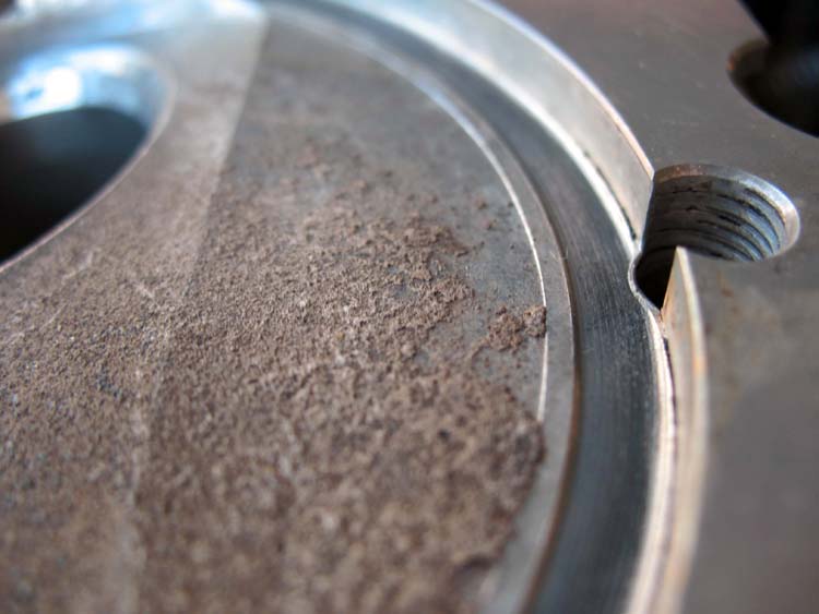

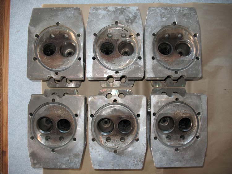

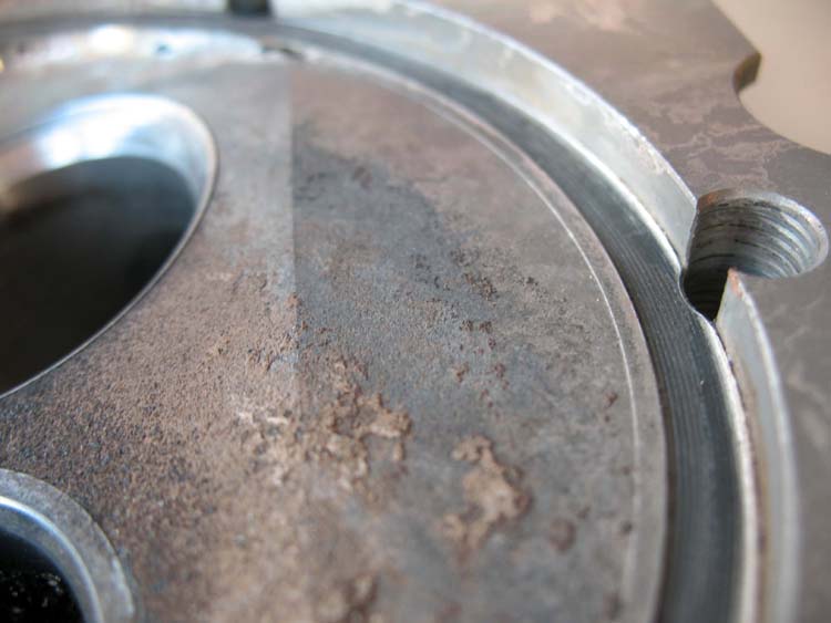

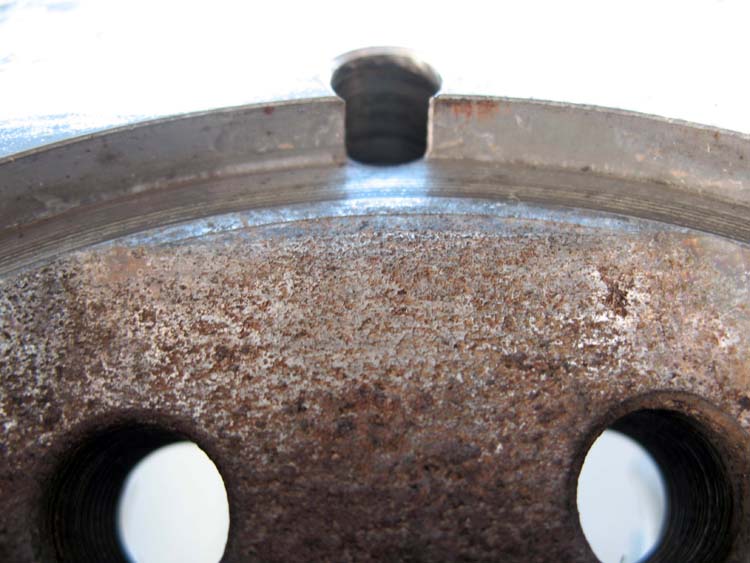

Thanks for the helpful advice so far. I'll try and attach some photos from disassembly of the heads hopefully showing the problem area- I'll take some better images when I get the heads back later this week. Connection is patchy what with the earthquake today...and that was just in Wellington Airport! Who knew Christchurch Information directed all jet traffic in NZ...
Jabiru Engine support have emailed telling me there is no Leeb hardness number available for the aluminium heads used in my engine. Moot point really - the cylinder has crushed the heads so they are too soft for whatever torque I had them at (24ftlb cold, but maybe I need to calibrate the torque wrench again!)

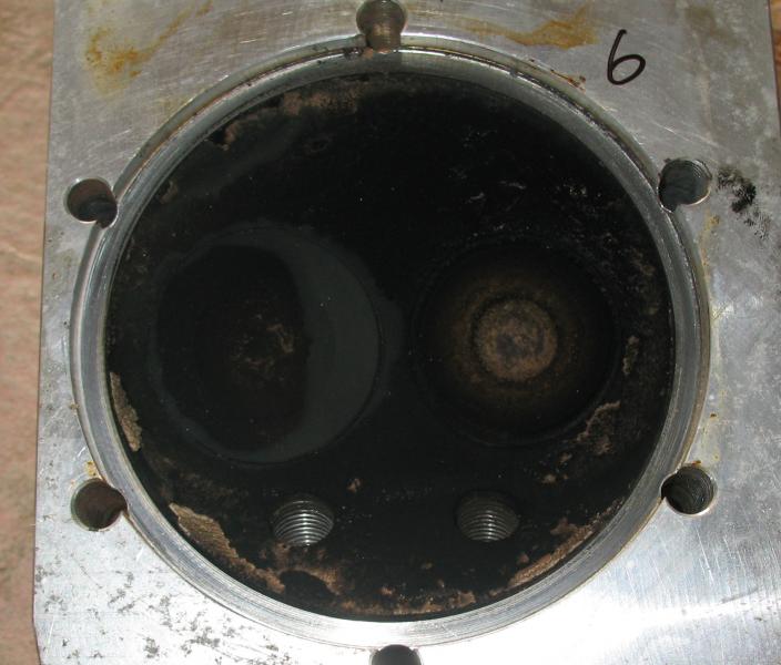

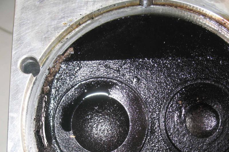

As promised, some more images as things slowly progress.
I guess the question comes down to this - with the cylinder head crush at the level in the photos below, what would be the potential issues with honing the cylinders, replacing rings and valves, and putting the thing back together?

Cylinder 6 plug side
[ATTACH]13233.vB[/ATTACH]
Cylinder 6 exhaust side
Sorry Greg but I can't tell from the photos, the heads look like they were made that way to me. The crush I have seen was on an older 4 cylinder engine and it took the form of distortion in the zone of the head-bolts near the exhaust valve. Plastic deformation had taken place and the head material near these bolts had compressed a mm or so. This engine had often run at 350F on climb, which was less than the red-line of 390 in those days. There have been real changes since then in the red-zone temps and the head design, so I would have said the problem is mainly in the past. But your carbon buildup sure does seem like heating, so I'm puzzled.

Hi Greg, I cant see anything bad in the photos in fact the heads look much cleaner than mine @ 300 hrs
I think the machined ridges are still showing in your head - cylinder contact area these will become flat in the area around the bolts anytime cylinders are checked above 20 ft-lbs too often.
When you put it back be sure to have the clearance honed out to the latest specs, and the cylinder base nuts bevelled per AVDAL SR050 if not already. The workshop in UK also recommends heating the cylinders around the bases before tightening them down to make sure they don't set oval too. Wish I'd known about that before putting mine back. But I did get + 200 rpm extra in the climb from the fixed base nuts, so it has been worthwhile.
