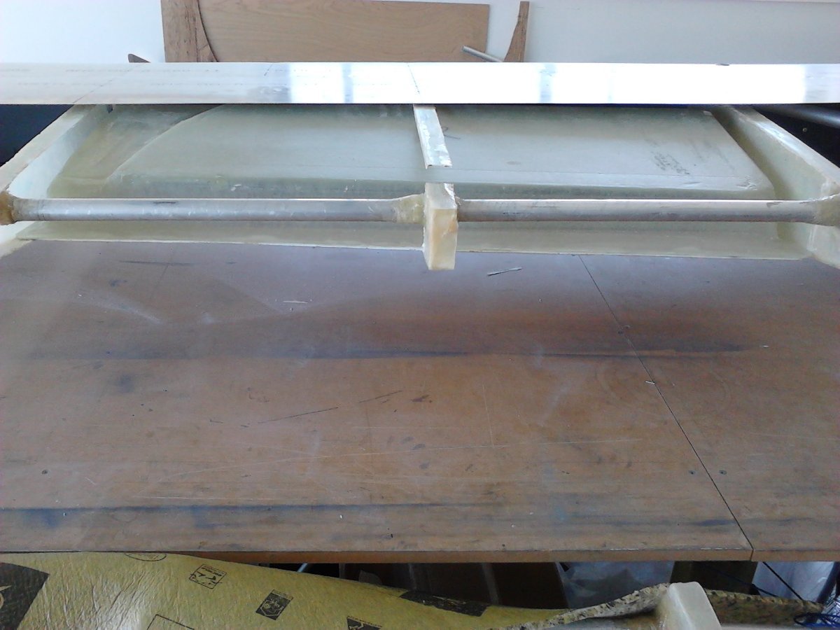

Nick99 Posted May 9, 2023 Share Posted May 9, 2023 On 21/03/2012 at 9:43 PM, Guernsey said: We have wing tanks but only use them when necessary however we have the advantage of all three of us pilots being 70 kilos each and most of the time it's only two of us using the aircraft as opposed to other passengers.. Alan. I am looking at installing wing tanks in mine, do you have any photos before the wing skins went on? Link to comment Share on other sites More sharing options...

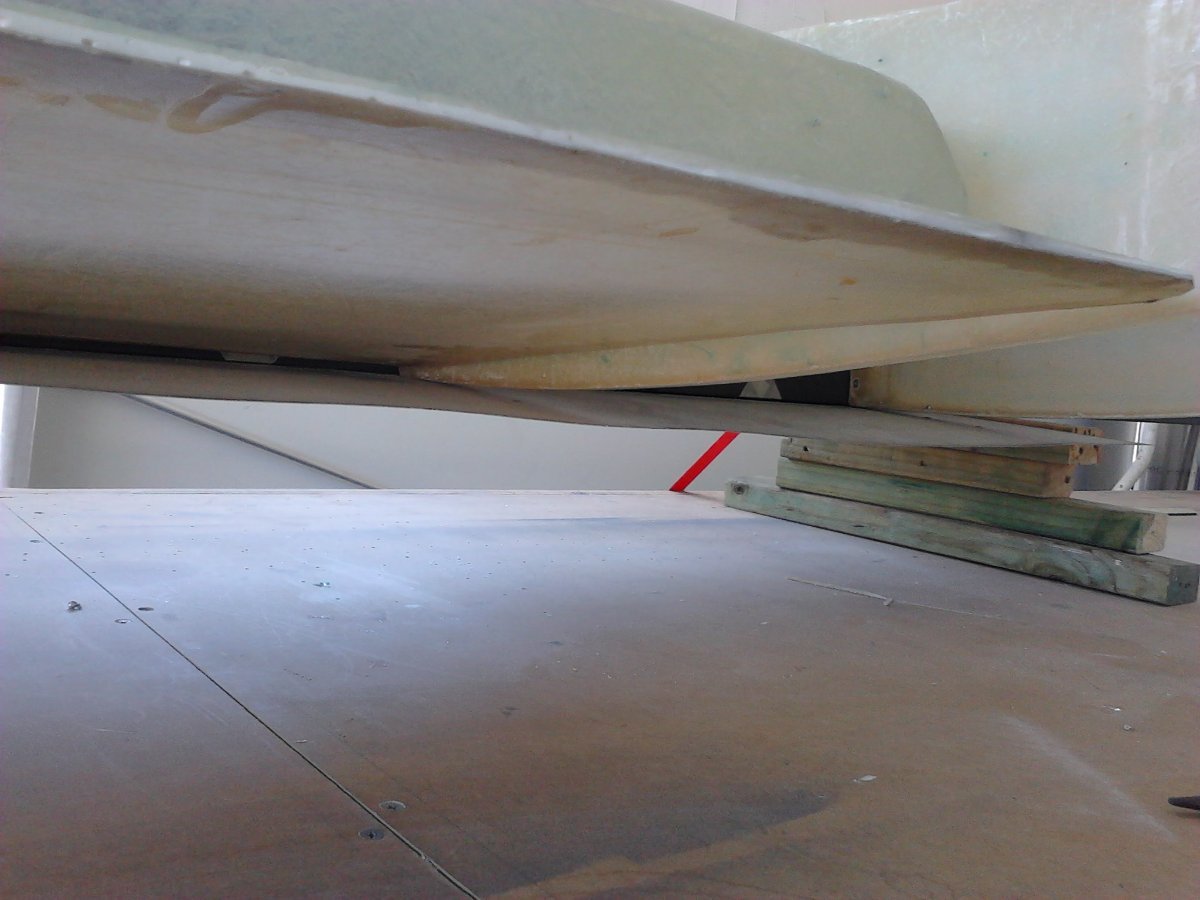

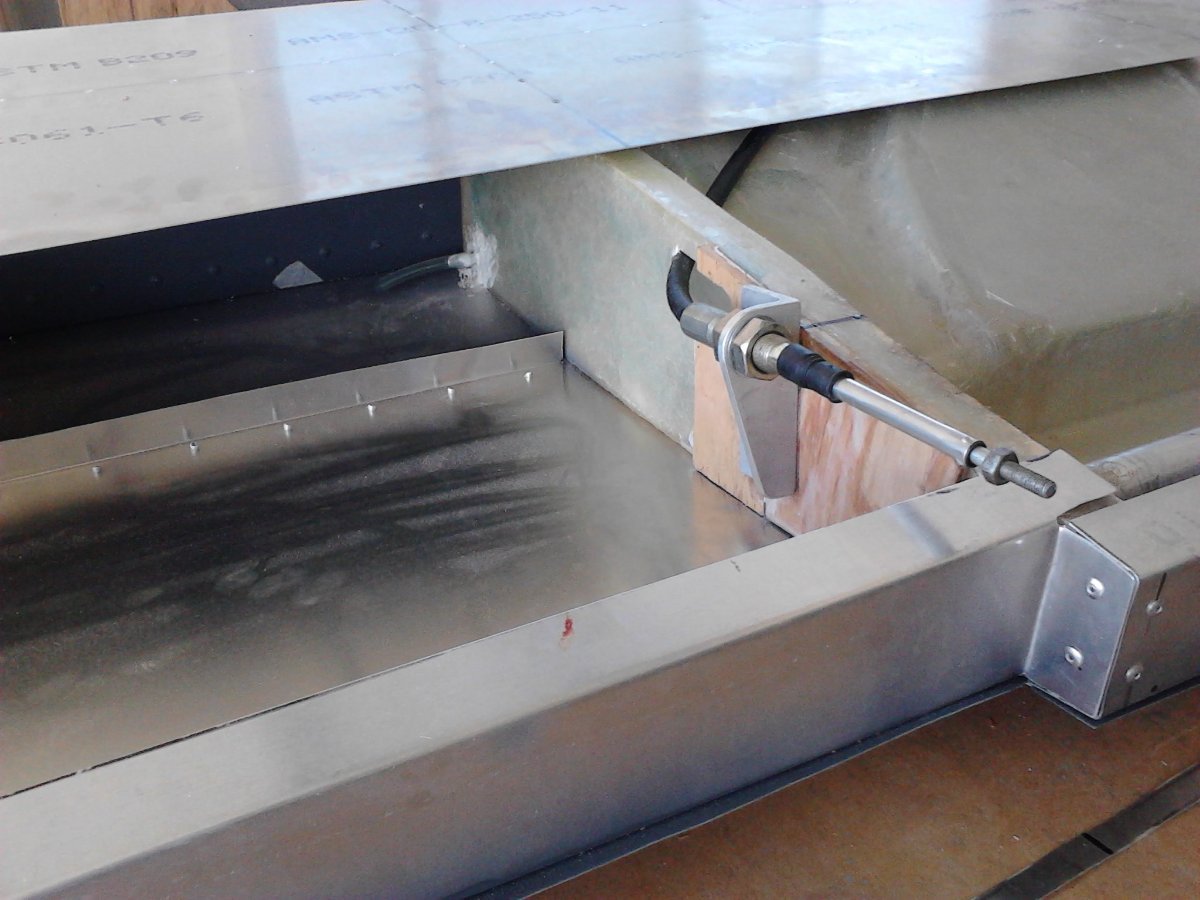

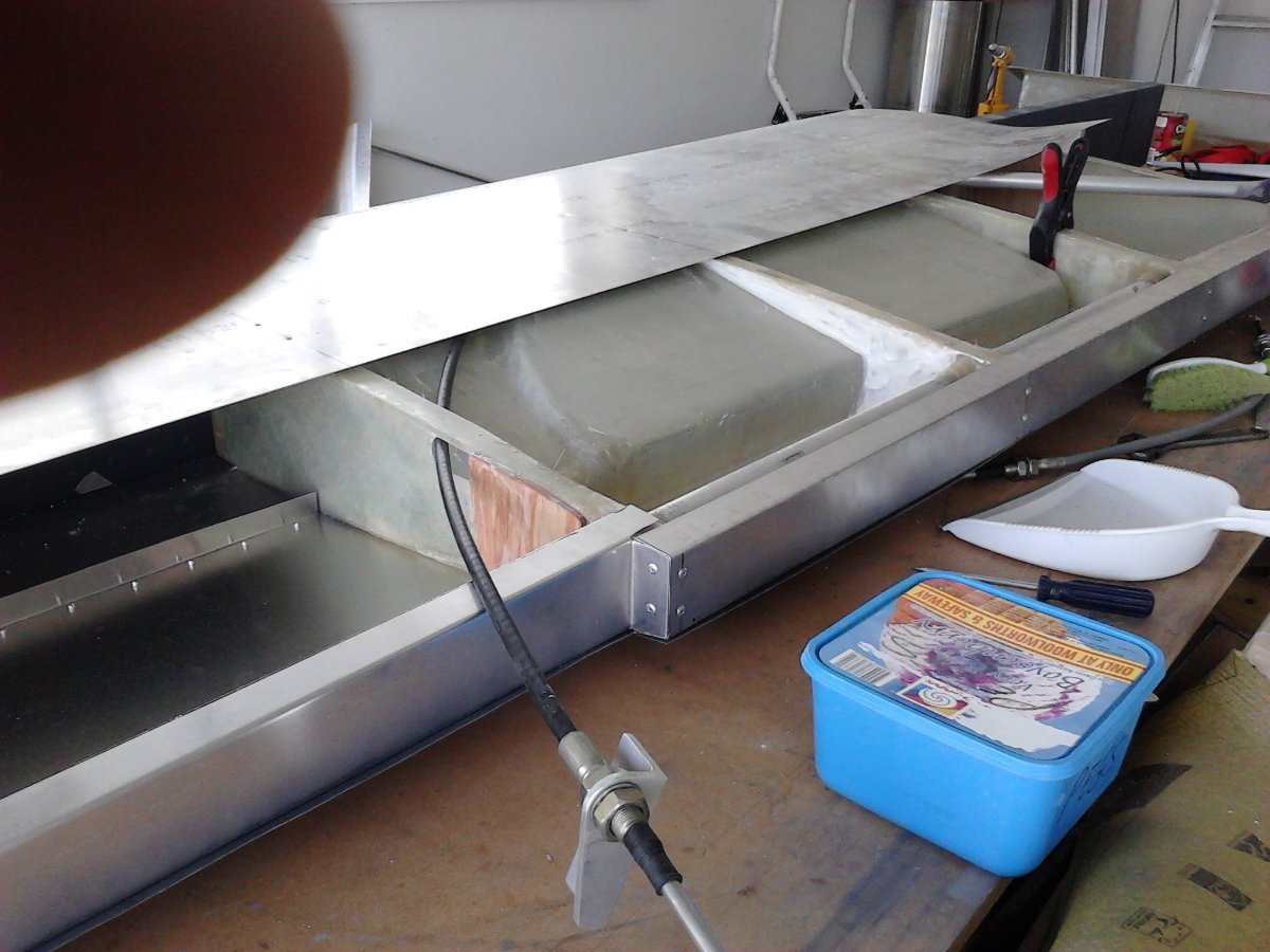

kgwilson Posted May 9, 2023 Share Posted May 9, 2023 I put Wing tanks in my S100. They are 35 litres per wing with 100 litres in the main so provides excellent range with the 3300a engine. Photo 1 is looking at the bottom of the tank after initial installation. Photo 2 shows the flap cable routing around tank bottom. Photo 3 shows flap acble installation complete & photo 4 is the top of the tank Link to comment Share on other sites More sharing options...
