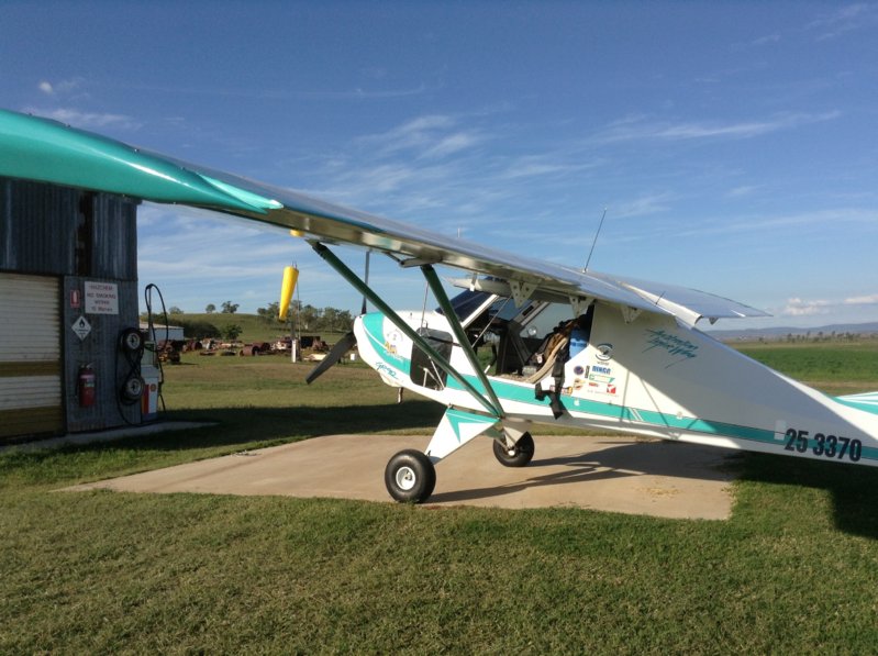

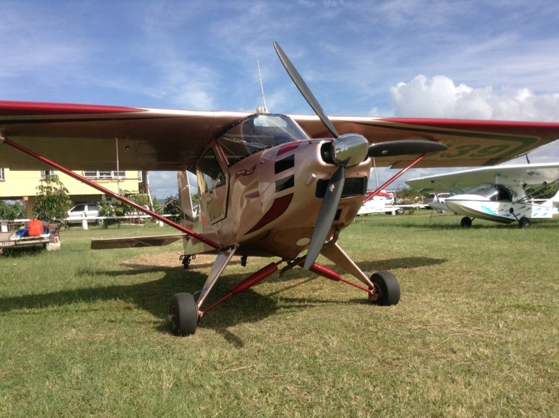

Even with the smaller wing the GA still lifts and climbs well and is a great little aircraft for someone who doesn't mind doing a little more work come landing time, and wants to cruise a good bit faster than the big wing GR. Howie only built around 14 GAs, and the owners who fly them usually are very happy, and generally hang onto them long term. That being said however I currently know of two GAs up in this area that may be for sale at the moment. On a standard factory built GA and the other a kit built one without the flaps but with Xtra long- range tanks in the wings. Below are two photos of GAs in this area...vs the third which is my GR with the large standard wing and the optional GA style flaps..............................Maj.......

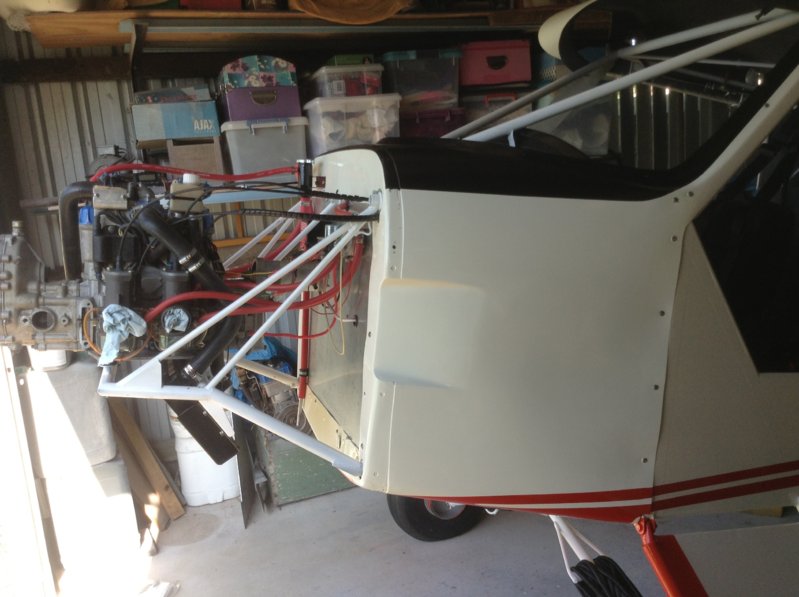

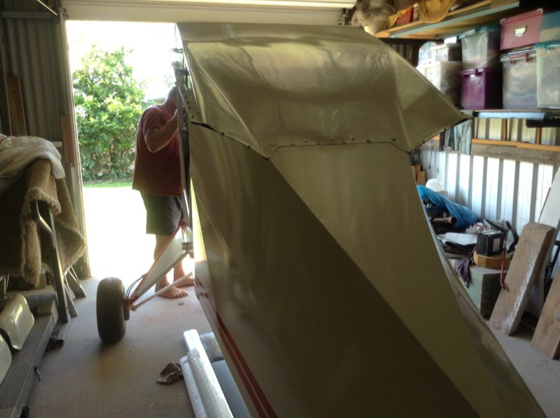

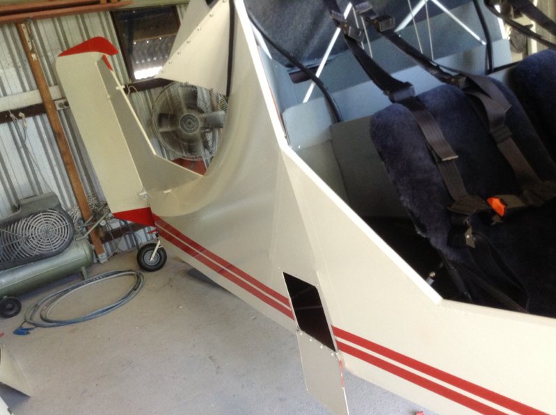

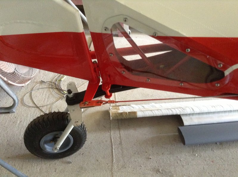

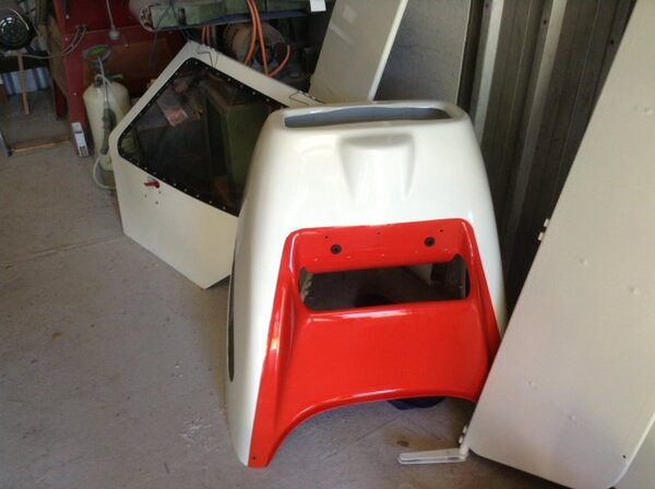

I have a friend here rebuilding one currently that he picked up out west with 3000+ hours on it with trailer for about $10k...it is turning out to be in good shape and is going to be ery nice when finished. This example was as bad as you could imagine after 20 odd years of hard station use, but is coming back fine. Obviously if one needs a lot of work that should be reflected in a low asking price. will attach some photos of that rebuild as taken last week....Cheers Ross
Thanks Maj - all very interesting to see, as they are proving to be an interesting prospect.
That 582 looks tiny in that front end, but I like the inspection panel etc near the tailwheel. Very clever! What sort of money is involved in re-covering wings etc? Is Howie the cheapest option for that sort of stuff?

The gentleman restoring this one is retired and a true craftsman. He has also built several aircraft including original designs throughout his career, and as you can see the results are always impressive. I Look foward to being the one who will probabily get to run the 582 in for him, and possible test fly the aircraft when completed.
Like Dougs 032 and David Sees early Lightwing recently featured in the magazine, the early ones are all quite lightweight and just a pleasure to fly really. They go quite well with the 582 up front, even two up, and Doug recently flew 032 down to Old Station for the second year in a row.
