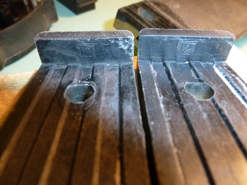

terryc Posted April 10, 2012 Share Posted April 10, 2012 G'day Terry,Well the numbers on the pitch blocks are certainly where the pitch numbers are supposed to be found on the Brolga props - look like they have been either cast in or punched in with a letter punch set. I'll check it under a magnifying glass when I get home. So if the pitch is 12 degrees the engine should be achieving 6800rpm no problems, yes? Wonder if I need to check the tacho now.... 2nd guessing again, I seem to be good at that!! I think I'll get hold of a tacho that reads prop revolutions and see what that shows. Let me see... engine revs/reduction box gearing= prop revs. 6800/2.58= 2635.66 revs at the prop. Is this correct? Our airfield is at 1330' asl according to my Recreational Flying 5" GPS. Pud Hi Pud, The 17 degree blocks offered by riley will make the problem worse by loading your engine even more. I have used them on mine but found them no good with two up so took them off straight away. The 16 degree blocks I used mostly [150 hours ] and what was on it when it came from the factory gave me 6200 revs exactly at full power on climb out the same as yours. When my engine was rebuilt after my accident the l2 that did it insisted that I change the 16s to 15s because the power lost in that extra 600 revs was considerable and needed with a t500. He was dead on the new climb out revs were exactly 6800 revs and a better climb rate. I've used 17 16 and 15 degree blocks and there's no doubt the 15s are the correct ones for the 582 on a t500 I remember tony hayes writing an article on this, maybe on this forum. I'll see if I can find it for you. Terry Link to comment Share on other sites More sharing options...

pudestcon Posted April 10, 2012 Author Share Posted April 10, 2012 G'day Terry,Well the numbers on the pitch blocks are certainly where the pitch numbers are supposed to be found on the Brolga props - look like they have been either cast in or punched in with a letter punch set. I'll check it under a magnifying glass when I get home. So if the pitch is 12 degrees the engine should be achieving 6800rpm no problems, yes? Wonder if I need to check the tacho now.... 2nd guessing again, I seem to be good at that!! I think I'll get hold of a tacho that reads prop revolutions and see what that shows. Let me see... engine revs/reduction box gearing= prop revs. 6800/2.58= 2635.66 revs at the prop. Is this correct? Our airfield is at 1330' asl according to my Recreational Flying 5" GPS. Pud Well here's a photo of the pitch blocks showing a 'cast in' number where the Ultra-Props documentation says to look for the pitch degree identification. It looks like 12 degree pitch blocks to me. Now with 2 up and a full load of fuel I reckon my Thruster climbs out very well - nothing spectacular mind, but not bad all the same. The tacho reads 6100 - 6200 max revs, and does not sound like it is screaming it's t#ts off. A mate of mine has a digital rev counter gauge that reads a reflective tape stuck on a prop blade. I'm going to see if I can borrow it this weekend to check the revs. Just a thought - is there another way to check the degrees on a pitch block - is it simply a matter of reading the sloping face against the square edge to give you the angle? Pud Link to comment Share on other sites More sharing options...

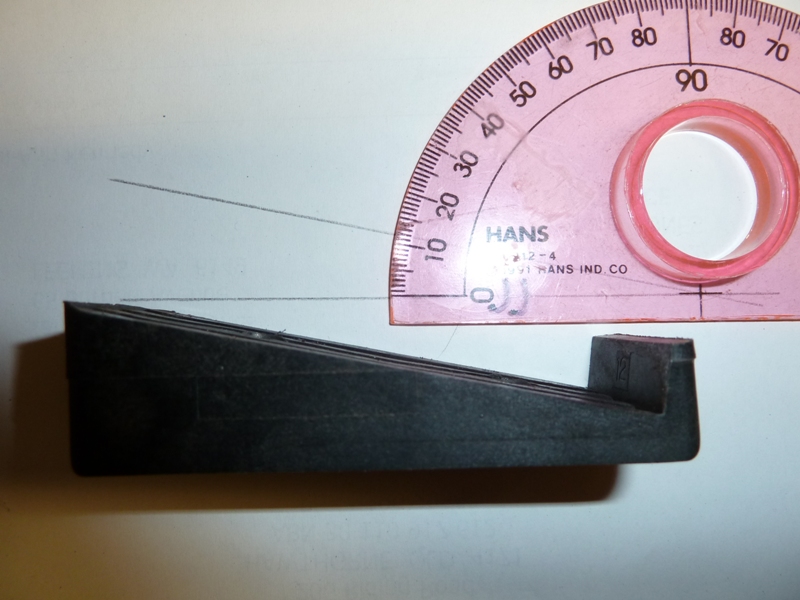

pudestcon Posted April 10, 2012 Author Share Posted April 10, 2012 Just a thought - is there another way to check the degrees on a pitch block - is it simply a matter of reading the sloping face against the square edge to give you the angle? If I've done this correctly then the pitch blocks are definitely 12* Do I need 11* pitch blocks or should I look for the problem elsewhere? Pud Link to comment Share on other sites More sharing options...
Tex Posted April 10, 2012 Share Posted April 10, 2012 You can still get Tiny Tachs. Just thinking... high temp, low RPM on fine pitch ... if your tacho is cactus and is reading low (like 600rpm) it might explain all of them? Link to comment Share on other sites More sharing options...

terryc Posted April 11, 2012 Share Posted April 11, 2012 Well here's a photo of the pitch blocks showing a 'cast in' number where the Ultra-Props documentation says to look for the pitch degree identification. It looks like 12 degree pitch blocks to me.[ATTACH=full]17098[/ATTACH] Now with 2 up and a full load of fuel I reckon my Thruster climbs out very well - nothing spectacular mind, but not bad all the same. The tacho reads 6100 - 6200 max revs, and does not sound like it is screaming it's t#ts off. A mate of mine has a digital rev counter gauge that reads a reflective tape stuck on a prop blade. I'm going to see if I can borrow it this weekend to check the revs. Just a thought - is there another way to check the degrees on a pitch block - is it simply a matter of reading the sloping face against the square edge to give you the angle? Pud Hi Pud, yes their 12 degrees all right. 1/So we know the pitch for certain 2/ We know the 582 for certain 3/ Gear box. Do we know for certain the gearbox, I don't think we do. Maybe you could double check this Pud. Gees this is fun :roflmao:Sorry Pud I know it's not for you Link to comment Share on other sites More sharing options...
