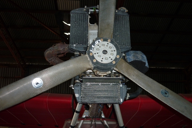

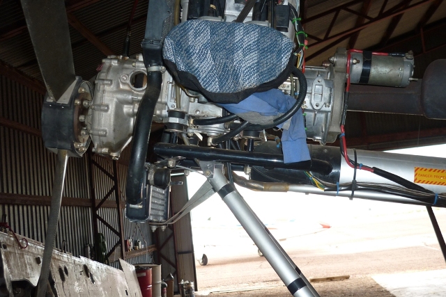

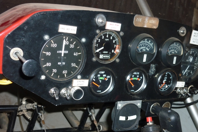

pudestcon Posted April 22, 2012 Author Share Posted April 22, 2012 G,day Pud.Here are a couple of photos of my radiator setup, the push pull handle on the left of the dash is for the radiator flap. With your tracking problem, I was told in my early days when flying a skycraft scout that if your prop was out of track you could put a shim of some sort behind the blade that was back, seeing as you only have one blade out of track you should be able to put a shim behind it to push it forward. My engine only rev,s to 6000 WOT has done ever since ive owned it, I thought that was the norm until I was told I should be getting about 6500 to 6700. I have 15% pitch block and my carbies are good, Ive never worried about it, it gets of reasonabley quick, climbs out ok, cruises at 50 kts indicated at 5400. SAJ Can't see any photos SAJ:private eyes:. Interesting about the shims - what shim material would you use? Anyone else have a view on using a shim to change a propeller blade tracking? Initially I wasn't worried about the engine revs either, but now I know about it and the water temp is hot I thought I'd find the cause as both issues could be related. Just a thought, but it may be that your setup with the extra radiator capacity is masking the real reason for overheating. In my situation with the blue head engine, where it needs the extra capacity (around 163.5 cm2 of extra radiator surface area over the grey head engine) your third radiator idea should solve the problem, giving an excess of 76.3 cm2 surface area capacity. Food for thought.... Pud Link to comment Share on other sites More sharing options...
pudestcon Posted April 22, 2012 Author Share Posted April 22, 2012 Pud I hit post reply befor I had put the photos in, having down trouble down sizing photos, when I work it out I will send them to you.SAJ It's easy if you use Microsoft Picture Manager (MPM) SAJ. When you have a photo on screen in MPM click on "Edit Pictures..." in the menu bar across the top of the screen, a box will appear down right side that gives you the option to resize the photo. You need the 640x480 size to have it accepted for upload to the site here. At least, that's how I do it:wink: Pud Link to comment Share on other sites More sharing options...

SAJ Posted April 23, 2012 Share Posted April 23, 2012 Sorry pud - have resized the pictures - hopefully they will load now SAJ Link to comment Share on other sites More sharing options...
propfarmer Posted April 23, 2012 Share Posted April 23, 2012 Hi Pud, have been watching this thread with interest and after seeing the above photos and reading that the alignment of one blade is different to the others, have had a thought... Is it possible that the 12 deg blocks can be put on incorrectly and are oriented the wrong way giving a false pitch? eg. the block designed to be infront of the blade is infact behind it and vice versa. Could this be the reason for one blade being out of alignment? One is correct and two are wrong or two correct, one wrong? ps. have no experience with maintenance on this type of engine or prop so what i am questioning may not be possible? Good luck. Link to comment Share on other sites More sharing options...
pudestcon Posted April 23, 2012 Author Share Posted April 23, 2012 There WILL be an answer. Do the radiators anyhow. Accept nothing that hasn't been proven in a situation like this. I feel a bit bad because I encouraged Pud to go via the new engine route. It's usually just a matter of bolting it in and break it in and go. Nev Hehehe, I can't believe you are feeling "a bit bad" Nev... You should be feeling a bloody "lot bad" Seriously though, as Don has said, I definitely have no regrets about getting the new engine, and fully expect to work these issues out in due course, and have many many hours of flying fun. So thanks for your input Nev, it has been very valuable, and thanks for your concern as well. Pud Link to comment Share on other sites More sharing options...
pudestcon Posted April 23, 2012 Author Share Posted April 23, 2012 Sorry pud - have resized the pictures - hopefully they will load nowSAJ Thanks SAJ. Good to see you worked out how to load photos - it's not too hard once you get the gist of it. Your solution to the overheating problem is certainly novel, and obviously working. I like the idea of shutting off the lower radiator when its not needed - I hope it is attached well!! Cheers, Pud Link to comment Share on other sites More sharing options...
pudestcon Posted April 23, 2012 Author Share Posted April 23, 2012 Hi Pud,have been watching this thread with interest and after seeing the above photos and reading that the alignment of one blade is different to the others, have had a thought... Is it possible that the 12 deg blocks can be put on incorrectly and are oriented the wrong way giving a false pitch? eg. the block designed to be infront of the blade is infact behind it and vice versa. Could this be the reason for one blade being out of alignment? One is correct and two are wrong or two correct, one wrong? ps. have no experience with maintenance on this type of engine or prop so what i am questioning may not be possible? Good luck. G'day propfarmer, the pitch blocks are fully interchangeable front and back. If you check out photos number 1 and 4 in SAJ's post #88 you will see what I mean. SAJ's propeller set up is identical to mine. The pitch blocks in use are the ones featured here http://www.competitionaircraft.com/ultralight-aircraft-parts.html Some information on prop combinations for the 582 can be found on this page http://www.competitionaircraft.com/Brolga.htm Pud Link to comment Share on other sites More sharing options...
