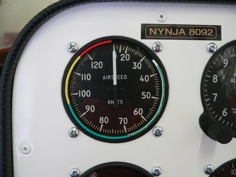

Trackley:
As an alternative, you can do what I did when I built my Nynja.
I got some different coloured "hookup" wire and used a piece of stiff wire with different colored insulation and glued it around the ring of my ASI
  • Like 7
  • Agree 2
  • Helpful 1
  • Winner 1
  • Caution 1
Trackley:As an alternative, you can do what I did when I built my Nynja.
.[ATTACH=full]45763[/ATTACH]
I like that. Good idea
