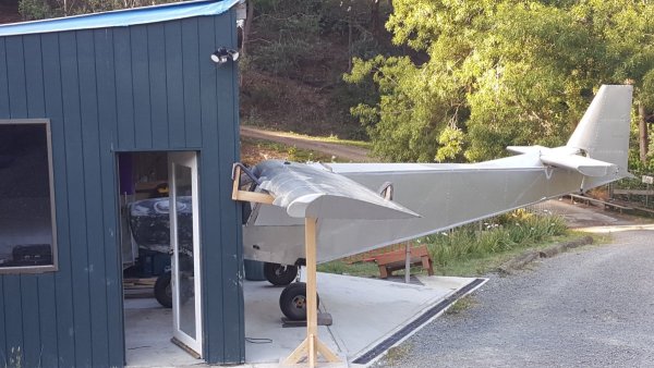

Marty_d Posted April 15 Author Posted April 15 Fantastic, thanks guys. How about general logistics about starting... special equipment, ground etc? What I mean is, my plane is currently in a farm shed. The paddock in front of the shed slopes down slightly - there's no flat land. Currently hosts a flock of duck. My general plan is to roll the plane out til it's clear of the shed, shut the doors to avoid blowing everything around behind the plane, tie the main gear to trees/fenceposts, chock as well, put the wings back on and prep for starting. Are there other considerations? Is it best to peg down carpet under the plane or is that more of a risk than it's worth? Guessing it's a good idea to rake away any gravel / sheep shit etc in front of and around the plane first also? Any hints and tips would be appreciated, thank you.

Blueadventures Posted April 15 Posted April 15 From your image face plane towards the big door. Have prop line just forward of the drain grate line. Chock the wheels good, maybe even level up the lower main wheel. Add a double securing with rope or a strap to a secure point behind the plane so it does not travel forward when engine running. This way you won't pick up any stones or rocks. 3

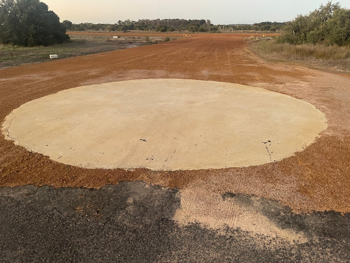

Moneybox Posted April 15 Posted April 15 (edited) I was considering laying a bit of concrete or laying a area of artificial grass that is pegged down with sand laid in it. Here at Myrup, Esperance they have a circular patch of concrete, about 30m from the gravel airstrip, that looks like the top of a tank of some kind. It's about 3m across and does the job nicely. Edited April 15 by Moneybox 1
Marty_d Posted April 15 Author Posted April 15 5 hours ago, Blueadventures said: From your image face plane towards the big door. Have prop line just forward of the drain grate line. Chock the wheels good, maybe even level up the lower main wheel. Add a double securing with rope or a strap to a secure point behind the plane so it does not travel forward when engine running. This way you won't pick up any stones or rocks. Oh, thanks, but she's not in that shed. Up the road in a bigger one. 1 1
Moneybox Posted Wednesday at 01:10 AM Posted Wednesday at 01:10 AM I realise now these are poured just for the purpose. Each taxi way has a runup pad like this. 2
