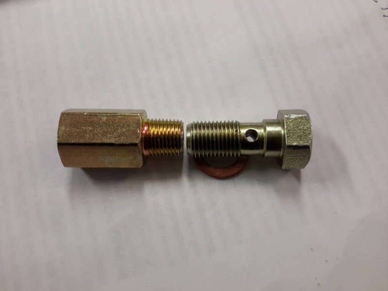

Downunder Posted November 10, 2017 Share Posted November 10, 2017 Yes, it should be 1/8 npt. "1/8" is not a representative measurement of the actual thread. This is a pic of a 10x1 banjo bolt and 1/8 npt male end. 1 Link to comment Share on other sites More sharing options...
skippydiesel Posted November 10, 2017 Author Share Posted November 10, 2017 Thanks Downunder - could have sworn mine had parallel, not tapered thread, but then again I am now (very) unsure, so I will have to get it out of the engine and carefully measure. Link to comment Share on other sites More sharing options...
Downunder Posted November 10, 2017 Share Posted November 10, 2017 Yes, it should be tapered. Just to confuse it more, a straight npt is called a nps.... Then bsp is only 1 tpi from npt, 28 vs 27...lol... So there is probably several diffrrent sensor threads that could forced into the 1/8x27 npt Rotax oil housing thread .... Link to comment Share on other sites More sharing options...

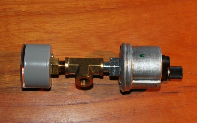

onetrack Posted November 10, 2017 Share Posted November 10, 2017 Here is a VDO 360.081/032/008 sender, which has a 1/8" NPT thread and is apparently the one for the Rotax. Rotax 912 914 Engine Oil Pressure Sender Sensor Ultralight Aircraft Microlight | eBay Skippy, do you have a photo of your sender? I possess a collection of new (mostly VDO) senders in my workshop, that are not in boxes, but which have been vacuum-sealed in plastic. I have no idea what is in the sender collection (which I purchased when a tractor/engine reseller folded), but I could have a look to see if there's anything suitable in there. I think I might also have an older VDO catalogue which could provide more detail on the different varieties and types available. Link to comment Share on other sites More sharing options...
Downunder Posted November 10, 2017 Share Posted November 10, 2017 The problem it seems is that his gauge and sender are not a normal Rotax setup. Most gauges are configured for a "normal" Rotax sender electrical out put, whether vdo, honeywell or keller. His ohm range seems to be working in reverse of standard. 1 1 Link to comment Share on other sites More sharing options...

cscotthendry Posted November 10, 2017 Share Posted November 10, 2017 Yes, it should be 1/8 npt. "1/8" is not a representative measurement of the actual thread.This is a pic of a 10x1 banjo bolt and 1/8 npt male end. [ATTACH=full]52632[/ATTACH] That's what I *love* about plumbing. Like Heinz baked beans ... 57 varieties, and nothing fits anything else. 1 Link to comment Share on other sites More sharing options...

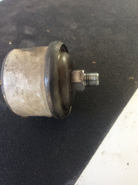

skippydiesel Posted November 11, 2017 Author Share Posted November 11, 2017 My width measurements are pretty well spot on. The thread pitch was measured using a metric pitch measuring tool so is also spot on (there may of course be an imperial equivalent - could it be 28GA ??.) So the sender fitting is definitely not a 10 x 1 To answer Downunder - the full 9mm length of the threaded section screws to the shoulder. From Scotts information I am wondering if the 1/8 NPT might just fit - it will depend on the thread pitch. If the 0.9 mm thread is a close match with 28GA it may be possible to fit the 1/8 NPT Link to comment Share on other sites More sharing options...
skippydiesel Posted November 11, 2017 Author Share Posted November 11, 2017 Photos of the offending beast Link to comment Share on other sites More sharing options...
cscotthendry Posted November 11, 2017 Share Posted November 11, 2017 It would be easy and cheap enough to test the 1/8NPT. Just buy a general brass 1/8NPT fitting from an auto parts store and see how it fits. 1 Link to comment Share on other sites More sharing options...
Blueadventures Posted November 11, 2017 Share Posted November 11, 2017 Okay just come from aircraft have removed and remeasured sender: Length of threaded section 9mm Width (over thread) at base 9.56mm - Width at tip 9.62 mm Thread pitch 0.9 mm SOOOO its parallel & has a metric thread. To confuse matters: There is evidence of aluminium thread embedded in the sender threads. To me this is suggestive of incorrect fit. Obviously I have been dwelling on this matter for some time - the comment by my VDO technical advisor that a VDO sender would drive my Speco gauge in reverse suggests to me that the sender MUST be compatible with the gauge - SOOOO the sender must be a Speco. The system has operated for 800 hrs/18 years without leaks but it does seem that the original builder must have either "forced" the sender to fit OR tapped the oil pump housing. Current Speco senders are all 1/8NPT Any chance you could give me actual measurements of the 1/8 NPT so that I might be able to guess at a likely fit or not. Have you thought about chasing up a brass adaptor so you can thread the 'Speco' sender into it and then screw into the rotax. i'm sure ENZED may have one or a fitter could make one up. Another way may be to buy a metric brass plug of the thread size that screws into the rotax and drill and tap it 1/8 NPT for the 'Speco' sender. I'm 100% sure that will be a suitable fix (Just make sure that there is plenty of metal left around the meeting of the threads area as if its thin vibration and time will result in a failure. Cheers Mike Link to comment Share on other sites More sharing options...
