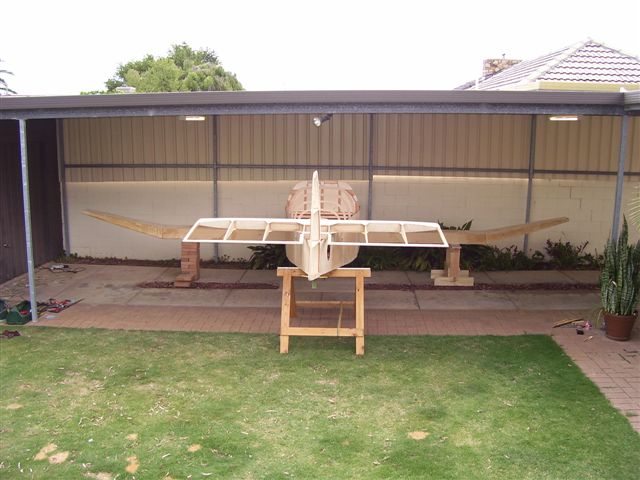

Thankyou for the pic Arthur. How long has it taken you to get to that stage and what are you powering it with? Did you get the plans from the chap in Australia who redrew them?
Hi Scott,
Yes,
I purchased the plans from Frank Rogers in Sydney...They are redrawn and translated from french.
It is well known internationally that these are the best available Jodel plans. The D18 plans are about $250. (about 30 pages-poster size with written instruction book).Frank also sells most of the Jodel aircraft. D9, D11, D150 etc.I have been told the french plans are nothigh quality an unless you read french.........however the 'drafting' is similar.The plans are in metric using AN hardware.
I have probably done about 500 building hours on my Jodel. Which includes the following(not in photo):
The ailerons & flaps are complete. I have made the 2 fuel tanks ( total100 litre capacity) and fitted to fuselage.
Rudder pedals are complete and fitted to fuselage.
Control sticks (2) are completed.
Flap levermechanism is completed
Anti servo tab for stabiliser is fitted and almost complete.
The plans state it is a 1500 hour build....will wait and see...???
I have purchased the canopy from New Zealand via a fellow jodel builder.(sliding bubble)
The wing spar was easy to build and was signed off by a LAME before closing in.
The hardest thing to build so far were the 2 wing flaps...! and not even a complicated structure.
I hope to power my Jodel with a 2200 Jabiru engine or a Rotax 912.
(The airframe is designed for a 60 HPVW)
I have done 10 hours in a D18 with a 912 at 85 knots we were using 12 to 13litres an hour. Flown at 75 knots...11 litres an hour.
At 95 knots 15 litres an hour.
Climb at MTOW is nearly 1000 foot /min. Stall is about 36 knots.Aircraft empty weight is 258kg. Prop is a composite 70inch 3 blade powerfin. Take off with 12 degrees of flapis about 80 to 100 meter ground roll in still air..! (2 up).This Jodel flew from near Albany WA to Lethbridge in Victoria and return without a problem, except weather.
hope this answers your questions.
Your 1/4 scale biplane would make a great ultralight....! a 2 seater as well.
regards Arthur.
