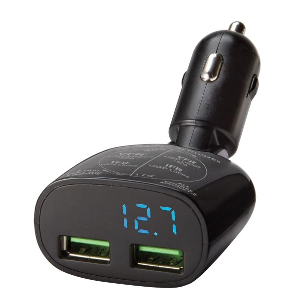

Blueadventures Posted July 27, 2022 Share Posted July 27, 2022 Looking at changing out the JayCar dual usb 5v outlet in my panel as get some noise at times that stops when I pull out the USB then will come back later when plugged in. Would like to fit a unit that fits the usual car type cigarette outlet size. Has anyone purchased and used with success a unit. Thanks in advance. Link to comment Share on other sites More sharing options...
Garfly Posted July 28, 2022 Share Posted July 28, 2022 (edited) I wonder how this Flight Gear one would work. Of course, there's also the Garmin GSB-15 but that's a proper panel mount job and well over 10 times the price. Either solution offers two 3A outputs which, they say, keeps two iPads going full bright. Whether standard Rotax electrics would keep up with that much additional current draw I'm not sure. https://www.sportys.com/catalogsearch/result/?q=garmin gsb 15 usb https://www.sportys.com/flight-gear-dual-usb-quick-charger.html https://ipadpilotnews.com/2020/05/new-dual-usb-charger-is-perfect-for-the-cockpit/ https://www.youtube.com/watch?v=GXKb_7PfW8c Edited July 28, 2022 by Garfly Link to comment Share on other sites More sharing options...

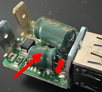

RFguy Posted July 29, 2022 Share Posted July 29, 2022 (edited) most of the problems with noise relate to the power supply circuitry inside these not having small suitable input capacitors. reality - cheap design and mfr. They are for most people too hard to modify so its a matter of finding one that is radio quiet. if you can pull it apart, solder in disc ceramic capacitors with 1/4" leads across the 0 and 5V of the USB sockets, (which is the OUTER pair of contacts) and the 12V input on the PCB itself. https://www.jaycar.com.au/10nf-50vdc-ceramic-capacitors-pack-of-2/p/RC5348?pos=2&queryId=e517493d3ef57325d5af7d045f0b4676&sort=relevance There is more you can do with ferrite chokes, but the above is usually WHY there is a problem. For flashtube strobes, the ferrite chokes are required on the feeds from the generator box. Edited July 29, 2022 by RFguy 1 1 Link to comment Share on other sites More sharing options...
Blueadventures Posted July 29, 2022 Share Posted July 29, 2022 Thanks RF; will do that and check results. Thanks also Gary and others for info. I have sent an email to Steinair about their $55 USD item as it is a twin 2.4amp outlets (4.8 amps must be better than 3.1 a [1 = 2.4] and was intending to email Mendellsens as unsure of the specs of their $55AUD item (they mention modified car unit and it looks like the Jay Car unit and it may contain RF's mod. For additional info; working to a budget when my $180 12 month plan sim in my ipad mini ran out early (not sure what I was doing wrong usage wise) and with purchasing an iphone 13 and data plan I now share internet access via personal hotspot which requires wifi on so this may add to the situation. 1 Link to comment Share on other sites More sharing options...

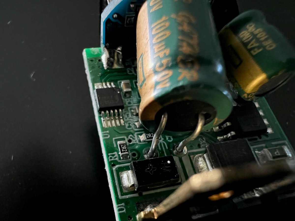

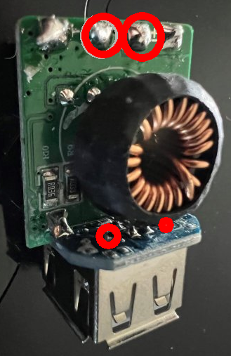

Blueadventures Posted July 29, 2022 Share Posted July 29, 2022 2 hours ago, RFguy said: most of the problems with noise relate to the power supply circuitry inside these not having small suitable input capacitors. reality - cheap design and mfr. They are for most people too hard to modify so its a matter of finding one that is radio quiet. if you can pull it apart, solder in disc ceramic capacitors with 1/4" leads across the 0 and 5V of the USB sockets, (which is the OUTER pair of contacts) and the 12V input on the PCB itself. https://www.jaycar.com.au/10nf-50vdc-ceramic-capacitors-pack-of-2/p/RC5348?pos=2&queryId=e517493d3ef57325d5af7d045f0b4676&sort=relevance There is more you can do with ferrite chokes, but the above is usually WHY there is a problem. For flashtube strobes, the ferrite chokes are required on the feeds from the generator box. It will pull apart; when you have a chance, no urgency could you advise where to solder the disc ceramic cap; and if I use 2 one on each usb outlet. Thanks Link to comment Share on other sites More sharing options...
RFguy Posted July 29, 2022 Share Posted July 29, 2022 so on the outer two pins of the USB connector, approx 1/4" leads no longer that USB has a subboard- you'll need to get the cap wires across the USB pins . and the input side- well that's easy, across the pair of spades if you want to go to town a 10nF and a 100nF in parallel even better. https://www.jaycar.com.au/10nf-50vdc-ceramic-capacitors-pack-of-2/p/RC5348?pos=2&queryId=e517493d3ef57325d5af7d045f0b4676&sort=relevance https://www.jaycar.com.au/100nf-50vdc-ceramic-capacitors-pack-of-2/p/RC5360?pos=3&queryId=644fcba3c794f9c5819969aec721cd51&sort=relevance pics : The input side caps go on those red circles. you will see on the lower side the small dots on the USB connector PCB. there should be a better spot- that is to say the 5V will go up to the PCB, and it might be easier to put the caps on the main PCB, so (see the 2nd PCB) pic below those two blocb dots on the big cylindrical capacitor with the arrow, that is where you want to get the 5V output caps.... That part is leaded, so you'll be able to mount the caps on back OR front, just that on the back, the toroidal inductor might get in the way. I think the leads are right under the middle of the toroids hole ! you can move that toroidal inductor while you are soldering it in- dont worry about proximity , the inductor wont care about having a cap against it, Link to comment Share on other sites More sharing options...
Blueadventures Posted July 29, 2022 Share Posted July 29, 2022 9 minutes ago, RFguy said: so on the outer two pins of the USB connector, approx 1/4" leads no longer that USB has a subboard- you'll need to get the cap wires across the USB pins . and the input side- well that's easy, across the pair of spades if you want to go to town a 10nF and a 100nF in parallel even better. https://www.jaycar.com.au/10nf-50vdc-ceramic-capacitors-pack-of-2/p/RC5348?pos=2&queryId=e517493d3ef57325d5af7d045f0b4676&sort=relevance https://www.jaycar.com.au/100nf-50vdc-ceramic-capacitors-pack-of-2/p/RC5360?pos=3&queryId=644fcba3c794f9c5819969aec721cd51&sort=relevance pics : The input side caps go on those red circles. you will see on the lower side the small dots on the USB connector PCB. there should be a better spot- that is to say the 5V will go up to the PCB, and it might be easier to put the caps on the main PCB, so (see the 2nd PCB) pic below those two blocb dots on the big cylindrical capacitor with the arrow, that is where you want to get the 5V output caps.... That part is leaded, so you'll be able to mount the caps on back OR front, just that on the back, the toroidal inductor might get in the way. I think the leads are right under the middle of the toroids hole ! you can move that toroidal inductor while you are soldering it in- dont worry about proximity , the inductor wont care about having a cap against it, Thanks for quick reply RF. Do I solder a cer cap between the two large red circles, and solder another cer cap to the wires out of the red arrowed capacitor? When you say to consider adding a 100 size cer cap in parallel do I just attach the wires at same places (both wires for each soldered at same spots? Appreciate comments and your time as know you are busy with your JabRotax project and other things. Cheers Mike Link to comment Share on other sites More sharing options...
