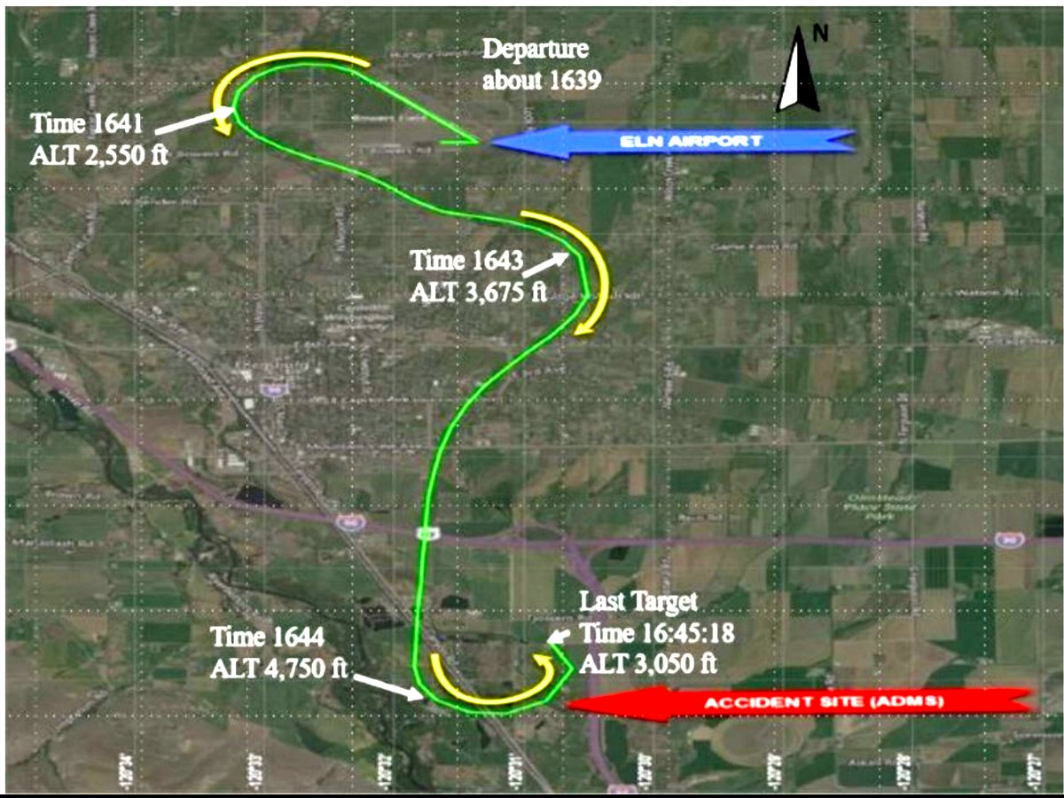

Garfly Posted May 3, 2021 Share Posted May 3, 2021 (edited) The first shot of this video about the accident is as moving as it is rare: a static wide shot of a peaceful winter landscape - almost like a painting - then an ominous digital zoom directs our gaze to the distant cloud base and we suddenly get it, it's a moving picture ... http://www.kathrynsreport.com/2019/01/piper-pa-23-250-aztec-e-n14372-fatal.html Edited May 3, 2021 by Garfly Link to comment Share on other sites More sharing options...

Garfly Posted May 3, 2021 Author Share Posted May 3, 2021 Reportedly, he'd planned to complete the flight in VMC - though he was IFR rated - and that still looked do-able at take-off. Maybe another case of (even) experienced instrument flyers losing it when caught in a sudden unexpected white-out. He was a very talented and well loved surgeon, by all accounts. Link to comment Share on other sites More sharing options...
