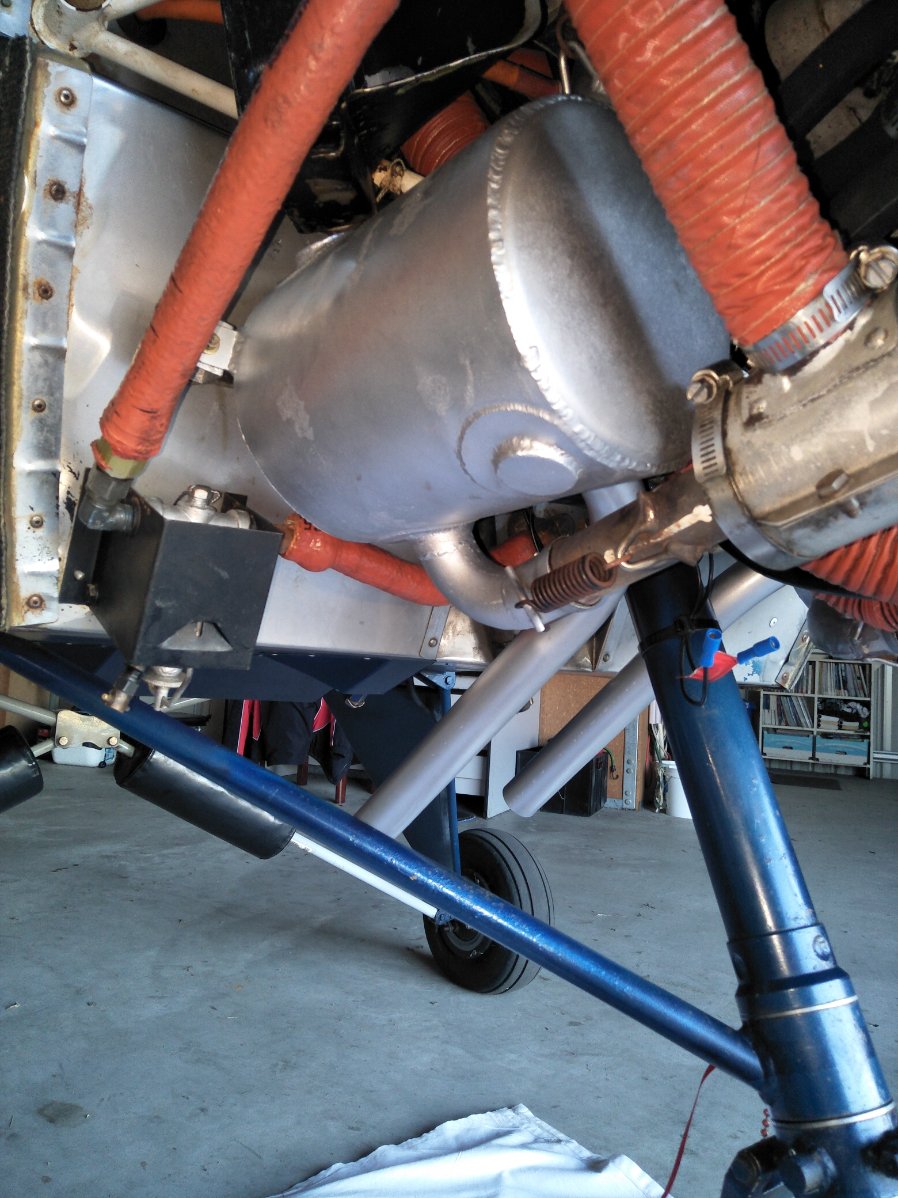

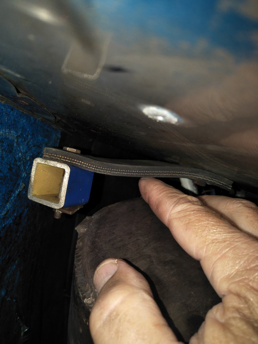

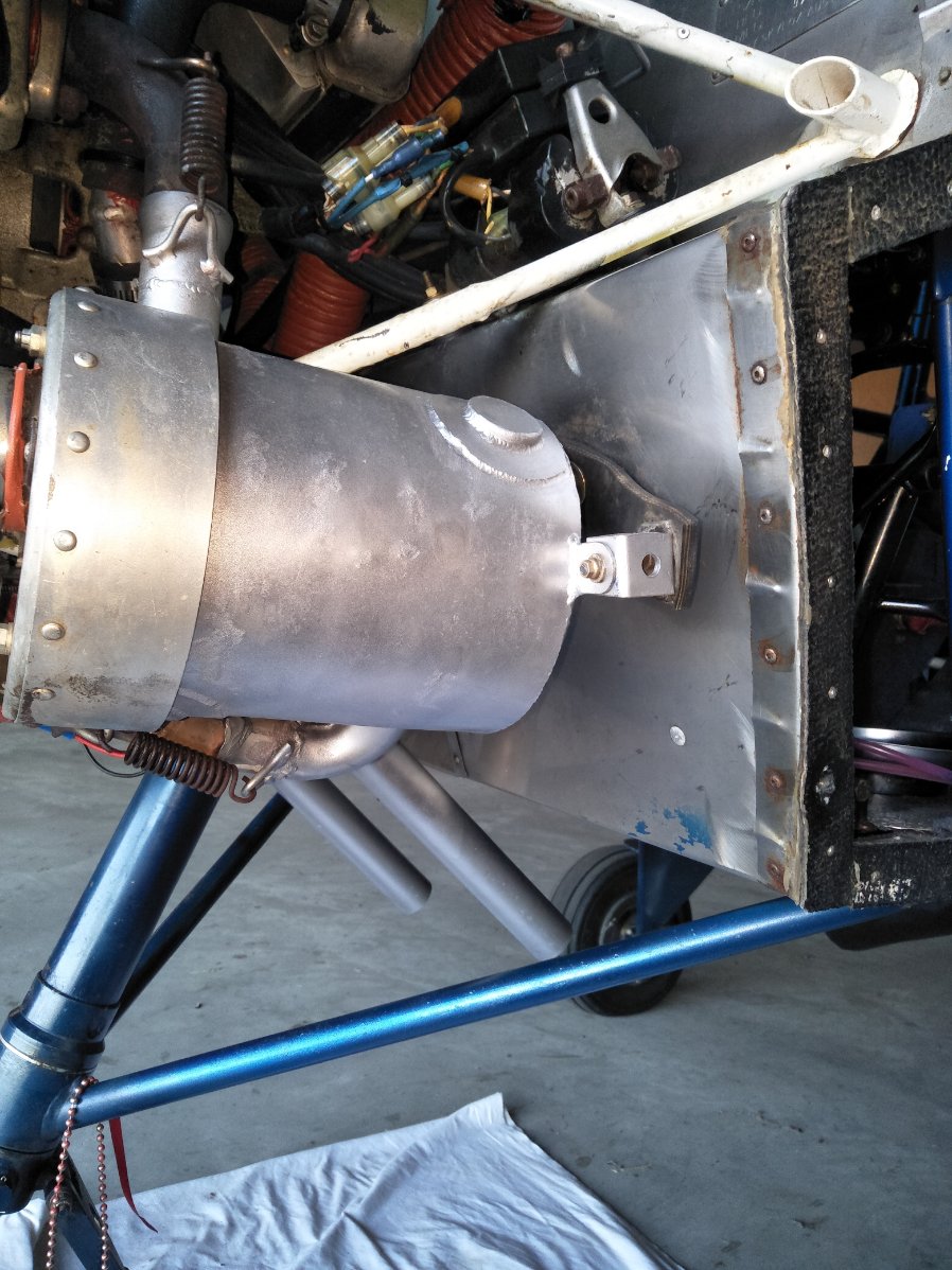

F10 Posted February 21, 2022 Share Posted February 21, 2022 This started with me doing a repair to a broken support bracket on my Gazelles LHS muffler. Every 10 hours of so, I lie on my back and have a careful look at the engine undersides with a torch, through the rear cowling air opening, as the bottom cowling is a bit of a job to take off. I noticed the broken bracket. A rubber strap is attached to the bracket, supporting the rear section of the muffler. A mate did a great job welding the bracket back on. I removed both mufflers cleaned up areas, painted them in high heat silver and attached brackets with new hardware. Rotax Service manual calls for Loctite anti seize compound to be smeared on the exhaust tub ends, so the mufflers don't corrode onto the stubs. This I did. Satisfied with my work, I put back cowlings, oil tank burped engine, checked fuel contents and drained sumps for water, dragged her out the hangar and was keen to get airborne! Having done maintenance, and spent two days looking over the Gazelle in the hangar, I felt I had more than the usual pre-flight and as such climbed in without my final gross check walk around. Taxied for RWY 09 West Sale. Wind was 160/16, not great but in limits. Started my take off, acceleration and rate were normal, speed was indicating but low and fluctuating, things happen fast and she was in the air, as I do, held the climb attitude and saw speed was very low and fluctuating. I watched the flickering IAS needle and was surprised to see it still only showing 20 odd Kts....Then it clicked... Whipped my head left, there was the red "Remove Before Flight" ribbon happily waving at me, with still attached pitot tube cover....I was astounded I had simply not noticed it, despite looking around whilst in the taxi and doing control checks!...🙄🙊🙈 In that instant I thought, land back. But in this crosswind and the end of the runway approaching, I decided a need a moment to assess this situation. I selected the climb attitude and climb power, knowing it would give me the normal climb performance. I selected the GPS page showing ground speed, as taking the surface wind into consideration, this would be a useful speed reference. I flew a 500 Ft circuit, using standard power settings and flight attitudes for downwind and base leg descent. I try fly constant circuits with as few power changes as possible, which gives me a good idea of power settings required in the circuit. All the time I referenced the ground speed readout as an indicator for safe speed. I flew finals and landed without further incident, appreciating the Gazelles gentle handling! Safely on the ground and shut down, I inspected the landing gear for what could have been a high speed touch down and examined the pitot tube for any damage. Furious with myself, 😡 I started up and carried on the local area flight, happily with no further issues. Airspeed indications were now normal and as per usual she sailed along without a care in the world. Well what can I say..... my first pitot tube cover forget in 35 odd years in the game, hopefully my last! I have filed an incident with RAAus, so hopefully some may learn from it. 7 4 Link to comment Share on other sites More sharing options...
