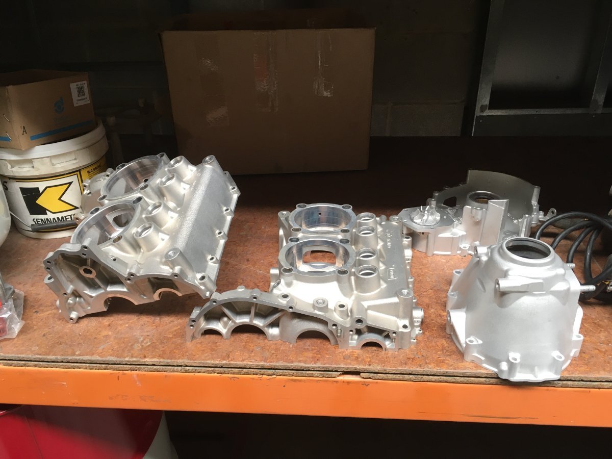

Mike Gearon Posted June 21, 2022 Share Posted June 21, 2022 On 12/6/2022 at 7:51 PM, Kyle Communications said: This is why I went for the 912ULS Rotax..but mine has a big bore so its basically a 914 in HP Is this ordered yet? I was on the phone today with these guys. http://zipperbigbore.com/1484-zipper-high-power/ My Rans S21 has the UL520 on order. I have another project with 80hp 912 that is going to get a HP upgrade to 120hp for 4.5k USD plus Replacement ignition modules with soft start. Their tech guy Hal is one of the top STOL competitors in USA and many years on engines. Link to comment Share on other sites More sharing options...

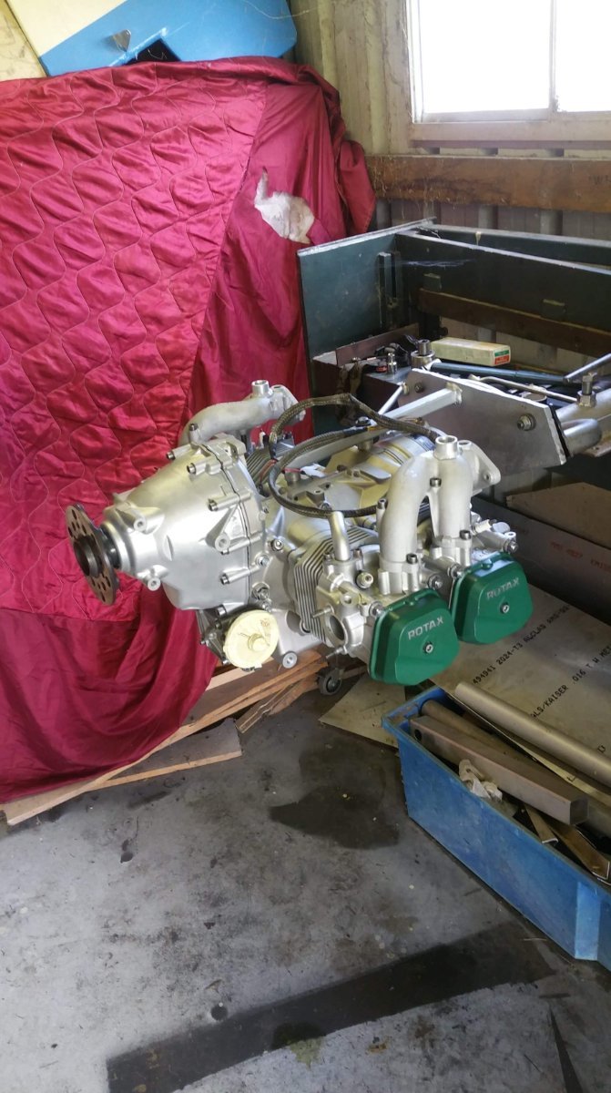

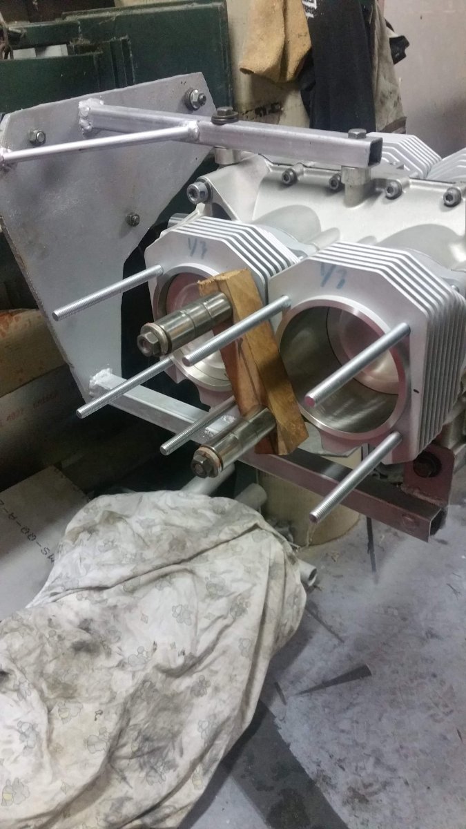

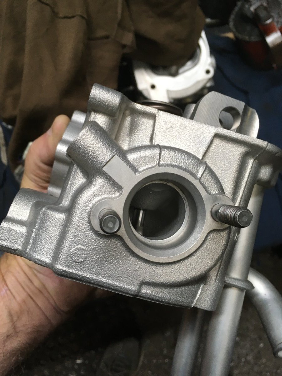

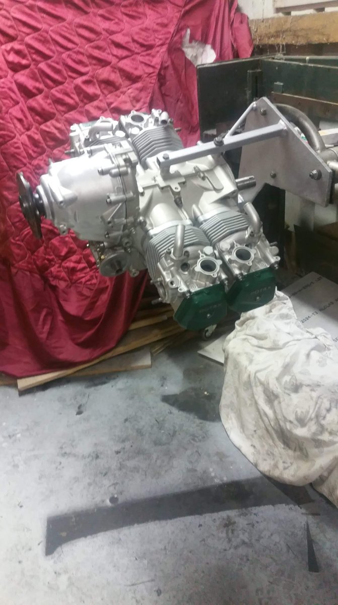

Kyle Communications Posted June 21, 2022 Share Posted June 21, 2022 My big bore retrofit has been done. Complete engine is sitting in the engine frame. It was a 2000 hr 2015 engine from a training aircraft. I had the gearbox rebuilt as per 1000 hr services the engine has all new bearings, lifters,valves,springs,new sprag clutch etc. The cam lobes have also been ground to ensure that the lifters rotate as they should. This is where Edge has had some failures and also std Rotax engines. The video shows the lifters rotating as the engine is turned over. The big bore kit fitted and then the entire engine has been balanced. Rotax engines are NOT balanced from the factory My big bore kit is from the original designer of the big bore kits. Ronnie Smith from Flymlsa in Mississippi. He used to supply edge and Zipper I believe until they both went off and basically copied it to do their own. I met Ronnie at the Rans open day in 2018. He is a Rotax guru he not only has a full rotax rebuild workshop and new sales he also goes all over the USA and Canada doing the Rotax full engine maintenaince courses. What he doesnt know about Rotax engines is not worth knowing 229E5DEC-6700-4389-A1F4-28D239FE52D3.MOV 3 1 1 Link to comment Share on other sites More sharing options...
Mike Gearon Posted June 21, 2022 Share Posted June 21, 2022 Glad I asked. I was told from one source that Edge sourced from then copied American work. It’s obviously more complicated than that. Zipper, edge and stol creek are easily found for big bore kits. https://flysmla.com/ Doesn’t actually mention big bore kits from what I could see. Link to comment Share on other sites More sharing options...
Kyle Communications Posted June 21, 2022 Share Posted June 21, 2022 He doesnt have to advertise them...just contact them direct Link to comment Share on other sites More sharing options...
Mike Gearon Posted June 21, 2022 Share Posted June 21, 2022 11 hours ago, Kyle Communications said: He doesnt have to advertise them...just contact them direct Well, I’ve just had a thorough education. Called Ronnie. Nice guy. He is visiting California running rotax courses. I’ll order when he’s home. 1. Yes, Ronnie was the originator. The others copied. Edge does get their cylinder made at the same place as Ronnie. They start with a different billet. I trust the spec Ronnie runs. Particularly when I now understand Edge will provide my 80hp with a 120hp conversion and they use the same cylinder for 80 or 100hp. Ronnie explained the remaining material is too thin on the 80hp. 2. Pistons. I’ve seen some controversy on skirt cutaway. Ronnie runs his pistons as close as possible to Rotax spec from a known piston maker. He has top ring from a Phoenix supplier that is superior. I was a bit overloaded at this stage to take good notes. Very appreciative of your comments Mark. I’ve just texted Ronnie. He’s confirmed back I can change the 80hp to 100hp. That’s actually plenty. I’m cutting the 49ft motor glider wings down to 31ft… well, I’m having the USA Pipistrel go to guy in New Mexico do it. Just has to rehinge the flaperon end. If this thing just stayed on the ground I’d enjoy tackling it. More careful seeing as it flies. Tundra tyres and It’ll look like the pic below but not as shiny. 20 year old aircraft. The 36ft wing version with 100hp is am economical 145kn cruise 17:1 glide I’m cutting down to 31ft to fit in hangar and possibly 13-14:1 glide. Just have to find a pilot willing to find out what the cruise and VNE is going to be. I’m told the wing camber/ dimension tail and boom are identical on the Virus. 165kn VNE It’ll be my daily commuter. Just has to get in the air and fly over the water. About 8 minutes to save 2 hour car/ ferry/. Ar trips. Some trips 40 minutes north to Wangaratta farm. S21 will be for the more serious flying. 2 Link to comment Share on other sites More sharing options...
