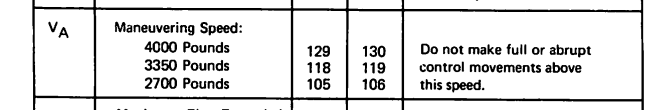

Always slow down to Vmaneuvering in turbulence !  It might be slower than you think if the aircraft is low in weight compared to max weight.
According to the (pressurized) P210N POH : (and same in a T(urbo)210N)
empty weight abotu 2200, so 210 litres, 2 pax and some luggage and tie downs etc  probably  2950 lbs - IE around 111 kts

No.  google "FAA definition of Va".
FAA defines this as : the airspeed at which the airplane, subject to a sudden control input , or , gust will stall rather than exceeding the design structural limitation / maximum load limit.
And more weight on board means higher stall speeds (as usual) .
If you fly faster, the wing can produce more lift. IE  for Va = 80 kts.....you are flying along at 70 kts and yank the column back  to maximum AoA. below Va, the wings dont fall off.
you are flying along at 100 kts, and yank the column back to maximum AoA , the wings produce a sh1t ton more lift (2.04x precisely) , you exceed the structural limitation of the aircraft, the wings fall off.
The relationship with flying in turb is that you are hit by a gust at some angle which emulates a higher AoA and hence instantaneous lift.  bad.

4 hours ago, Old Koreelah said:
That doesn’t make sense; surely with higher weights, you’d need to reduce the speed in bumpy air?
If your aircraft has a MTOW of 1000 kg and max load factor of 4g it means the the wings can produce 4000kg of lift.
If you stall at 100 knots at 1000kg and 4g, it means that at that speed you can't overstress the wings.
However, at 800kg, 100 knots still gives you up to 4000kg of lift, but that is 4000/800 = 5g.
The wing still sees 4000kg and is OK, but other parts of the aircraft see the higher loads e.g. seats, baggage compartment floor load limits are based on the same 4g limit and might be damaged. The G load applies to the whole aircraft, not just the wings.
