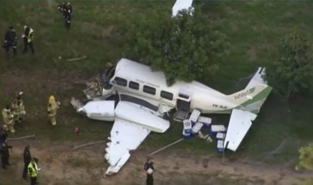

red750 Posted April 6, 2023 Share Posted April 6, 2023 More photos: Link to comment Share on other sites More sharing options...
old man emu Posted April 6, 2023 Share Posted April 6, 2023 Don't think that'll buff out. Too bad you can't see the starboard engine, cause the port one was working. Note the direction the fence posts have been knocked down. The plane has come in from the left side of the picture, on its belly and the port wing has clipped a tree. That made it rotate about 180 degrees and the nose must have hit another tree. Who's backing the idea that the starboard engine quit? Link to comment Share on other sites More sharing options...

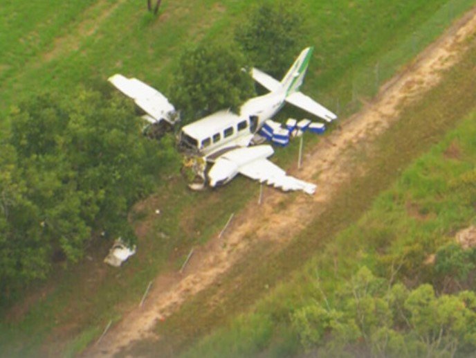

red750 Posted April 7, 2023 Share Posted April 7, 2023 Link to comment Share on other sites More sharing options...
red750 Posted April 7, 2023 Share Posted April 7, 2023 1 Link to comment Share on other sites More sharing options...
Carbon Canary Posted April 7, 2023 Share Posted April 7, 2023 As the saying goes for twin engine aircraft……..”it’s ok if one engine quits - the other will still be able to carry you to the scene of the crash” The pilot did well to walk away from this one- I wish her a speedy recovery. The contents of those eskies is a concern though. A good chance they were blood supplies leading into Easter. 1 1 Link to comment Share on other sites More sharing options...
red750 Posted April 7, 2023 Share Posted April 7, 2023 Looks like she tried to put down on that path alongside the rail line, only to hit those thin posts creating the serated leading edge of the left wing. They would have been impossible to spot when selecting a landing area. 2 Link to comment Share on other sites More sharing options...

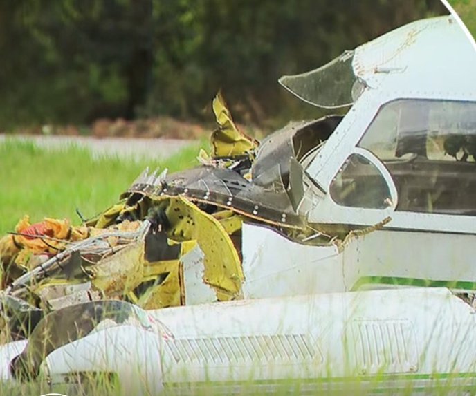

old man emu Posted April 7, 2023 Share Posted April 7, 2023 2 minutes ago, red750 said: she reported both engines stopped That port prop looks like it was turning when it struck the ground. Typical prop strike bending. 1 Link to comment Share on other sites More sharing options...
red750 Posted April 7, 2023 Share Posted April 7, 2023 Just reporting what she said on the tape. 1 Link to comment Share on other sites More sharing options...

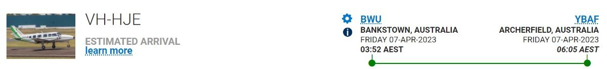

Kiter Posted April 8, 2023 Share Posted April 8, 2023 Planefinder shows 1942UTC 9,000' at 197 knots (basically unchanged for over an hour) 1945 8,307' at 197 knots 1950 5,533' at 181 knots 1955 3,536' at 109 knots (best glide?) 2000 2,548' at 109 knots 2005 300' at 93 knots 2 Link to comment Share on other sites More sharing options...
