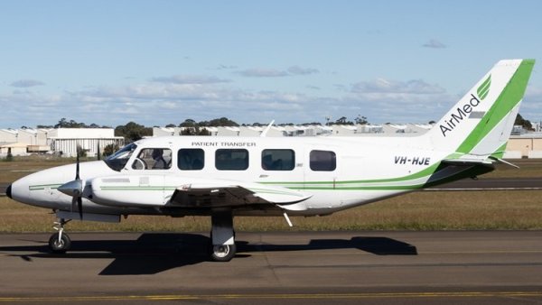

facthunter Posted April 11, 2023 Share Posted April 11, 2023 Some systems you can vent overboard but you should always confirm with gauge movement. Tip tanks on a Comanche need to be used up early as a power loss makes the fuel unavailable. I can't racall the Navajo . I've time on the Chieftan under instruction, but never bothered with the endorsement. Fuel management is usually a 100% pass required like weight and balance is. . Nev 1 1 Link to comment Share on other sites More sharing options...

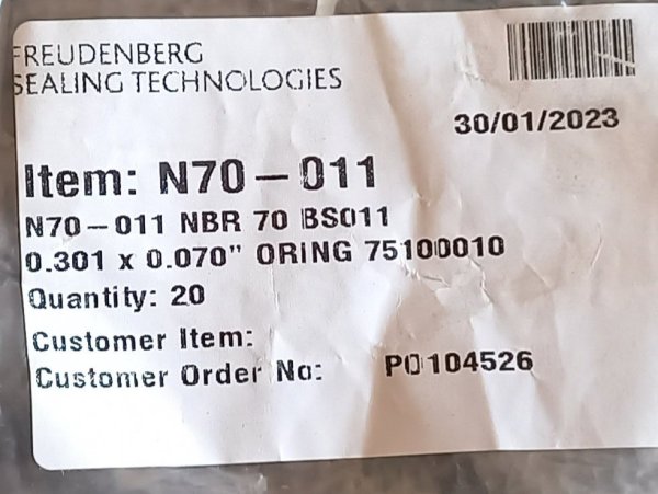

trailer Posted April 12, 2023 Author Share Posted April 12, 2023 5 hours ago, planedriver said: though the old O rings look okey, today I bought new ones. Each O ring cost 11 cents Do you have a size for the O ring, I'm inspired to do the same. Link to comment Share on other sites More sharing options...
Old Koreelah Posted April 12, 2023 Share Posted April 12, 2023 Trailer they were “110” on the O ring board at our local Engineering shop. 14.45 OD, 9.35 ID, 2.5 thickness- my amateur reading of the vernier. I have an assortment of O rings, but cannot be sure of their quality or suitability for fuel, so went to town to get what I hope are proper ones. Just pulled out the old fuel lines, which are marked SAE 30R7. Replacing them with SUNFLEX ROFL050 fuel line SAE J1527 6mm. This hose claims to cope with 100C continuous service. 1 1 Link to comment Share on other sites More sharing options...

trailer Posted April 16, 2023 Author Share Posted April 16, 2023 (edited) On 12/04/2023 at 2:28 PM, Old Koreelah said: Trailer they were “110” on the O ring board at our local Engineering shop. 14.45 OD, 9.35 ID, 2.5 thickness- my amateur reading of the vernier Jabiru fuel drain O-ring size. I took an o-ring off the fuel drain and took it to a local supplier. The 110 was too big so like for like this is what I installed. No leaks and did several aircraft. One early model Jab had a badly perished o-ring and did not survive removal, so was a good job done. Best supplier of course is Jabiru who I usually support for most items. Edited April 16, 2023 by trailer 1 1 Link to comment Share on other sites More sharing options...
