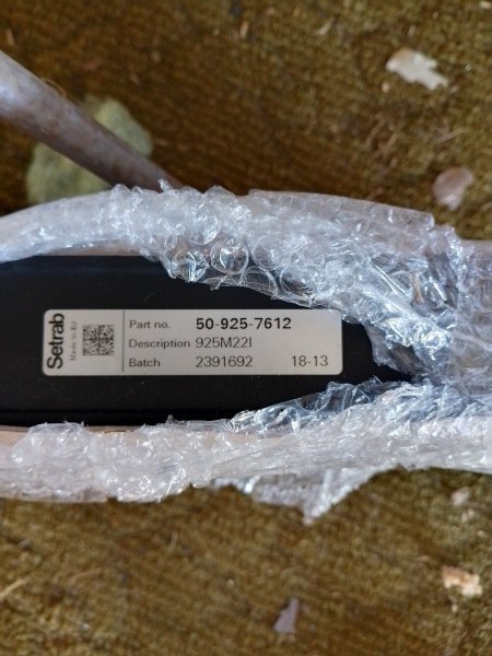

danny_galaga Posted April 9, 2023 Share Posted April 9, 2023 I've been having fun taking note of alternative spare parts for my build. I will try and see what brand my radiator is next im at the hangar. Bushcat roughly similar specs to the Savannah. 1 Link to comment Share on other sites More sharing options...
danny_galaga Posted April 9, 2023 Share Posted April 9, 2023 oh, i can see in the manual it is Setrab, same as the oil coolers. Setrab have agents in australia. I'll see if i can find a part number in the picture, otherwise i will still have to have a physical look. 1 Link to comment Share on other sites More sharing options...

danny_galaga Posted April 29, 2023 Share Posted April 29, 2023 Just in case you need another and this one is the right size, this is for the Bushcat 1 Link to comment Share on other sites More sharing options...
