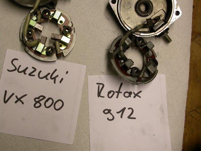

danny_galaga Posted April 12, 2023 Author Share Posted April 12, 2023 (edited) 37 minutes ago, facthunter said: EVEN Pull would be best or you'd get more bearing wear. They only have plain bearings and armature Polling is disaster Nev. It's a very small force compared to everything else going on in there. A lot of the 2 brush jobbies are 90 degrees to each other. On my accusation of a RO-tax on the starter. Maybe I was too harsh. Here's the price for the similar Suzuki starter mentioned earlier 😲 https://www.cmsnl.com/suzuki-vx800-1990-l_model14275/partslist/FIG-23.html#.ZDZm6WR_U0E Price for that after market one is about $210 including freight as far as I can tell. 🤔 Edited April 12, 2023 by danny_galaga 1 Link to comment Share on other sites More sharing options...
danny_galaga Posted April 12, 2023 Author Share Posted April 12, 2023 Looks like the latter Rotax starters are 4 brush, and the earlier black starters are 2 brush 1 Link to comment Share on other sites More sharing options...

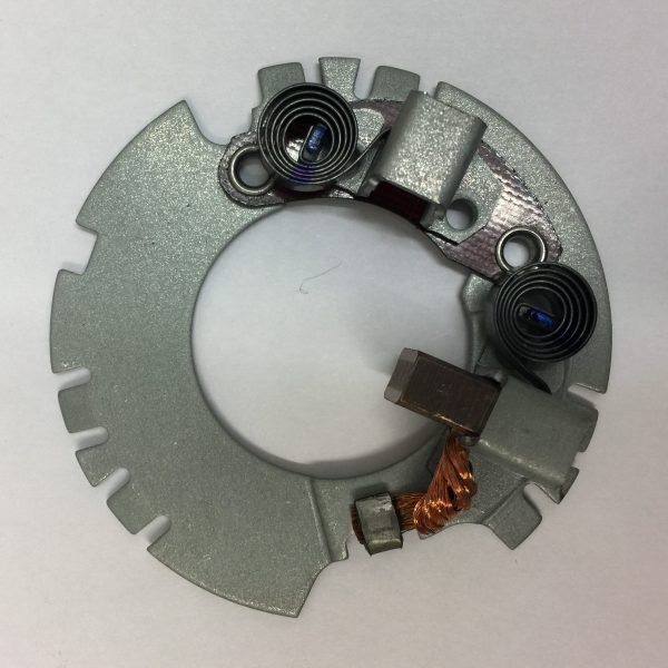

danny_galaga Posted April 12, 2023 Author Share Posted April 12, 2023 Damn it was hard to find a 3 brush starter example. I thought I was losing my mind 😄 1 1 Link to comment Share on other sites More sharing options...

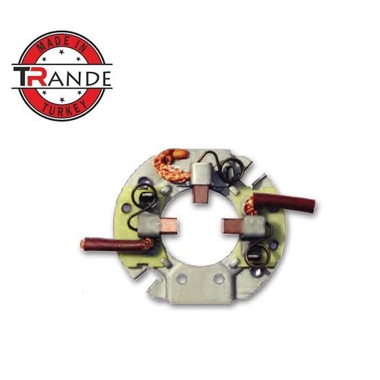

facthunter Posted April 12, 2023 Share Posted April 12, 2023 Cheez they couldn't look much crappier. See the copper in the brushes.? Have a look at older DELCO starters. for quality. RR at one stage used DELCO electrics. 1 1 Link to comment Share on other sites More sharing options...
danny_galaga Posted April 12, 2023 Author Share Posted April 12, 2023 5 minutes ago, facthunter said: Cheez they couldn't look much crappier. See the copper in the brushes.? Have a look at older DELCO starters. for quality. RR at one stage used DELCO electrics. Yeah that pic seems to be an aftermarket part from Turkey. Delco were ok. My own personal opinion was that Bosch were the gold standard in quality. Nippon Denso weren't bad (and as we are noticing on this little journey, quite ubiquitous on small engines). At the bottom of the heap in terms of design and or quality were Lucas, prestolite, magnetti Martelli and Hitachi There were niches of course. CAV made really good quality truck starters, albeit complicated. Bosch next in truck starters, then Delco. Delco weren't bad mind you. Just a bit simpler. Easy to overhaul though. 1 Link to comment Share on other sites More sharing options...
