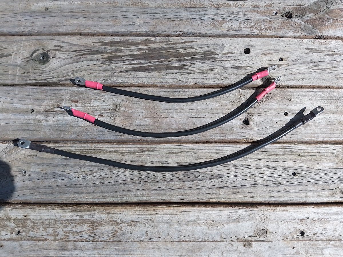

Anyone using automotive cable for their starter motors?
danny_galaga
2 hours ago, danny_galaga said:
Oh my god, such an epic struggle to get a few cables made…
I have several cheap welders in my shed. They may be dead, but their cables are ideal for carrying starter current.
I didn't tell any off these guys it's for an ultralight as I get mixed results.
I learned to never tell them it was for any sort of flying machine.
I might as well have been asking for a window winder for a space shuttle. In Swahili.
That goes straight to the pool room!
10 hours ago, facthunter said:
In the past I've got all mine from REPCO.   Nev
Meh. Stopped at the local Repco and they had run out of ALL their cable 🙄
Just ordered some online from  some company with a ropey payment system. Hopefully I didn't just lose my money 😄
You could probably get something from CJs or EDMO.
TRY BAMBACH cables in Brookvale. (AUstralian made cables). well its where I buy all my non aviation cables from ...
