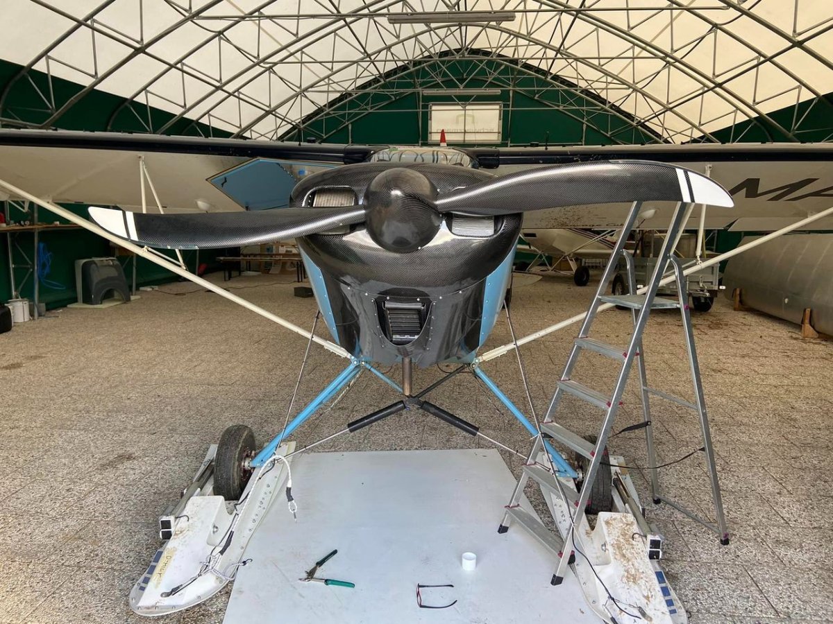

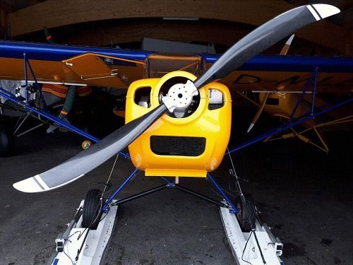

meglin Posted May 20, 2023 Share Posted May 20, 2023 Yes, very useful. And we came to the conclusion that 1.7 m diameter is best for 3-bladed Rotax-912-80 propellers in practice a long time ago, more than 20 years ago. But I did not see in your reasoning a positive effect of the sweep of the blade ends, as well as the wing sweep. It pushes back the wave crisis and the occurrence of compaction surges. It was the sweep that made it possible to use a 2 m diameter 2-bladed propeller on the Rotax-912/914 and to provide the Savage aircraft with maximum performance in all flight modes. It is the sweep that allows the Jabiru engine to have a 1.62 m diameter propeller and provide a significant increase in performance in most flight modes. 1 1 1 Link to comment Share on other sites More sharing options...
