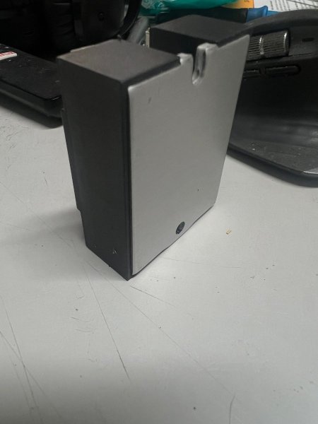

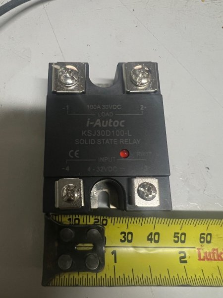

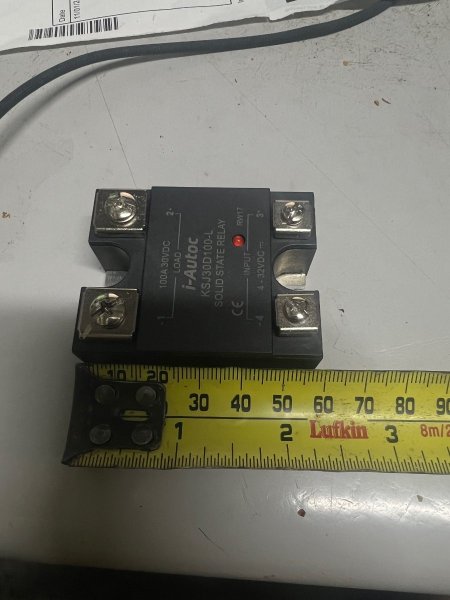

Kyle Communications Posted March 12, 2024 Posted March 12, 2024 Pictures and sizes of the SSR. also the heatsink on the back. I like too that you replace the screws with small bolts and all connections are on lugs not those stupid spade connectors 1 1
danny_galaga Posted March 12, 2024 Author Posted March 12, 2024 On 12/03/2024 at 7:42 AM, Kyle Communications said: Pictures and sizes of the SSR. also the heatsink on the back. I like too that you replace the screws with small bolts and all connections are on lugs not those stupid spade connectors Expand I get that what is good about it is that you have a very low trigger current, which is especially useful if you wanted to trigger it with say a 555 timer or something, or where you have a big boy plane with a panel drawing 25amps and a 170 amp alternator bolted to that Lycoming 0360. But I am talking about ultralights here. The total output of the alternator is 17 amps. That's the total, but all the loads add up to maybe 5 amps through my (described rather than named because I admit I'm guilty of confusing terms) OFF/ON/START switch. But if for some reason I thought that was too heavy a load for that switch (which it isn't), why wouldn't I just use a 35amp automotive relay? That will have a switching current of maybe 200 mA. What is the SSR? 50mA? But it's constantly dumping power. So yes, only 50mA through the switch, but several amps as heat through the heatsink, while the 35amp relay is only losing 200mA total. The original query was about total isolation of the battery. To do that needs something that can handle the cranking current of the starter. Which is either a giant relay (which is why I started the thread since I hated the idea) or a giant switch AKA a battery isolation switch. Gotta keep it simple on an ultralight, especially with only 17 amps to play with 🙂 2
Kyle Communications Posted March 12, 2024 Posted March 12, 2024 The wattage loss is very low even at 10 amps (6 watts max) which would be the most current drawn from a dual efis system and ancillaries. That is only while it is turned on. With semiconductors the limiting factor is the device's junction temperature. The reason I dont like relays is it is drawing all your avionics load current through a spade terminal. I much prefer the screw/boltability of the SSR to take all the load. As a case in point just look how many Rotax regulators end up with burnt out spade terminals on the regulators...I would know of 20 or 30 at least...I dont like them odds...its just not a good thing..Thats why AC43 pretty much specifies ring terminal connections when possible 1
danny_galaga Posted March 12, 2024 Author Posted March 12, 2024 (edited) You're still overthinking it for many ultralights. A switch alone can handle the current I'm talking about. What's the voltage drop across a good switch? It's pretty minimal, way less power loss than any superfluous extra wiring and doohickeys you have to add. More power less and more weight. But if your objection is spade terminals, I present, for your edification 🙂 Edited March 12, 2024 by danny_galaga 1 2

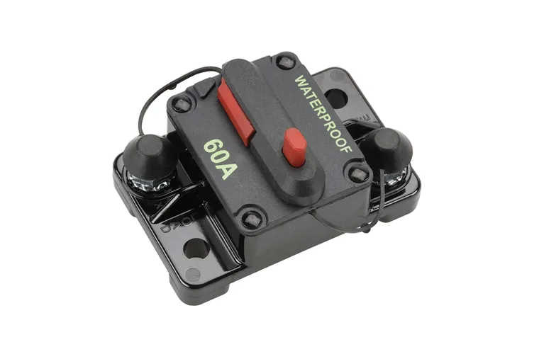

skippydiesel Posted March 14, 2024 Posted March 14, 2024 (edited) Saw something like this in the boot of a "muscle car with rear mounted battery :- Manual reset - certainly don't want an auto reset (also available) in an aircraft that might be heading towards a fire situation. Removes the need for any sort of manual switching system - less weight/complexity Various brands out there. In this type/shape. price seems to range from $14 -$70 and they all look pretty much the same (some colour & labeling variation). AMP's from about 30 - 120 The larger photo purports to be a Narva product @ 80 amps (must be a generic photo) PN 55962 Size 74X48 mm (no height listed). I would be intersted in your collective thoughts on this type of battery isolator Edited March 14, 2024 by skippydiesel 1
danny_galaga Posted March 14, 2024 Author Posted March 14, 2024 Very interesting, but it does circle back to the fact you need a pretty high amperage object to handle the starter motor cranking current if you want to isolate the whole battery. I personally would allow 500 amps cranking current for the Rotax starter. You might get away with say 200 amp but good chance you keep tripping it when trying to start.
Kyle Communications Posted March 14, 2024 Posted March 14, 2024 Skippy you wouldnt want to be running any starter motor current through that thing 2
