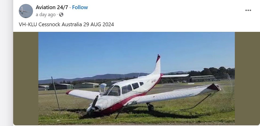

red750 Posted August 31 Share Posted August 31 /graphics/ICAOtype/P28A.gif Runway excursion Incident Piper PA-28-181 Archer II VH-KLU, Thursday 29 August 2024 ASN.FLIGHTSAFETY.ORG A Piper PA-28-181 Archer II veered off the runway when landing at Cessnock Airport (CES/YCNK), Cessnock, New South Wales, and crashed into a fence. The pilot was seriously injured and ta... Link to comment Share on other sites More sharing options...
skippydiesel Posted August 31 Share Posted August 31 The pilot was seriously injured Given what can be seen of the cockpit, this likly means that the pilot : Failed to wear seat belts correctly Failure of set belt and or seat Something incorrectly secured ,has hit him 1 Link to comment Share on other sites More sharing options...
DrChicken Posted September 2 Share Posted September 2 He didn't flare properly, ballooned down the runway, ended up fracturing some ribs. The seatbelt was on, when he hit the fence he went into the control column pretty hard. 1 Link to comment Share on other sites More sharing options...
kgwilson Posted September 2 Share Posted September 2 Lap belts don't restrain your torso and head from being propelled in to the control column and panel. 1 Link to comment Share on other sites More sharing options...
Red Posted September 2 Share Posted September 2 I've no idea if this aircraft had fitted shoulder harness (I did think pretty much all the older PA-28s had been retrofitted), but to me it's crazy not to fit them I hope the guy is ok, Fractured ribs hurt like hell and there is no way you can immobilise them (you simply have to breath) 1 1 Link to comment Share on other sites More sharing options...
DrChicken Posted September 2 Share Posted September 2 7 hours ago, Red said: I've no idea if this aircraft had fitted shoulder harness (I did think pretty much all the older PA-28s had been retrofitted), but to me it's crazy not to fit them I hope the guy is ok, Fractured ribs hurt like hell and there is no way you can immobilise them (you simply have to breath) It wasn't retrofitted iirc. My only issue with KLU was the horrendous com 1 with an old LCD display - you couldn't see the frequency unless you were looking at it directly front on. I think he's okay but it if I had to be completely honest, he was a way off from being signed off for solo but that's just another opinion. Link to comment Share on other sites More sharing options...
KRviator Posted September 2 Share Posted September 2 9 hours ago, Red said: I've no idea if this aircraft had fitted shoulder harness (I did think pretty much all the older PA-28s had been retrofitted), but to me it's crazy not to fit them I hope the guy is ok, Fractured ribs hurt like hell and there is no way you can immobilise them (you simply have to breath) I'm not sure I'd be willing to fly in something that didn't have shoulder harnesses - but in saying that, they still have their limitations. Even the RV's with a 4/5 point harness have a dangerous tendancy to bend the longerons in a sudden stop causing the shoulder harness attachment points to move forward, loosening the harness and rendering it less (or in-) effective. Link to comment Share on other sites More sharing options...
