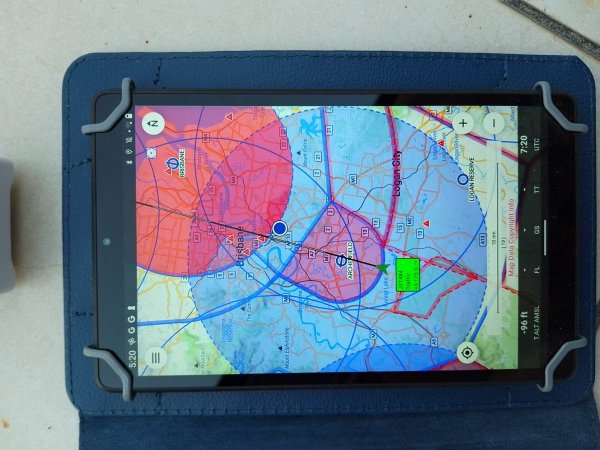

danny_galaga Posted August 31 Share Posted August 31 Thought I'd watch riverfire from home on my tablet, since who knows when I'll actually use this for navigating 😄  But it's been so long, I can't remember how to make it work. It used to be fairly automatic. Any ideas? Dunno if I'll get this sorted out in time. But theres always riverfire 2025... Link to comment Share on other sites More sharing options...
danny_galaga Posted August 31 Author Share Posted August 31 Oh, it's picking up flights now. But still gives me the same warning 🤔 Link to comment Share on other sites More sharing options...

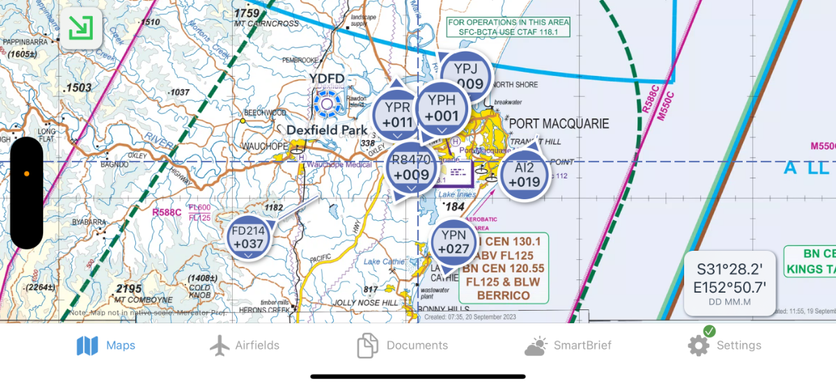

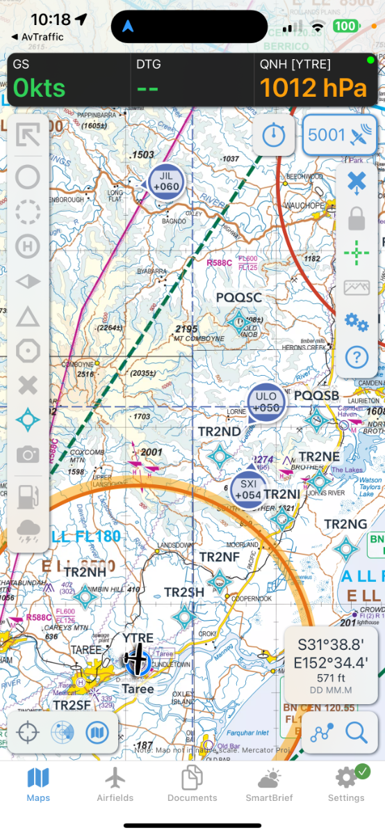

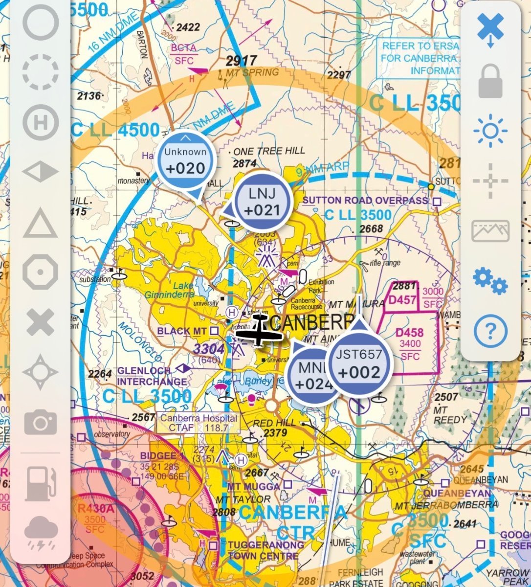

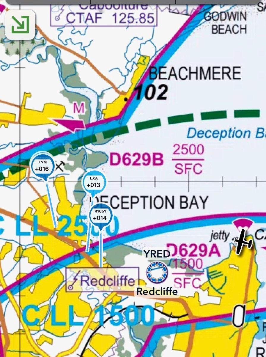

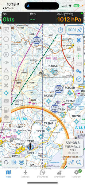

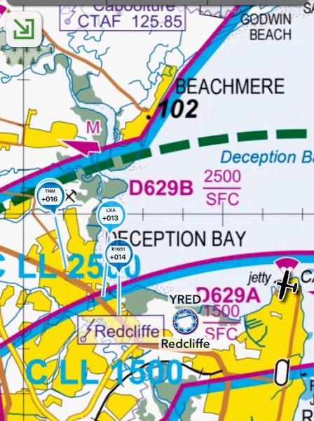

Garfly Posted Wednesday at 12:29 AM Share Posted Wednesday at 12:29 AM (edited) On 02/09/2024 at 5:23 PM, skippydiesel said: Anyone have a "screenshot" of SE2 reporting on OzRunways? ie Whats it look like?  Skippy, below are a few random screenshots. OzRwys uses the light blue symbols for its own in-house traffic system.  The dark blue are the ADSB derived targets (whether direct , say from the SE2 or indirect, from, say the AvTraffic app.)  The local (Southport Qld) 'AvTraffic' app is able to communicate with OzRwys (full version) and display its ADSB targets on the map page.  Of course,, this info is sourced from the online ADSB-exchange and so it's not as reliable as the direct air-to-air ADSB info from the SE2.  But AvTraffic does have a built-in audio traffic alert system which can be blue-toothed to headsets and even used in conjunction with the SE2.   AvTraffic AVTRAFFIC.COM    It's interesting to see how the number of aircraft with ADSB-OUT of some kind is on the increase.  It seems it's only a matter of time before it'll become mandatory.  Some of the screenshots below show ADSB targets (dark blue) fed from the SE2 and some of them show info from AvTraffic. For example I was interested in 'seeing' the traffic at Port Macquarie from Taree (27 NM away). This was only possible using the AvTraffic feed (or switching to another app.) The SE2, of course, has a limited (line-of-sight) range, whereas the ADSB exchange apps are only limited by the number of participating receivers in a given area. Anyway, these pics all happen to have been captured while on the ground.  All the altitudes displayed are in hundreds relative to the level of the device/own-ship.   CLICK ON PICS FOR FULL REZ      Edited Wednesday at 12:41 AM by Garfly Link to comment Share on other sites More sharing options...
danny_galaga Posted Wednesday at 01:05 AM Author Share Posted Wednesday at 01:05 AM That's quite neat 🙂. Mine just has green rectangles, but then again it's free software so I can't complain about that. 1 Link to comment Share on other sites More sharing options...
