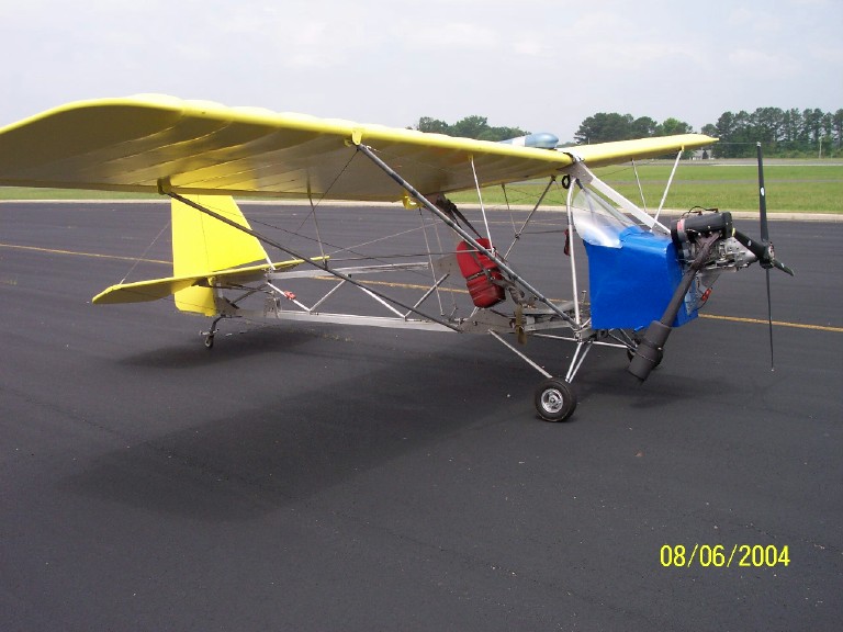

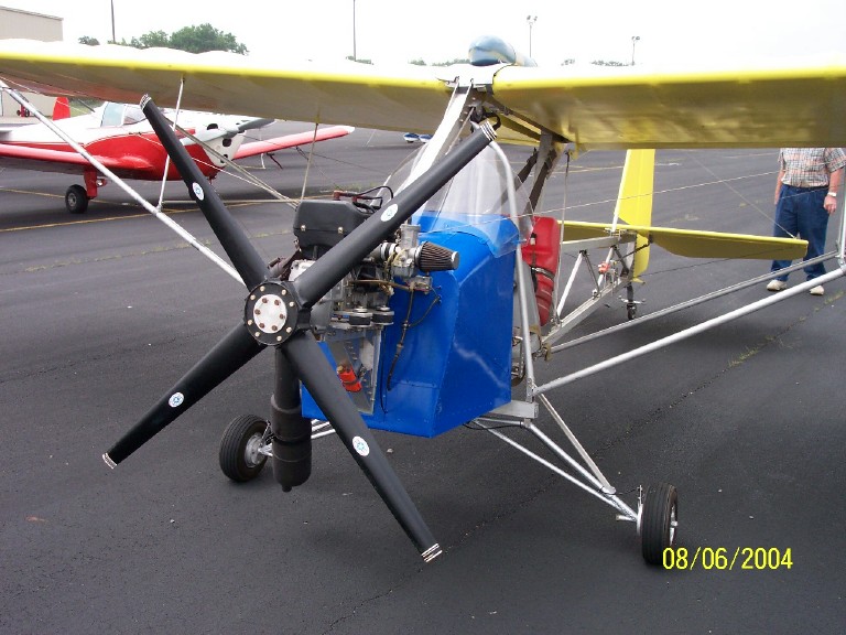

icebob Posted September 11, 2008 Share Posted September 11, 2008 Hi, sorry forgot to add the photo [ATTACH]6309[/ATTACH] The original plans used 1.7 once dacron but this aircraft used another product from France, the same strength as 3 oz but lighter and had UV protection inbuilt, he spary painted over the fabric with house paint. He made the wings 8 inches longer and has a 45HP motor. Bob. Link to comment Share on other sites More sharing options...
