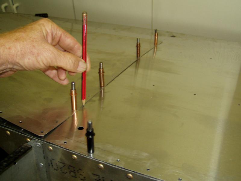

Hi all,
I thought I would share an idea I used in my VG XL build.
The thought of cutting half a square metre from the bottom skin of each wing scared the heck out of me. Where to cut? Is it too close or too far from the rivets etc etc.
Then I remembered how well these aeroplanes are engineered.
All the rivet holes are the same distance apart and the same distance in from the edge. So, to measure the distance in from the edge to the cut line, all I had to do was cleco the inspection hatch on from the outside in and scribe a line along the edge.
This is the line along the main spar, with me marking the line for the cut. The altenative is to leave it in place as is and use it as a guide to cut along. [ATTACH]7373.vB[/ATTACH]

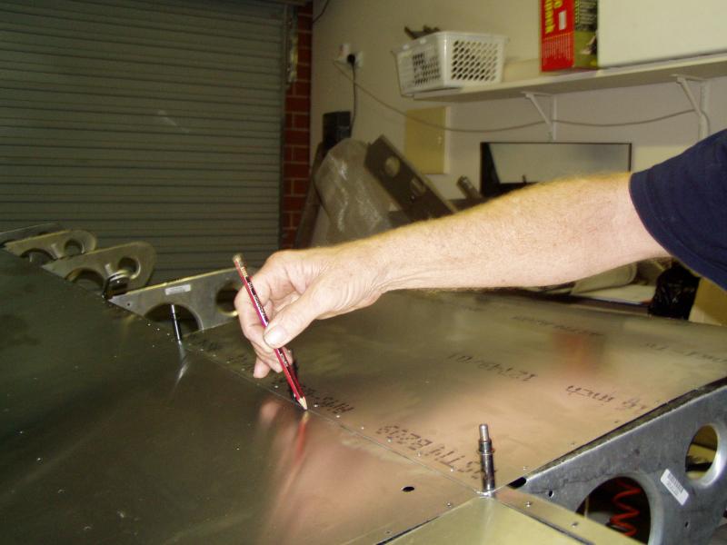

This is the line being scribed along the rib.[ATTACH]7374.vB[/ATTACH]
The bottom cut is just an extension of the original cut line.
