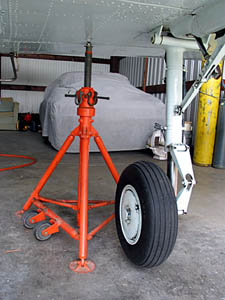

When jacking, be sure to do it properly. While a wing jack is not necessarily required, be sure any method that you use is safe and solid in case the wind blows while the wheel is off the plane. Check your pilot manual for proper jacking methods for your particular aircraft. A couple of 4x4s stacked under the bare axle is a good safety practice.
It is important that aircraft wheels and tires be as well-balanced as possible. Vibration, shimmy, or out-of-balance is a major complaint. However, in most cases, tire balance is not the cause. Other factors affecting balance and vibration are:
