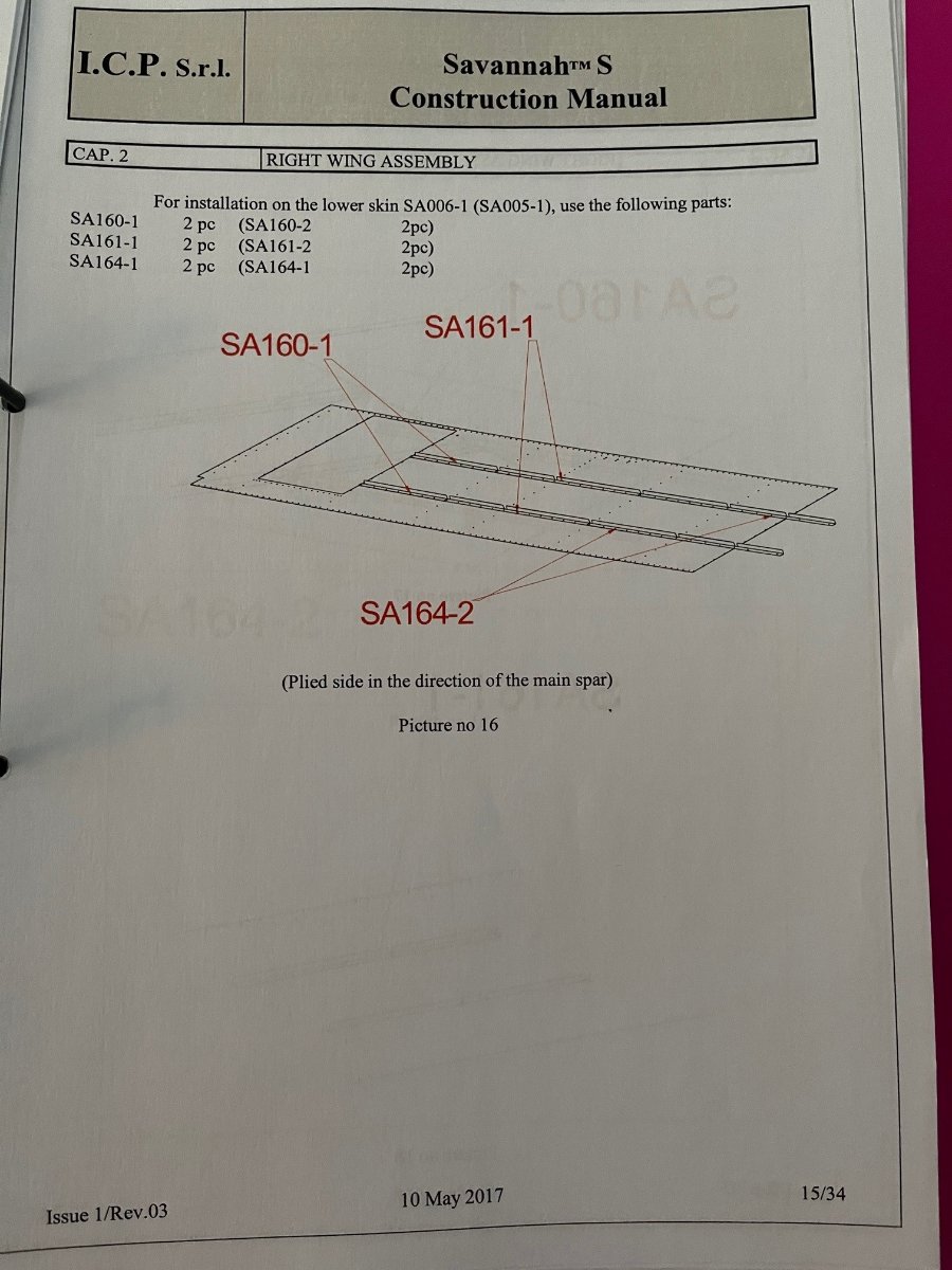

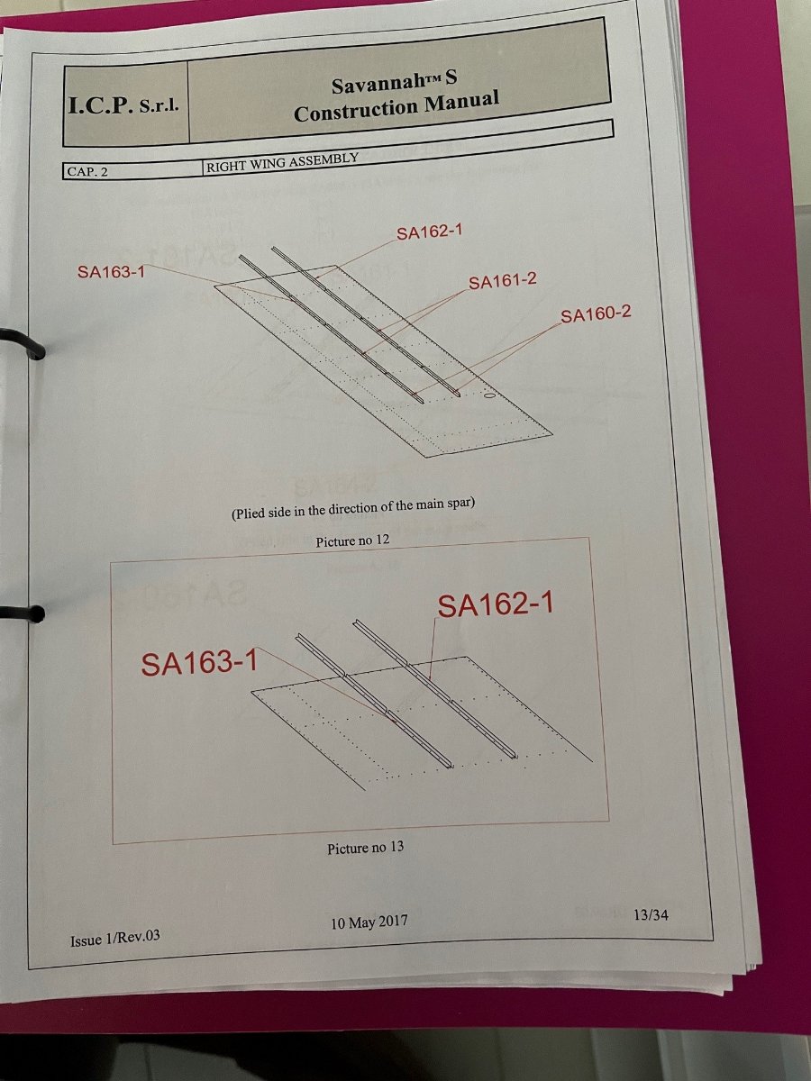

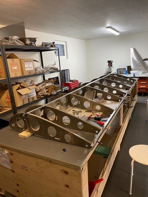

Hello to everyone, I need 😏 your invaluable help again I m building my Savannah right wing but unfortunately the instructions that ICP provided to me (see pictures) are for the european model with single tanks while my model has the double tanks. I think that the angulars should not been placed at the same location. Or perhaps am I wrong? Does anyone have the right instructions for the model with double tanks? That would very helpful to me. Thnak you in advance and blue skies Luca

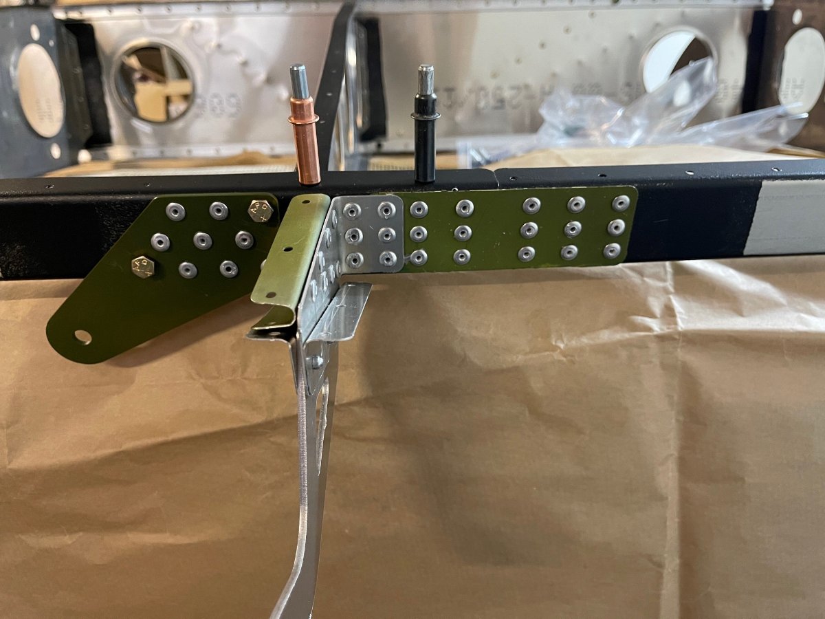

Yes, Bob thank you very much for your valuable advice. The top and botton rivets that fasten the nose ribs have 4 mm holes and so I used here A5 rivets. The rest was 3.2 mm holes and I used A4 rivets. The ICP instructions are not always very precise. I am very grateful for your support, with people like you to build is a joy😀🛩🔧

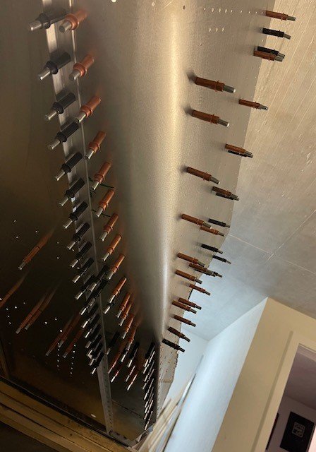

In the wing build instruction ICP write to use A5 rivets to fix ribs and longerons together. But there are some holes for A5 rivets and other for A4. Should I redrill all the 3.2 mm holes to 4 mm and set overall A5 rivets or should I follow the holesizes? ( that would mind to use A5 rivets for the 4 mm holes and A4 for the 3,2 mm) And on the pictures below are the rivets correct pulled ? I thank you very much for your help. I m a beginner 😢
