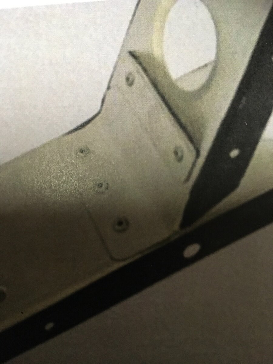

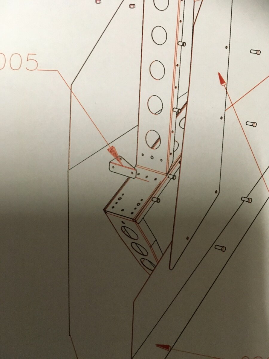

Hello to everyone, I need 😏 your invaluable help again I m building my Savannah right wing but unfortunately the instructions that ICP provided to me (see pictures) are for the european model with single tanks while my model has the double tanks. I think that the angulars should not been placed at the same location. Or perhaps am I wrong? Does anyone have the right instructions for the model with double tanks? That would very helpful to me. Thnak you in advance and blue skies Luca

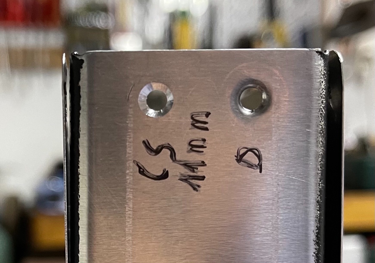

I thank you very much fir your reply. Yes, I have extra bought a tail kit and now I m making som experiments. The advices from the members in relation with my december thread was very interessant and helpful to me. I countersinked the hole in the picture with a 11 mm drillbit driven by hand . Blue Skies to all from south Switzerland

In one month I will start with the build of my Savannah For some positions countersinking is required and I’m making some experiments with some techniques. The first hole is countersunk with a 11 mm drillbit driven by hand The second hole is dimpled I also ordered some specials A4 rivets with countersinked head. I m curious to see how they work. Comments and advice are welcome lucas

Good evenening to everyone, I have ordered a Savannah S kit and at the moment I m building (to make practice and exercise / I m a pharmacist ) a tail fin that I have bought separately. In the build instruction I read: Slightly countersink the holes for rivets and install the rivets to have perfect flush head. How should I do that without weaking the very thin alumiunm sheet? With a drill bit? Wich Dimension ? I have no idea. Thank you very much in advance for any help. Lucas from Switzerland

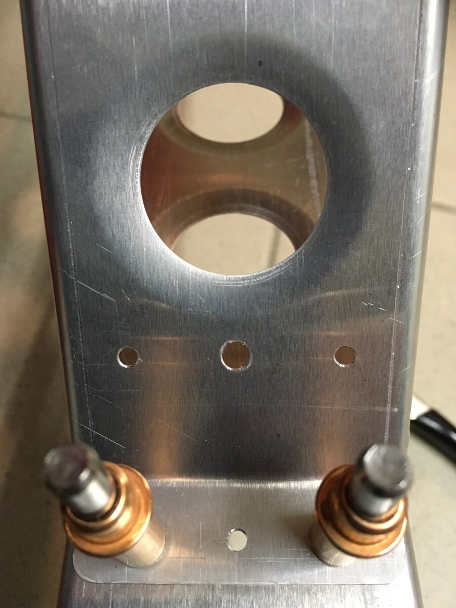

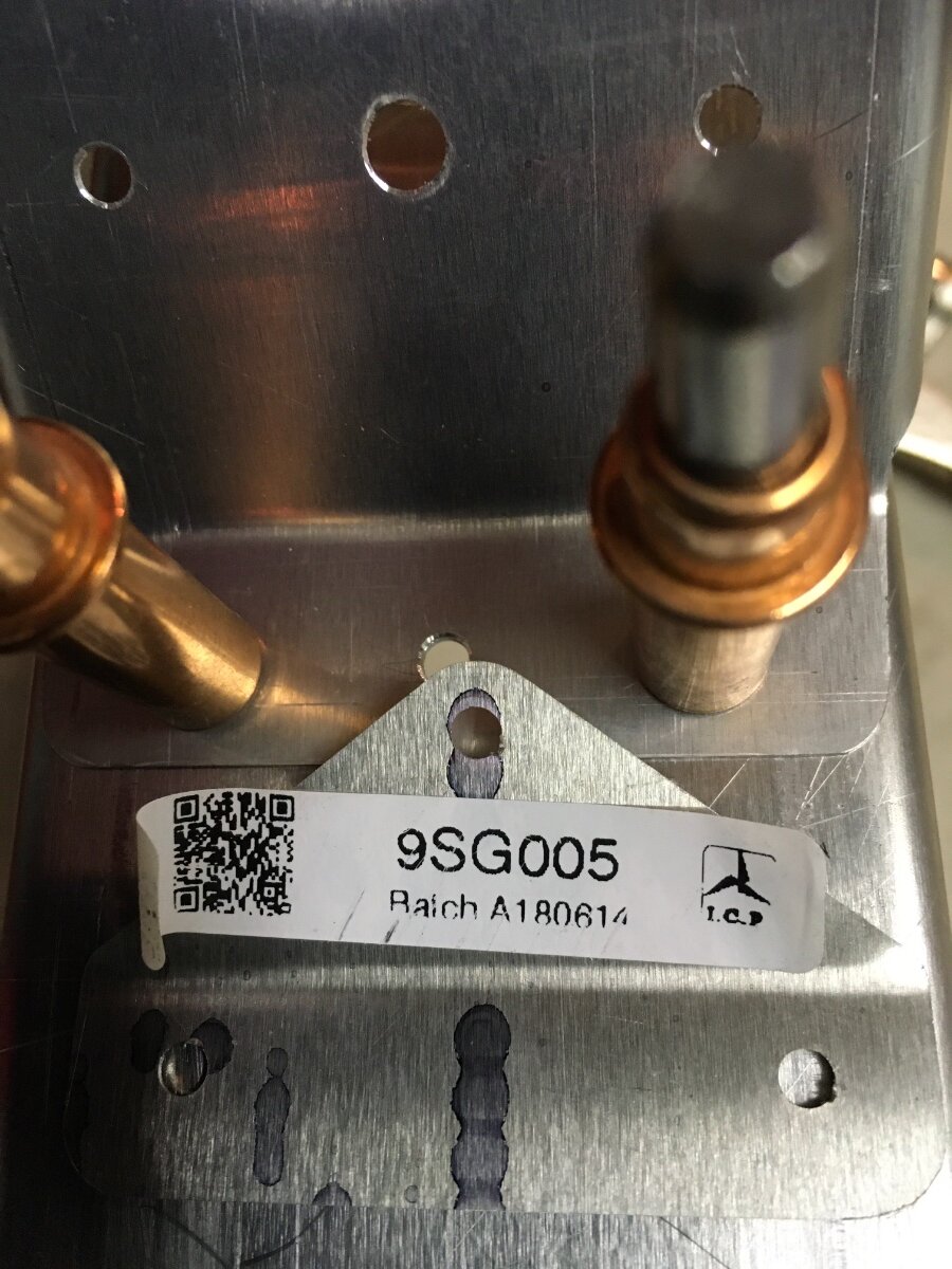

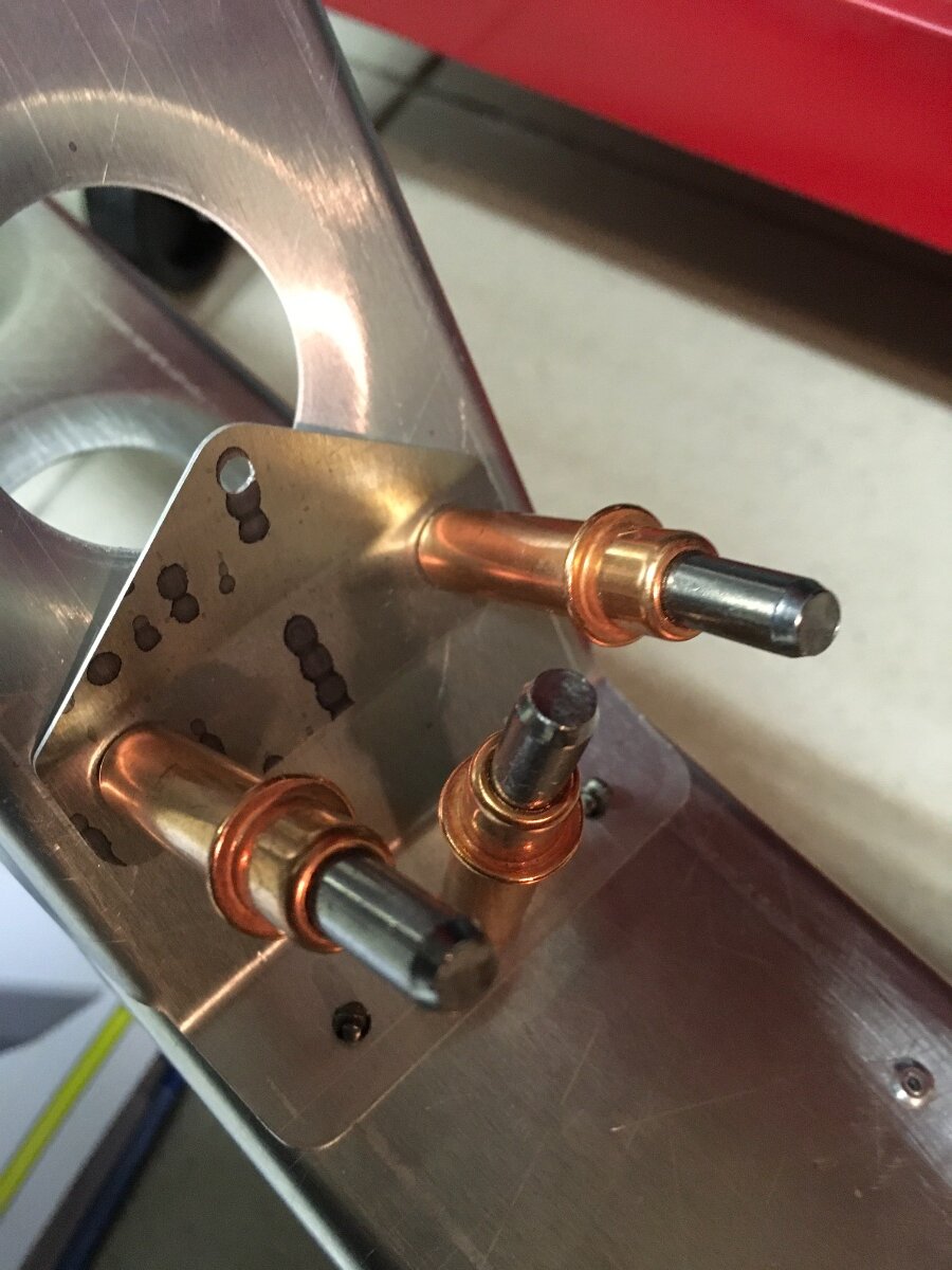

Hello IBob, thank you very much for your help😀 You are very kind. Is the position now correct? Best regards from South Switzerland Lucas
Hello to everyone, I m a first time builder and I’ m doing practice with a fin kit that I extra buyed from ICP. I don’t unterstand how to fix ( in which position) the angular SG 005. The manual and the enclosed pictures don’t help me. Can everyone help me? thank you very much in advance. Luca from Switzerland
