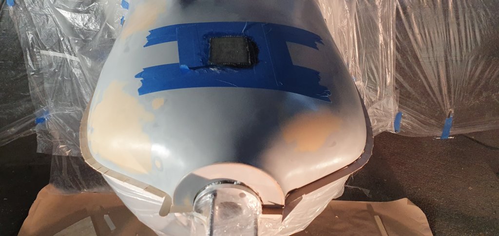

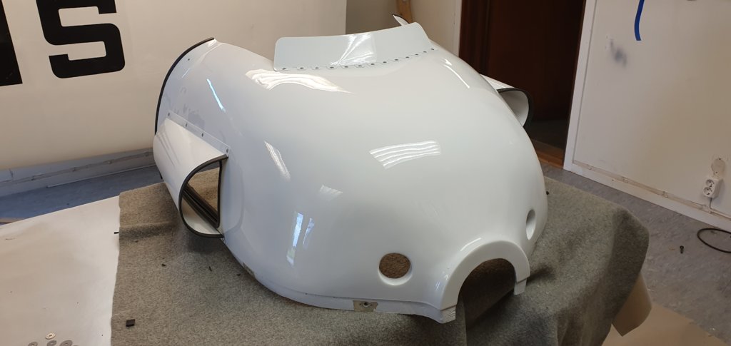

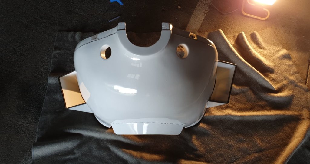

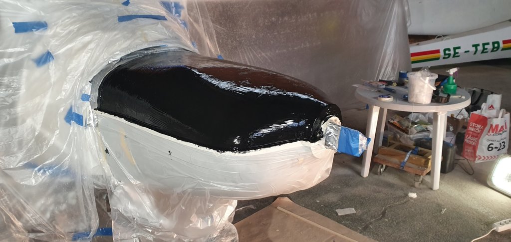

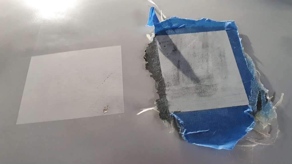

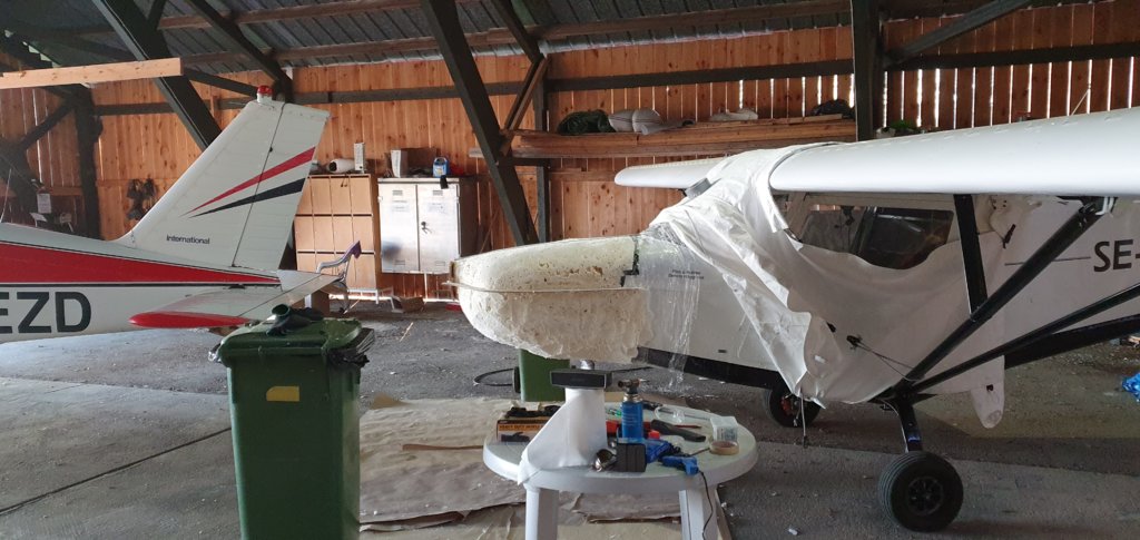

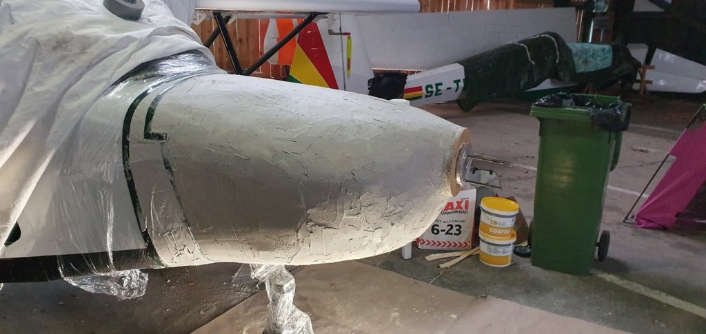

Gelcoat time. And as Seperator i used tongue depressor and hot glue. And another intresting fact, temperature rose from 5C to 24C in the pas few days, so filler expanded and i had to sand some spots... Yeah thanks, i did a test sample and it worked out nice, the liquid filler did not like the curing heat so i lowered the mix volume of hardener and i used allot of extra wax.
What a hell of a job, just spent another 3 days just fixing and sanding, jeeez, finally sanded with 400 grit & waxed, ready for mold.

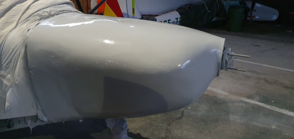

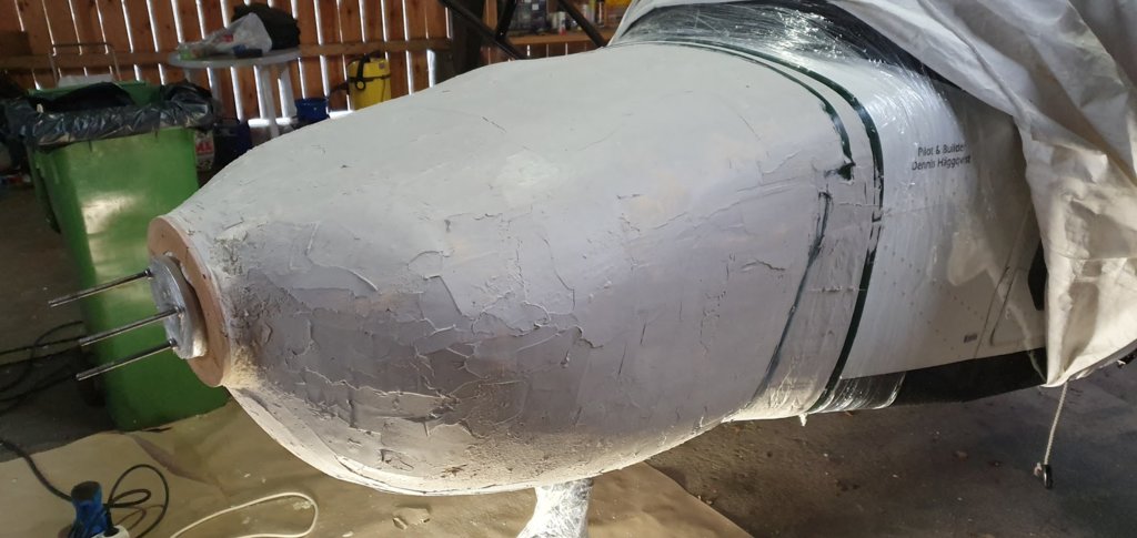

Got the shape ready, was a pain in the arse to sand the 2 part filler and now i have used liquid filler, next is to sand the filling one more time and then spray with 2 part paint and then on to the polyester mold.

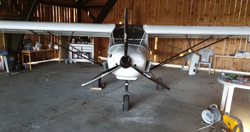

About 60 hours flying now and it performs pretty good now, no issues since last, im building up my confidence. And not by little, its huge.

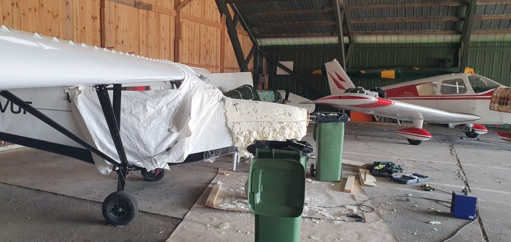

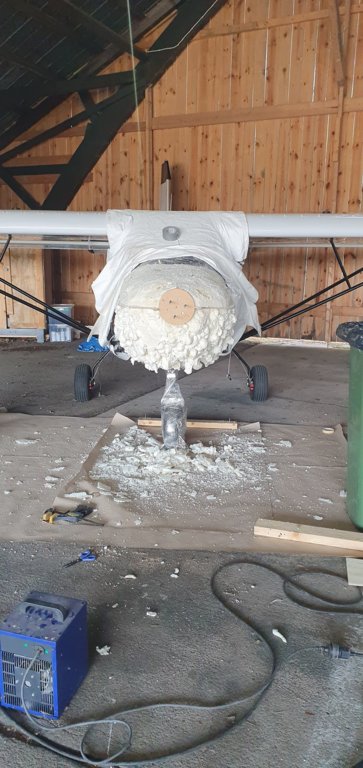

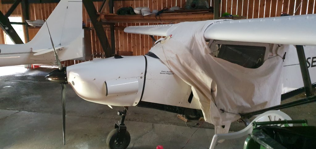

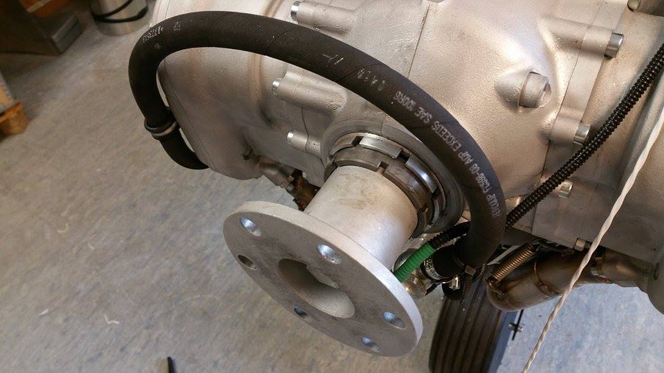

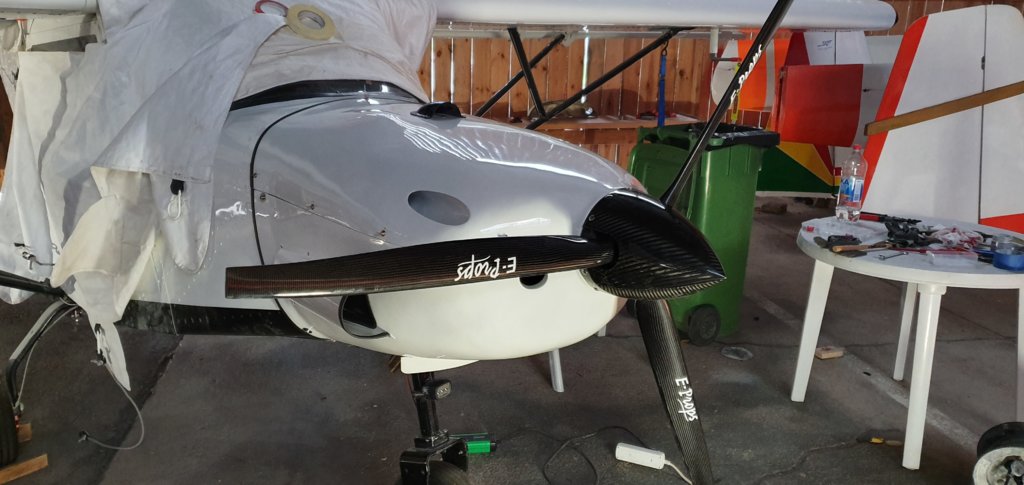

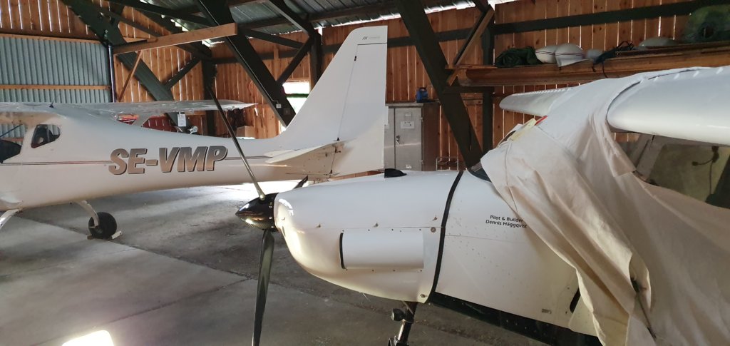

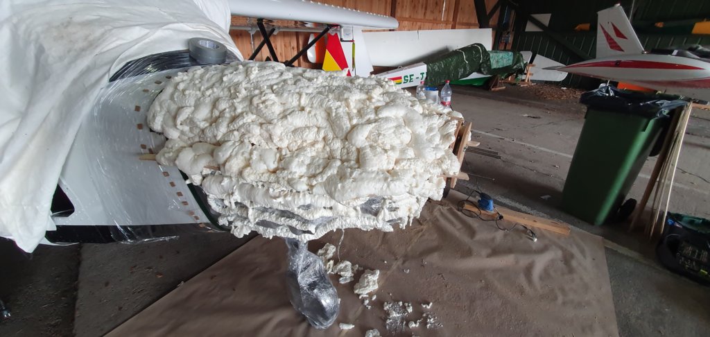

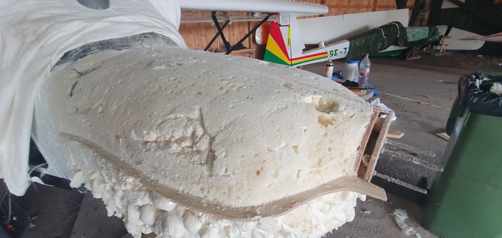

So 1½ year since last post, 2018 passsed, with a flighttesting passed and November 2018 i got my flight permit. Also, August 2018 i visited Kyle in Brisbane and got to meet his Girlfriend, thanks for letting me meet her Kyle. Ive been out visiting friends. And a new year has begun. And i have now Lengthened the propflange 3cm and started with making my own cowling. I poured foam over it and it looked like this. And then i sanded it down a bit to get a feeling, and i like it allot more than the old one that was a compromise. The Compromise cowl. Have a great day.

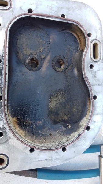

So, issue found. A brass bearing was loose and oil passed by the valves, i was the first to have this issue. Engine should be back next week.

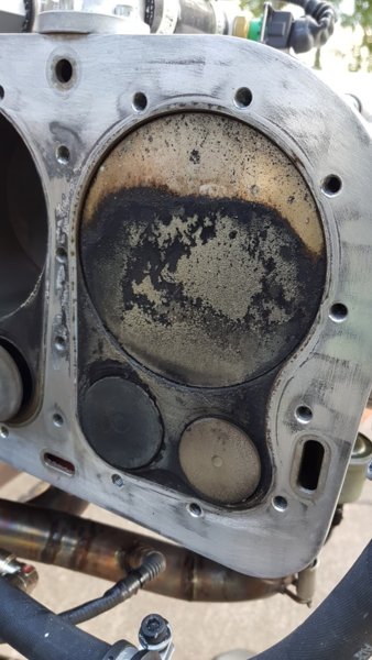

Engine is off to belgium again,oil in Cylinder 1. The dealer had a theory that when cold water from the radiators flowed in after thermostat opened made engine cold shocked so there was a crack in the cylinder, for me that sounds very long fetched. I have a Thermobob thermostat that bypasses the radiators until its heated, he suggested that i would get one that circulates the whole system at lower flow.

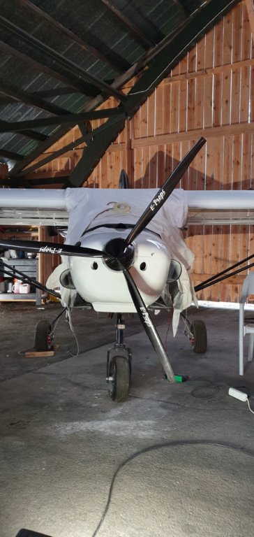

1½ hour of fault free flight... Im revving max 2800 rpm, im wondering should i change it so it revs higher? one degree less on propeller? Power torque curve.pdf Power torque curve.pdf Power torque curve.pdf
