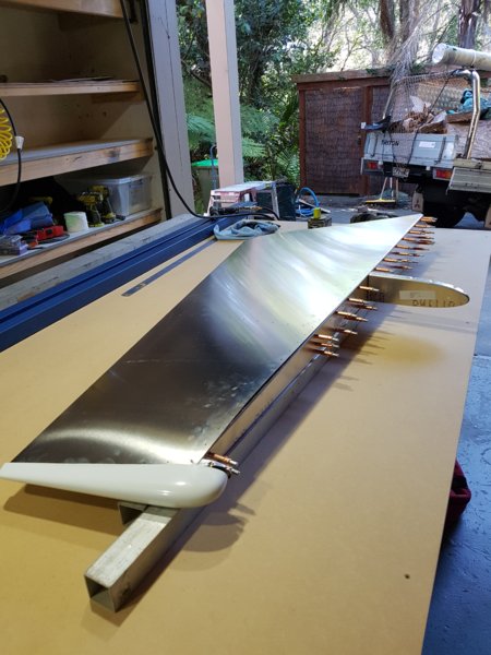

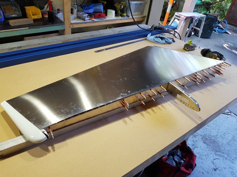

  2. Ok it's been a while, but made a bit of progress since last time I posted. I stop posting because they changed this site a bit and couldn't work out how to put pic's up! the kit turned in July I've finished the rudder, tail/ elevator with electric trim, flaps and ailerons with electric trim and half way through my first wing. So what I have learnt so far in this build is if something doesn't feel right or look right STOP ! go on the forums and ask questions and also CHECK FOR PLAN UPDATES!. My first mistake was "assumptions" One would assume that when you buy a brand new kit they

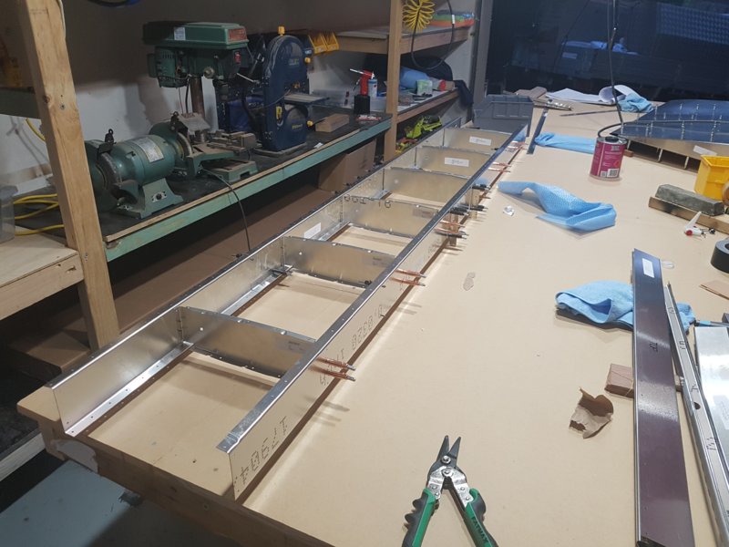

  6. Spray booth built, parts de-burred, scotchbrited { is that a word?} cleaned and wiped down, sprayed with the etch primer and riveted !!! On my way. Two small hiccups. Started to rivet and noticed I had the wrong head in the gun, riveted about 10 rivets so I'll drill them out and replace with the domed head. and second I started to rivet the leading edge skin "under the trailing edge skin, again got about 8 rivets in before I picked up the mistake. So I stopped and will remove those few rivets and install skin correctly tomorrow. At least I pick up the mistakes and rectify them I'd hate to get

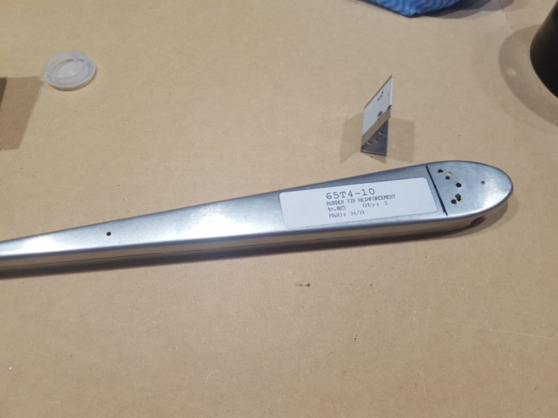

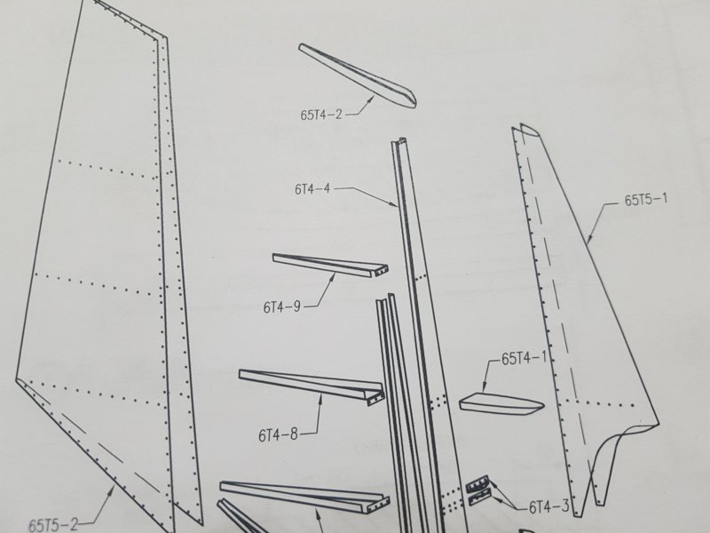

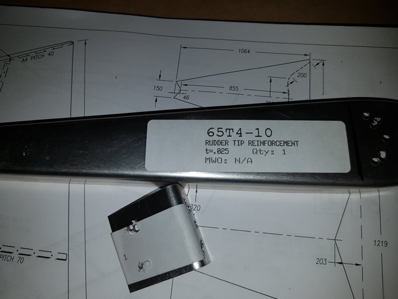

  7. So stuffed a bit already ! the top rib reinforcement, You would assume that the planes they sent out with a brand new kit would be the latest plans ? NO !!! on the plans you can see it is just the 65t4-2 top with cap, but that would mean I would have had 2 parts left over, found some other plans on the disk they gave and it shows the 2 parts and how they go on without 65t4-2 . So proceeded to install it that way. WRONG ! I've been in contact with another fellow building on and he found the most up to date plans. So now I've ordered 2 new parts! Also started on the tail, WOW the m

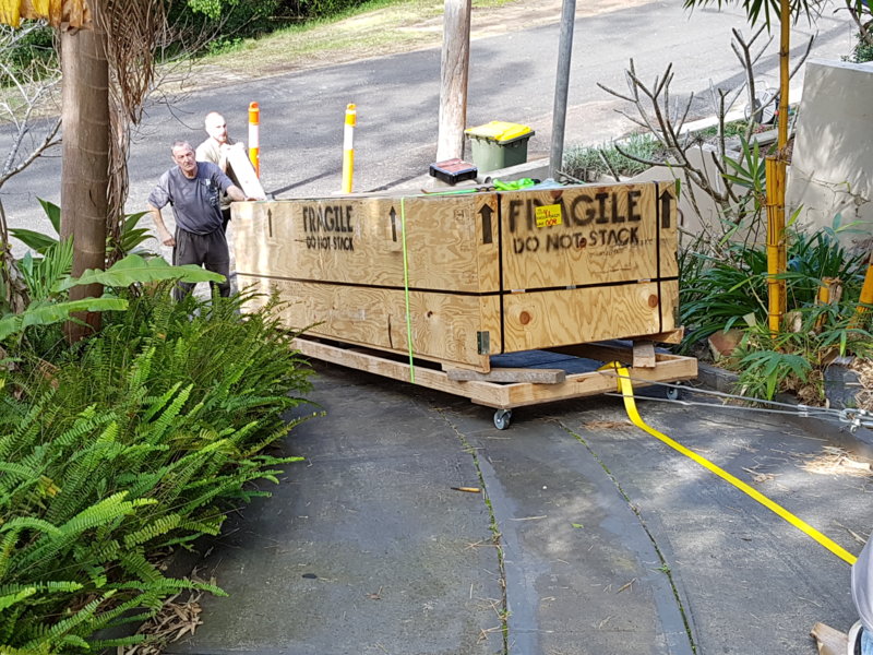

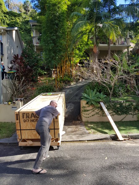

  12. Hi guys My CH650 kit arrived last week, what a job and a half getting it up my steep curved driveway up to the garage. Luckily a few of my neighbours were home and come over to give me a hand! At the moment I've unpacked the grate, made my bench and working on converting part of my outside storage shed into a spray booth. I've joined the SAAA, spoken to a few of the guys who have been very helpful. I'm probably still a few weeks away from starting the build and trying to learn and ask as many people as I can on their thoughts of corrosion protection. What is everyone's opinion on t
