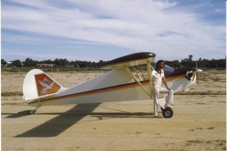

As you know from previous posts I used to own a Supa Pup Mk2 which handled extremely well with very positive controls and was easy to fly, as for performance figures that depends on the engine, mine being a Global 2 cylinder four stroke which was underpowered however I could still cruise at 70 knots.Alan.
Great pic Alan (the aircraft looks good too ;)
