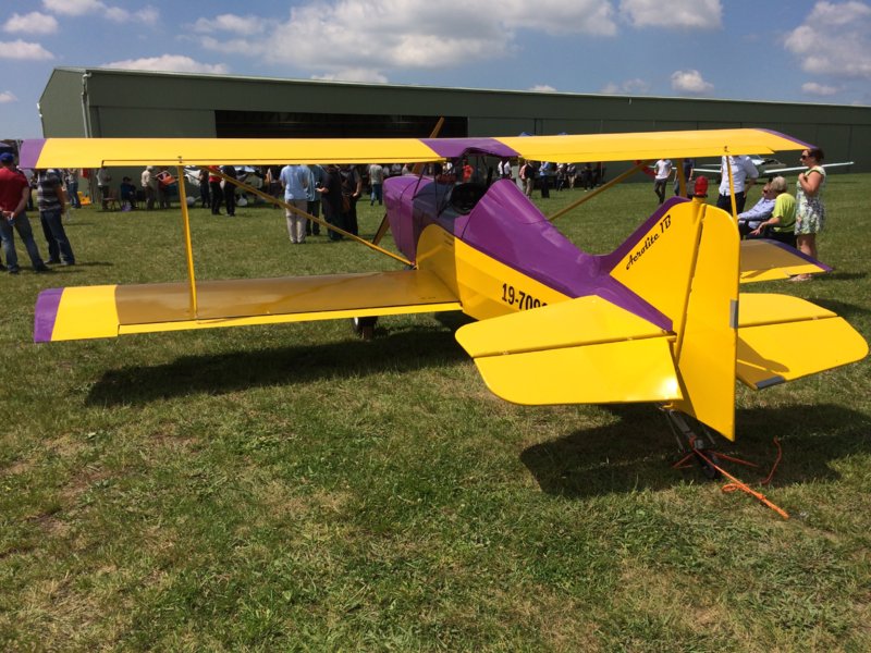

I thought I would start a new thread in here. If RA-Aus was to accept the weight increase and also bring in a Aerobatic Endorsement :ecstatic:what aircraft could be used for Aerobatics?
Would a S1 pits be allowed?
  • Replies 69
What is available for aero's under 760 Kg?
The American Champion Citabria/ Decathlon series, for a starter, which have G-meters and jettisonable door. I believe the Murphy Biplane (Renegade). Cessna 150/152 Aerobat.. Nev
