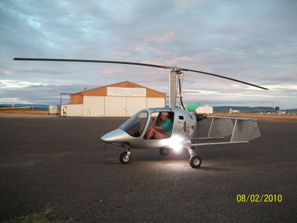

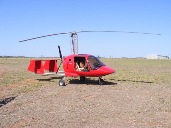

bones Posted July 13, 2010 Share Posted July 13, 2010 Be the same as this but a fraction different colour, new one is silver , loved the red but damn too hot for up here if its sitting on the ground for anylonger than 3 mins, sold it to down mid NSW, so gone for a cooler colour this time. Actually i found a pic of the near exact colour mine will be this is one of the last i delievered. Now this is a nice colour, and how assy is this that i got the strobe on too Link to comment Share on other sites More sharing options...
Guest Howard Hughes Posted July 21, 2010 Share Posted July 21, 2010 I do like the silver!:thumb_up: Link to comment Share on other sites More sharing options...
