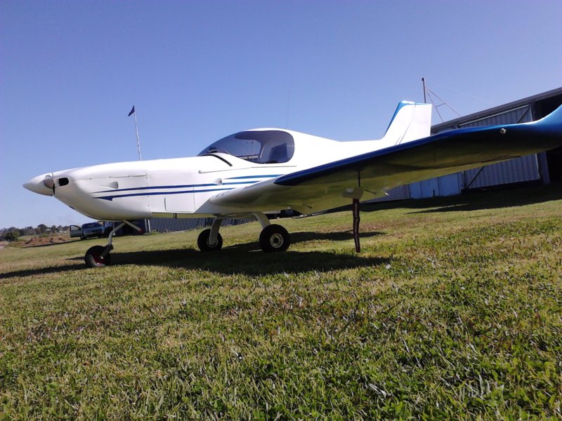

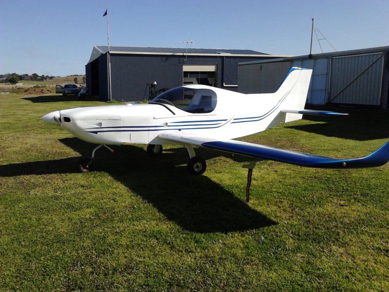

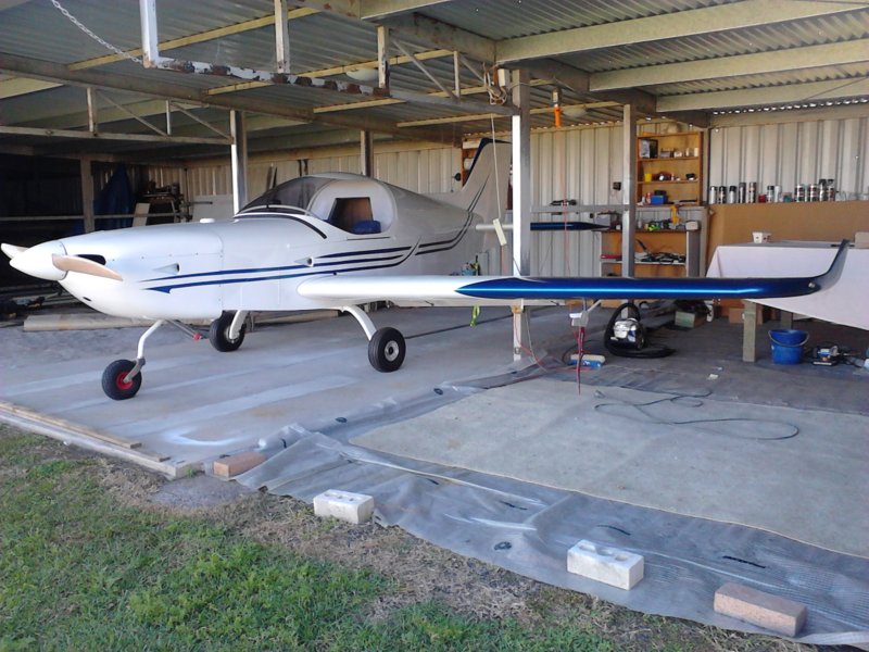

My Sierra is now in its final finished form. Now it needs a Rego & complete check over & torquing of all nuts & bolts etc before engine start, final inspection & fitting of wheel spats. Then it is test flight time. This is it.
  • Like 3
  • Winner 3
Guest asmol
Looking Good !
Is that the trim wheel between the seats on the arm rest ?
Its got to be really hard on your arm and then how do you adjust the trim with one hand on the stick ?
Maybe its electric and moves by itself - i dont know. All your shots have the nosewheel facing backwards and it looks funny, better remember to turn it the right way before the BIG photoshoot before first flight !
It is the trim wheel & it is manual. I trim hands off but it is in easy reach of my left hand if necessary. It might be hard for a fatty with a huge gut but that isn't me. It trims the whole stabilator so is sensitive & doesn't need a lot. The stabilator is fully mass balanced. The nosewheel is castoring & I didn't kick it around when taking the photos. It is always the wrong way when I winch the plane into the hangar. It has to go up hill as the floor is much higher than the surrounding area which floods.

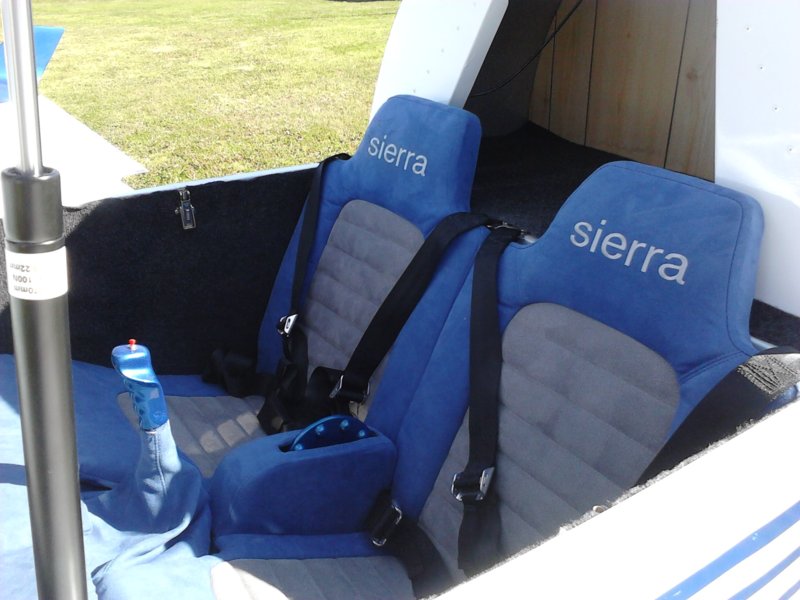

Awesome Kev, can we have some inside shots? 001_smile.gif.2cb759f06c4678ed4757932a99c02fa0.gif
See post 103. Here is the panel. The centre blank space is reserved for a removable tablet with navigation software (Avplan, Oz runways, Easy VFR). I haven't decided on which yet. When this photo was taken a few touch ups were required as well as some wiring tidied up. The switch on the left is for the Flaps & this is on the side of the throttle housing. The carb heat is below the throttle so these are in easy reach with my left hand while the right is on the stick.
See post 103. Here is the panel. The centre blank space is reserved for a removable tablet with navigation software (Avplan, Oz runways, Easy VFR). I haven't decided on which yet. When this photo was taken a few touch ups were required as well as some wiring tidied up. The switch on the left is for the Flaps & this is on the side of the throttle housing. The carb heat is below the throttle so these are in easy reach with my left hand while the right is on the stick.[ATTACH=full]39508[/ATTACH]

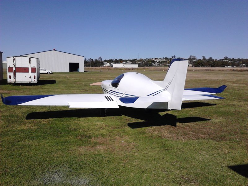

My Sierra fly's beautifully with no vices. The first flight was uneventful and even though it was an unstable day with plenty of bumps all went well though the landing left a bit to be desired. Fly's hands off straight so no need for any trim tabs. The 4 degrees of offset which looks horrible when the cowl is off means the rudder is hardly used & not at all on takeoff. Climb out with just me on board is around 1300 fpm at 80 knots. I have only had one minor issue & that was not being able to raise the flaps after I'd put a bit of araldite on the up limit micro switch tang which was prone to coming loose & had come off a couple of times. It tested OK but after leaving it for a day or so it stuck on. Easily fixed & good now. Still flying off the 25 test hours.
  • Like 5
Terrific Kevin sounds really good. I got board with the 25 hours as not much went wrong. Had to 5, 10, 15 hour tightening of cylinder heads and checking of tappits. Undercarriage bolts also needed tightening after a few landings. I also lowered the nose a bit to help with landings on the mains and giving a little clearance for the nose wheel. Since then the the landings are a breeze. Enjoy and we will come up and see you soon.

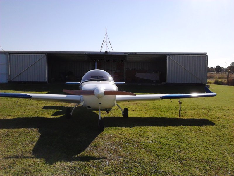

Flew down to S grafton yesterday for a lazy flight only to have met kev for the first time in unfortunate circumstances and helped him out with his beautiful looking Morgan, folded nose leg but everything else looked ok.
  • Informative 3
I have already pointed out on this forum the shortcomings of the Sierra - and the earlier model - in terms of the weak noseleg and the difficulty pilots have experienced in flaring due to the main gear being too far back - we have modded two of them here to fix these problems, and although Gary Morgan continues to deny that there are issues which need to be addressed, the evidence is there - as noted above. Despite that, as I have said, the Sierra is a fine aircraft with excellent performance.
Interesting that Graham Brown (Post #121) has shortened the nosewheel to fix the problem. Somehow I dont think that will be a permanent fix.
Mine has front suspension and was nose high on the ground so it needed to be shortened to take it back to where it suppose to be. Best to get the mains on first and then a bit of back stick left to keep the nose up. I was finding the nose wheel was touching shortly after the mains with a lot of back stick and I wanted a bit more. Has not been an issue since. Landings have been on both sealed and unsealed runways. I have nearly 30 hours in it now.
From my weight and balance my Sierra has 24% on the nose wheel. The passengers weight will reduce this and the fuel weight will increase it. I don't there is a great problem with this distribution. More to do with landing technique I suspect. I''m use to tail draggers so I don't like the nose going down!
