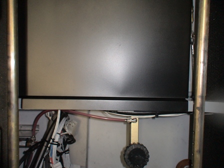

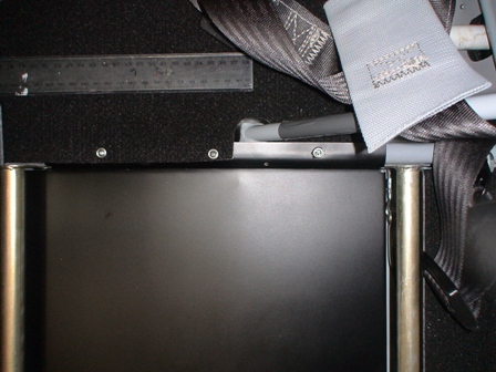

Whilst I’m very satisfied overall, there are a few things that need to be addressed by the Tecnam factory.
1) No floor plates behind the seats in the Sierra – if pens, small tems fall out of your flight bag they end up floating around in the fuselage and risk causing interference with the controls. I fixed that one in very short time by fabricating 2 floor plates out of .020" Alclad. Prime with Tempo Zinc Chromate underneath and finish the top with black satin enamel to match the plates under the seats. It’s a fiddly job and be careful not to put any weight on the baggage floor with the sheet metal screws out – it will collapse under the weight of a battery drill…almost. And don’t drill, screw or
even scratch the carry through cast spar…not ever. Forming the rear of the plate to the round cross brace means no alteration to the interior side trims - they reaffix over the top of the plate with original securing screw. Record your mod in the log book and if you hire the crown jewel for dollars it must be signed off by a level 2 or LAME.
