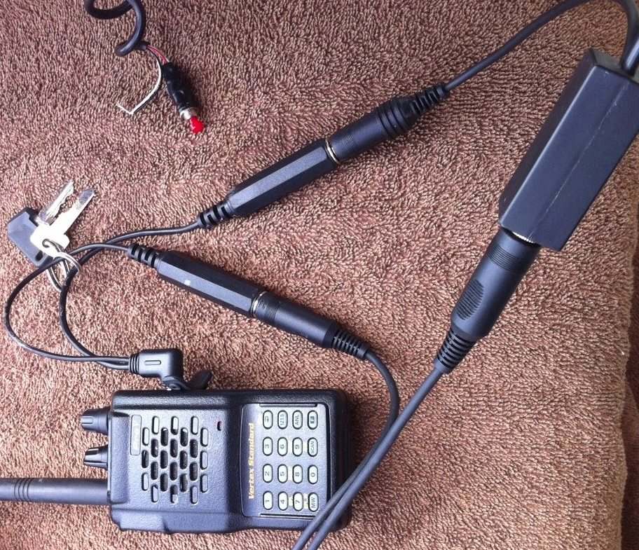

Sorry to bug you again, people, but I really need a hand with my radio...
You may remember I recently asked for advice re wiring up a PTT switch on the stick.
After reading all the advice offered, and testing the cut-off original PTT switch, I tested my plan by carefully touching together the two pairs of wires that the original switch connected. The radio worked OK so I joined one pair of wires and soldered the other through the switch.
I now get a loud tone whenever the PTT switch was pressed. This happens even when the PTT circuit is removed from the radio and only the headset is connected via the 3.5mm plug.
Just to complicate the issue, the tone does not occur when the radio is operated without the headset.
What have I damaged and how can I fix it?
Regards,
Lyle

After doing my best with the info I could obtain, it appears I may have damaged the radio. (The noise sounds like feedback, but only happens when the headset is connected. Fitting a different headset does not remove the noise, no does adjusting the volume or removing the headset from proximity to the radio.

Beyond the noise is the head set working... can you hear and talk with it?
Photos might help us resolve the issue 026_cheers.gif.2a721e51b64009ae39ad1a09d8bf764e.gif

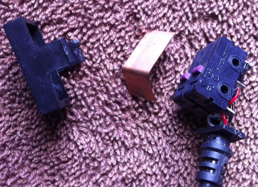

Thanks Tex. That sounds like a workable solution. I don't have a nearly radio to test my reception against, but it appears that despite the noise while transmitting, it still works OK.
Have you any ideas what exactly would have caused the noise?
Two pix: original PTT, and the current setup, with new PTT at top of pic.
