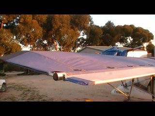

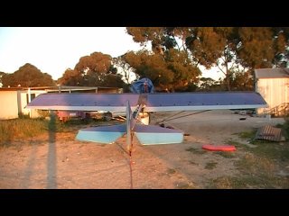

Hello, I own and fly most mournings my T83, single seat ,I ussaully fly first thing in the mourning and have logged up close to 20 hours in it. I have noticed previously lack of ailron responce and last week took off for a day flight 1.6knt wind but 32 deg,after take off I was hit by some mean weather and forced into a left hand back in which I applied full right ailron with no responce and full right rudder and full power ,after turning 240 DEG I managed to level out and land back on the runway safely...On inspecting the ailrons I descouvered the inner supports worn(rivetts and holes ovalled) I then repaired with bushes and fibreglass and made them back ridged...I took off today for a test<weather 24deg,overcast, 0knt wind>
again after take off hit rough air so made a turn left only to descover no ailron responce?(55knt ASI) full rudder applied and she just slipped,any way made a safe landing and inspected ailrons and all good? no movement,skins taught? any one fly a T83?how dose it handle? and is your tail flimsy? can rock my tail and the boom flexes a fair bit..Im sure the single thruster are ment to handle well? mines good if the air is still and dence .. but when the wind hits you have the stick pushing into your leg holding it level and have to use the rudder to level back out,,,,,,,THRUSTER1.jpg.c11e10efdcd9590add785074b956b8fb.jpg any help please?

Hang onto the aileron outer tip and have some one work the stick. See if they or the wing twists. There may be enough slop in the wing aileron to cancel the aileron. rigged correct, more down than up? Push rod or teleflex cable on your model? If teleflex make sure it has not seperated from the outer housing. Wing covering laced nice and tight. Gap cover on? Might be time to remove the wings and take off the sails and do a through inspection. A little bit of slop and wear over the entire sytem can add up to cancel out things.
Ozzie
Hang onto the aileron outer tip and have some one work the stick. See if they or the wing twists. There may be enough slop in the wing aileron to cancel the aileron. rigged correct, more down than up? Push rod or teleflex cable on your model? If teleflex make sure it has not seperated from the outer housing. Wing covering laced nice and tight. Gap cover on? Might be time to remove the wings and take off the sails and do a through inspection. A little bit of slop and wear over the entire sytem can add up to cancel out things.Ozzie
the ailerons are all push rod. I will have the missus help me (when she gets outa bed!!) with the stick and check for warping,and check if more up than down?vissa versa..wings are laced tight and wing gap cover tight and sealed nicley. will check wings also for warping.. thank you will let you know if anythings not right.076_joystick.gif.1d2ed07889352a966338f6390696faff.gif
Think ozzie might be onto something there. It's called aileron reversal. If the wing is weak in torsion the force of the deflected aileron will warp the wing cancelling out it's effectiveness. I've seen some "rubbery" quad city challengers that do this and they are not safe in that condition. When that happens you pretty much have to control it on rudder alone (for roll).. Nev

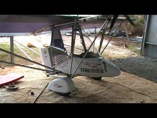

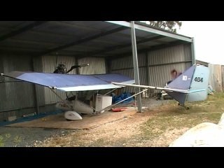

yep looks like it? was told by certain level 2 inspector that the strutts where they join the leading edge and trailing edge stainless brackets are ment to have play?????????? unfortunatly this is INCORRECT and the result has worn the strutt end bolt attatchments which now have a bigger gap and 1 is uneven....so have just finished shimming them and TIGHTNING them and wings are a hell of a lot more ridged...also aileron control push rod bolt holes worn so made some nylon bushes..now no play in the ailerons,,will now look at moving the aileron pushrods up to the other hole(other holes have very promanant washer markings indicating pushrods where once in them holes)..ill give it a thourough inspection with the missus moving the stick and see what happens? then will have to wait till saturday by the look of the weather for a flight test:helmet:
All finished and ready for a test! everything is nice and tight now,also moved push rods to the upper hole which not only pulls them down a couple of mill but also gives you more stick .......same stick travell=more aileron movement..we,ll see how she goes and keep you updated.
I never liked those strut wing attach brackets that are made of stainless. If i had a Thruster of any type today i would make up some safety straps using SS tangs and short cable and fit one end to a strut fitting bolt and the other to the wing strut attachment bolt. That way if the bracket failed like they have done previously the strut will still stay near where it should be until you can land.
these are the newer brackets that are spot welded and not seem welded as the ones that faiedl ,they have been replaced, but I agree and have done (made up safety cable prevously) also tail has extra safety wires holding it to the boom should the tiny thin stainless toungues that are welded one side break .the tail will still be held in place...safety first.....keen to see how she performs this time as long as the weather has no suprises???? Ive been thinking about its roll performance and can best describe it as if it were attatched to a bunggy cord...you move the stick to say the left then wait for the plane to slowly bank then move the stick to the right fully and ever so slowly she rolls back level..

.stick just sat centered. stick very stiff but very sensitive.....did not need anymore than a 1/2 an inch either side compareed to a foot either side pushing into my leg...work done: all aileron controls re bushed and tightened,Ailerons supports fibreglassed All skins re-tightened,stick control rod bushed and tightened,wing strutt ends to leading and trailing edge bracketts shimed and tightend ,flew streight with stick centered,and turbulance was no match for the trusty thrusty....very impressed with its handling Now...it may even make the bridge now ....
