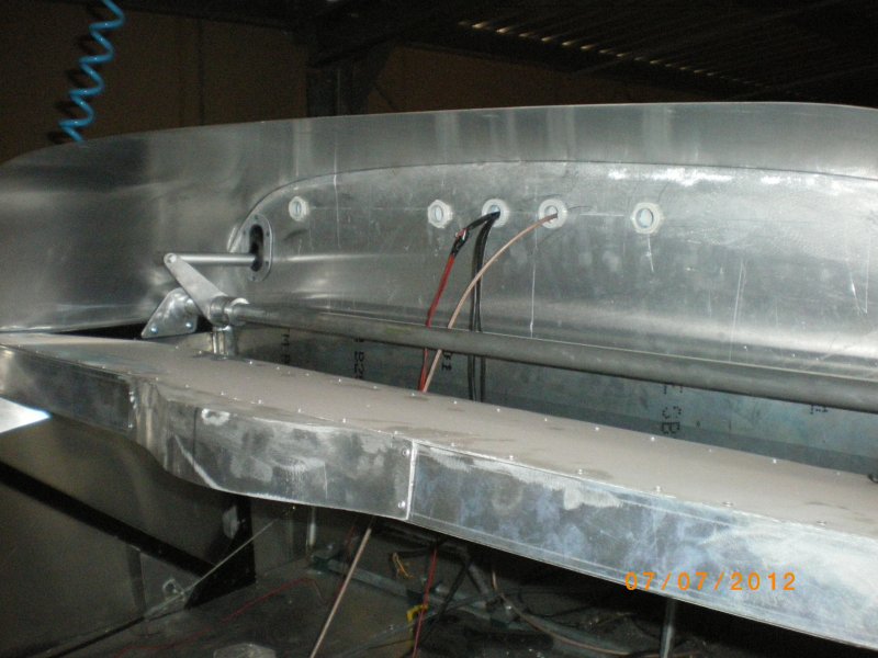

gareth lacey Posted July 8, 2012 Author Share Posted July 8, 2012 Hi Kevin Thanks ,yes the conduit over the tank is for electrical wiring, dual throttles engine probes heat probes,remote brake master cylinder etc and any other things we may put in . how is the wing build coming?any problem in the building of these? we should start our wings after we fit the canopy (next week pick up) our canopy is tinted and wider than normal i just hope that we get it right first time!! any way cheers for now Gareth Link to comment Share on other sites More sharing options...

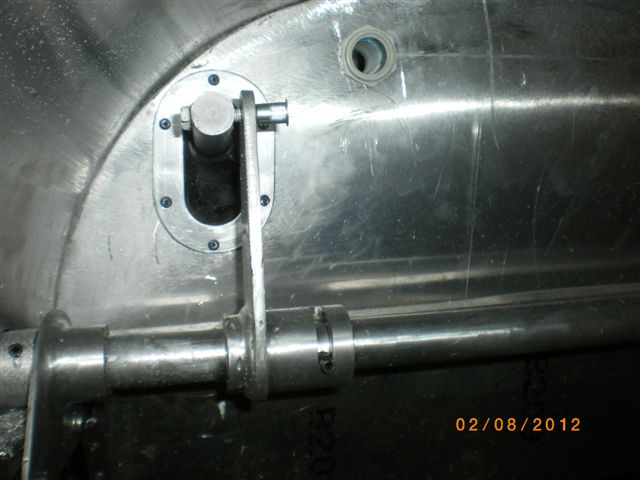

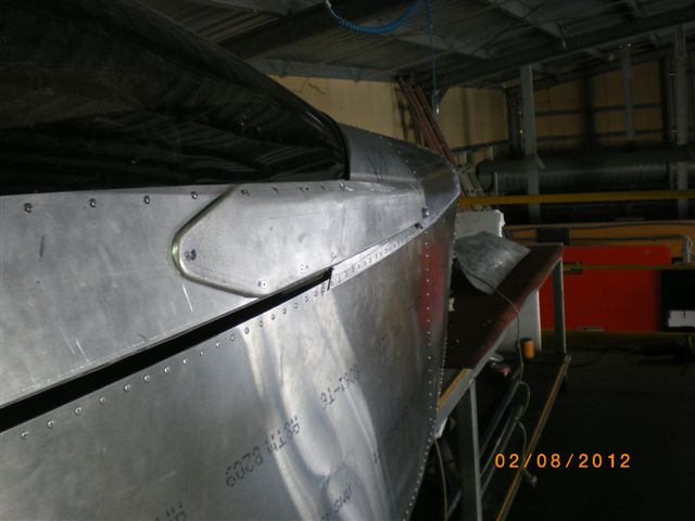

gareth lacey Posted August 2, 2012 Author Share Posted August 2, 2012 Hi Guys here as some progress pics and vid (i hope i can attach) pic 1 is actuator mechanism for canopy pic 2 is actuator canopy side arms vids Link to comment Share on other sites More sharing options...
gareth lacey Posted August 2, 2012 Author Share Posted August 2, 2012 for all you weight concious people we added 1.7 kilos for the actuator and mechanism all aluminium wew have a video of the canopy opening but i cant seem to load it ,anyhelp ? cheers gareth Link to comment Share on other sites More sharing options...

gareth lacey Posted August 4, 2012 Author Share Posted August 4, 2012 actuator swing bar and cam Link to comment Share on other sites More sharing options...

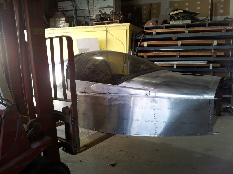

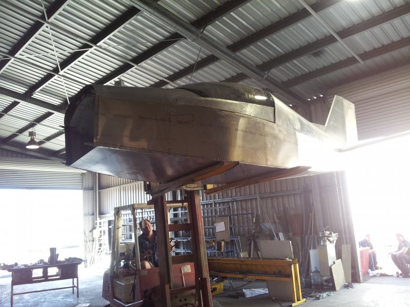

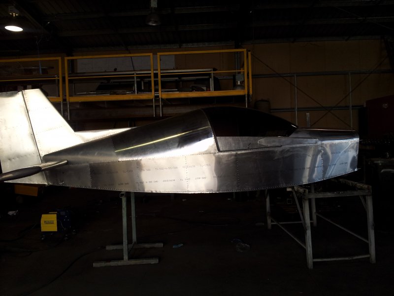

gareth lacey Posted August 16, 2012 Author Share Posted August 16, 2012 Hi all finally finished the canopy fitting, canopy fits the bulkhead perfect,safety locking mechanism is concealed in the side canopy arms, and it is now down off the mezzanine ,starting the wing spars today below are some fuse pics Link to comment Share on other sites More sharing options...

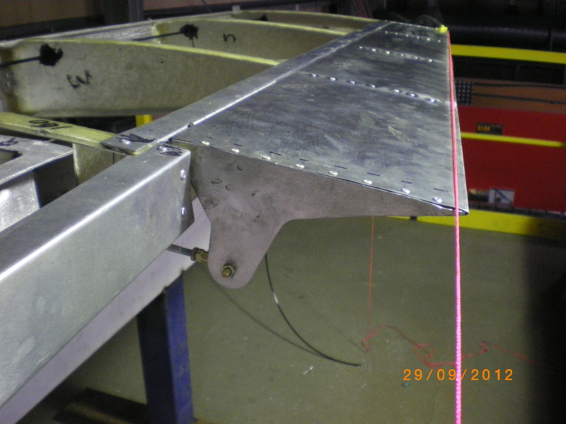

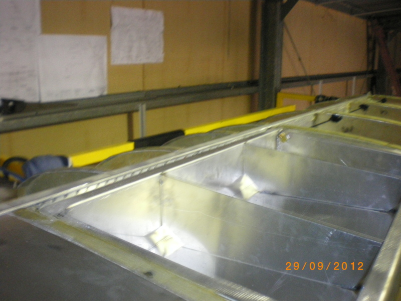

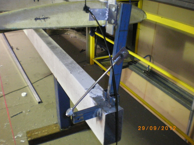

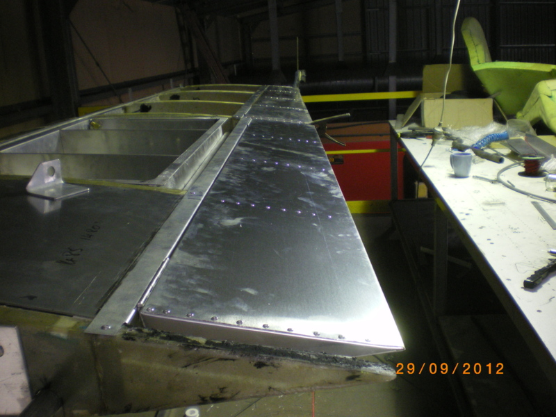

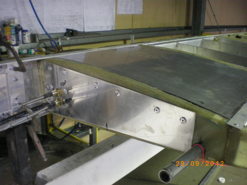

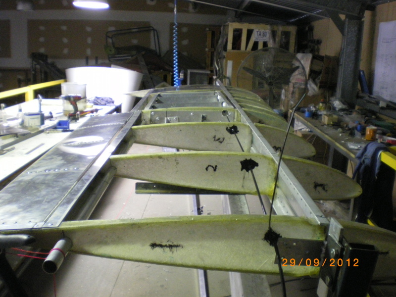

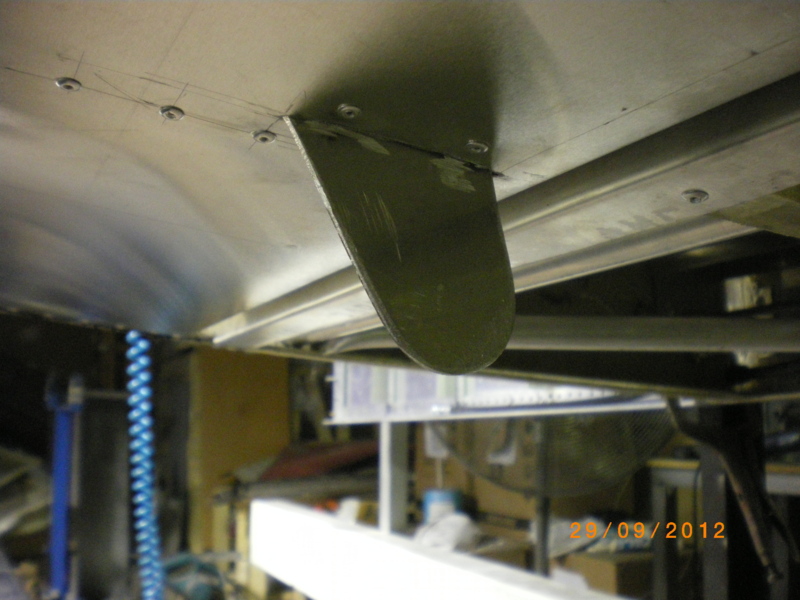

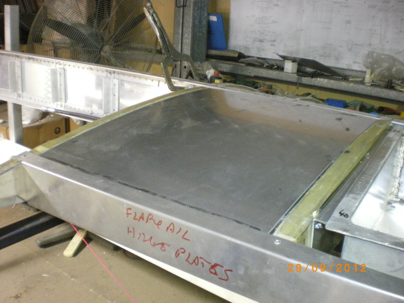

gareth lacey Posted September 29, 2012 Author Share Posted September 29, 2012 Hi all here are a few picks of the wing /strut build for the sierra the beam jig to hold the strut and the simple adjuster to set the washout aileron horn alum wing walk/step flap,aileron cables through no 7 rib and fuel line flap and aileron fitted alum 30 litre tank tank vent pipe through to wing tip control horn through flap skin(bkt is internal fixed to rib) the alum tank and wing walk plate with stiffeners weight came to 7 kilos,offset that is less fuel ie less weight next is to skin cheers all Gareth & CRaig Link to comment Share on other sites More sharing options...

Runway Posted October 2, 2012 Share Posted October 2, 2012 Hi Gareth The plane is looking good. Was there a reason for going for metal wing tanks over Garry's fiberglass tanks, and did you make them? Also, did you have trouble routing the aileron cables around the tanks? We did, but perhaps your cable was longer. Jeff Link to comment Share on other sites More sharing options...
