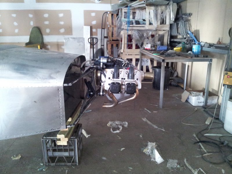

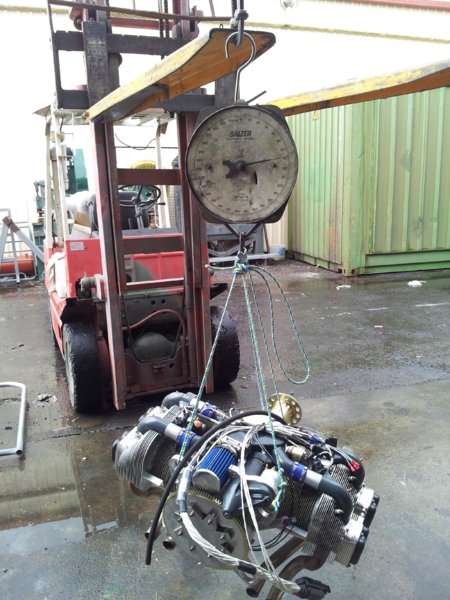

Hi allhere vis the UL 130 engine just arrived and the engine weight 70 kilos ,no oils or fixtures ,all parts in box 5 klilos
Lookin good Gareth. I have just put a UL Power 2601s (107hp) in my sierra, the only hassle is changing the fuel line size and adding a return to the tank.

our fuse was for a 3300, but we are a wider fuse (1200 inside cockpit) this in turn made our firewall 75mm longer (2x100kilo pax) as for w&b our UL is 76 kilo same as the Jab 3300 so no problems there and lots of GRUNT

Hi John,I have the 107hp motor and according to the specs it weighs around 72 kg's. The installation is fairly straightforward and if you talk to Garry M he could work something out,If you and Gareth want some Pic's send a PM with your email address.

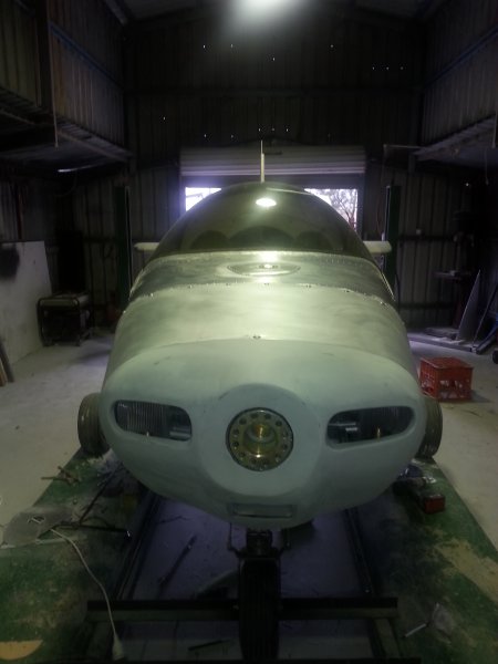

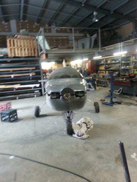

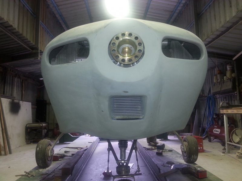

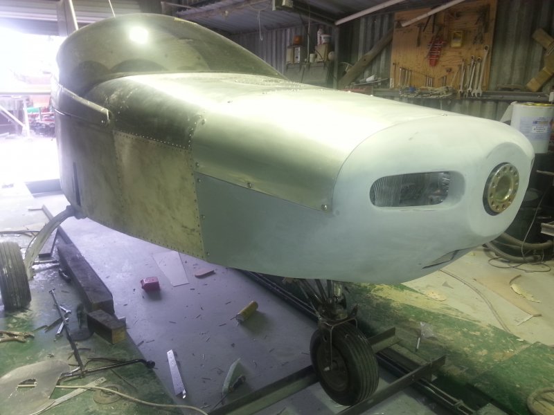

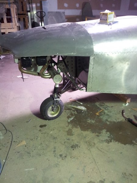

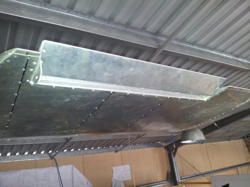

we have made the top of the cowl alum for easy removal, bottom of cowl was Garrys fibreglass cowl but we had to cut and shut it to fit

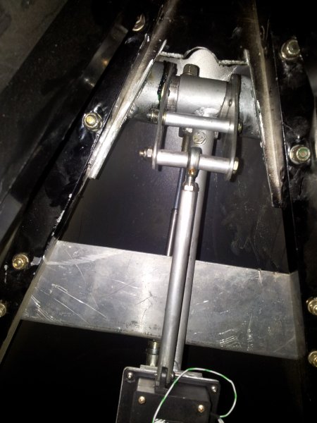

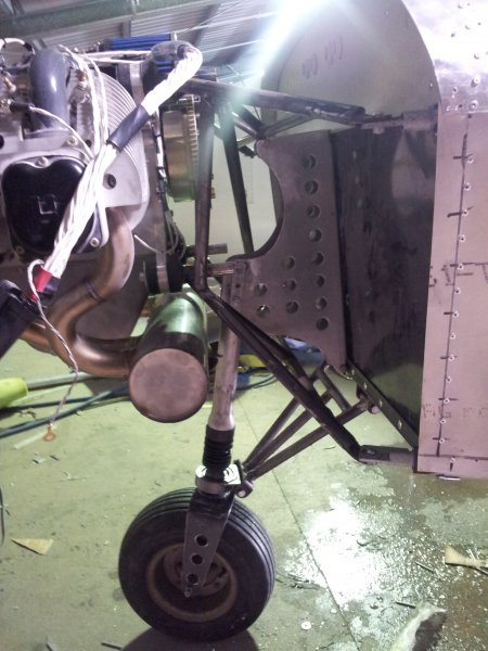

sides of fusalage at firewall is removable both sides this gives us complete access to brakes ,fuel pumps steering mechanics, tank fittings

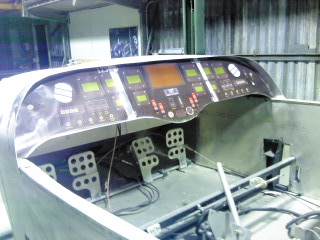

next week start preparing for painting , avionics are being wired and the upholsterer will be starting cabin fitout
Cheers gareth& Craig
back againwe have made the top of the cowl alum for easy removal, bottom of cowl was Garrys fibreglass cowl but we had to cut and shut it to fit
I see the lower cowl is attached to nose bowl ,bad move as you will need to remove prop to service engine,have modified several cowls to overcome this oversight
Mick W
