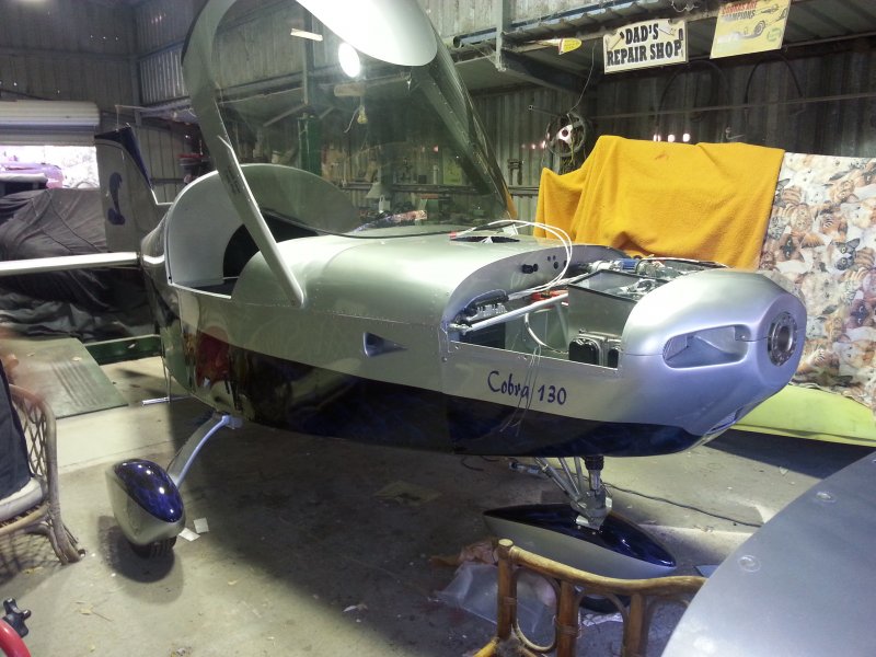

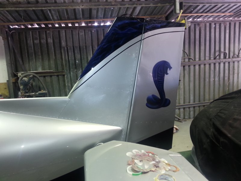

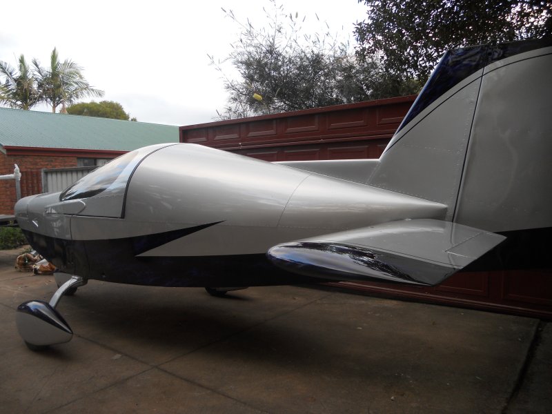

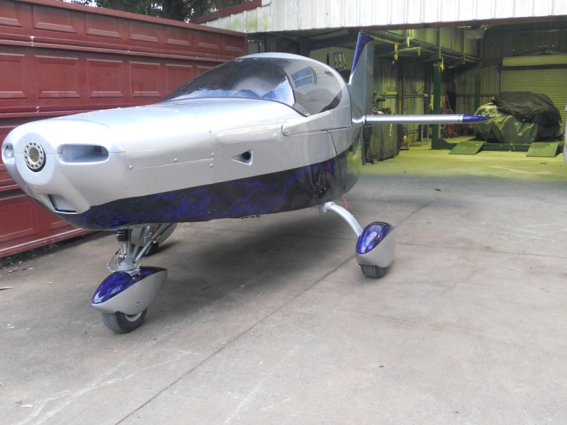

all the kudos goes to Craig ,he did all the painting ,i just helped with the prep of bodywork, the airbrush work was done by a young artist ,we are well pleased with outcome, a couple more epics ,we sat in today and made aeroplane noises LOL still waiting on prop those yanks are so slooowww

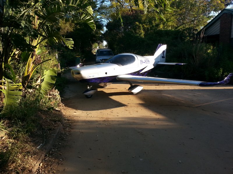

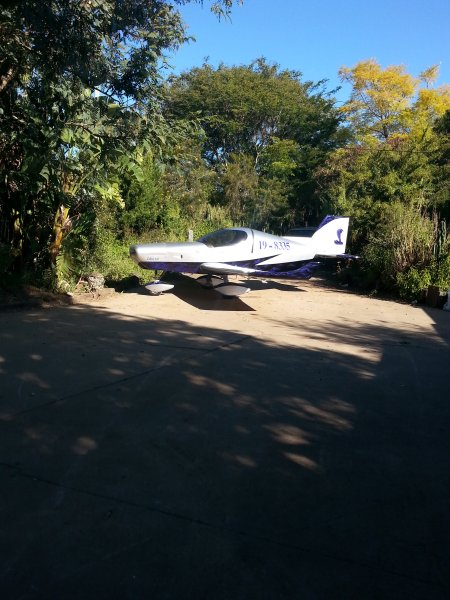

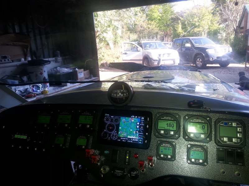

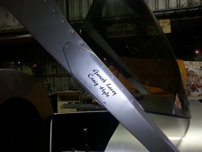

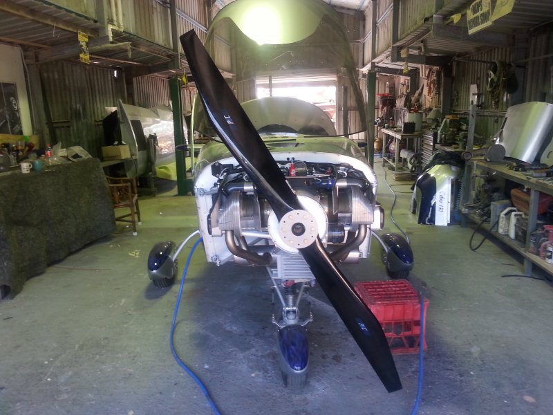

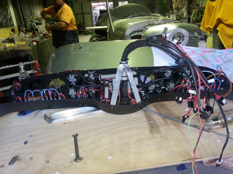

Well, its been a long time coming (the prop that is ) the prop arrived wed ,and i installed today ,all electrics finished (thanks Mark,Kyle communications for your help) the fuel system is all finished panel was lit up today final bolt check up so close ,we are both away for 2 weeks , counting down ,here are 2 pics

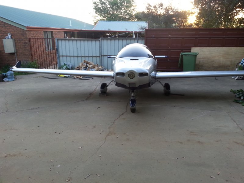

well ,sat we filled the UL with oil, tied the fusalage to a post and fired up the motor ,at idle 40 psi,at full throttle 55 psi all temps in the low range , the engine starts first pop ,being fuel injected easy start, it is a sweet sounding engine , prop balanced, no vibrations at all , the toe brakes need very little pressure to hold it ,even at full throttle all fuel lines no leaks , all electrics and gauges work final fit up and transport to get our test pilot to get it in the air ,so close ,but no rush (a little bit exited though) and we also have a hanger now .

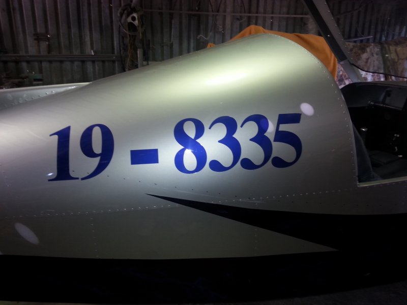

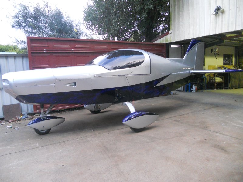

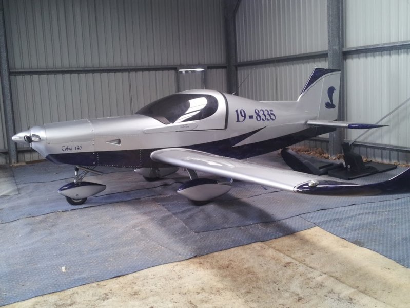

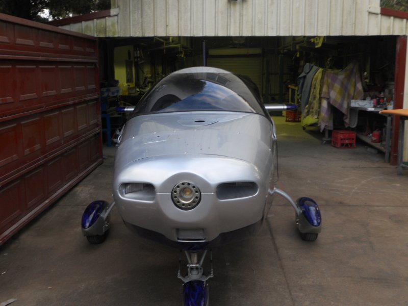

Here it is finished and signed off by LAME will get paperwork off this week

Hi Mags
thanks for that , we have run the UL a no of times it seems that there is plenty of power to spare , but time will tell , we have confidence in the engine , all temps and pressure are in tolerences and the prop looks to be a winner , we are still waiting for paperwork to come back then we set a date for our test pilot to fly , we will be doing a few h/speed taxis ourselves to make sure the tracking and rudder imput is all good , we have just made a new bonnet for the engine , we were not happy with first one should be soon for that day , getting exited for that day , will take onboard video and outside video for posting
