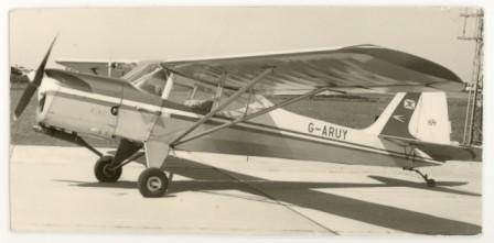

Guernsey Posted May 18, 2012 Share Posted May 18, 2012 I would allow the aircraft to slip down through the winds and ride them back up again over and over. Was never usually much more than a few hundred feet of altitude in the ups and downs and flying with them was so much more comfortable! I used to fly an Auster years ago and found that the Auster just loves to fly on its own, ride the waves and generally have a good time without any input from me. Long live the AUSTER. Alan. Link to comment Share on other sites More sharing options...
Louis Moore Posted May 18, 2012 Share Posted May 18, 2012 Mine was built in 46 and still going strong, so there hard to kill Alan! Link to comment Share on other sites More sharing options...
