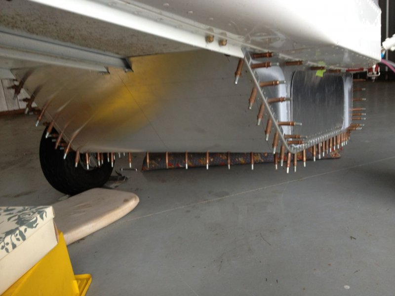

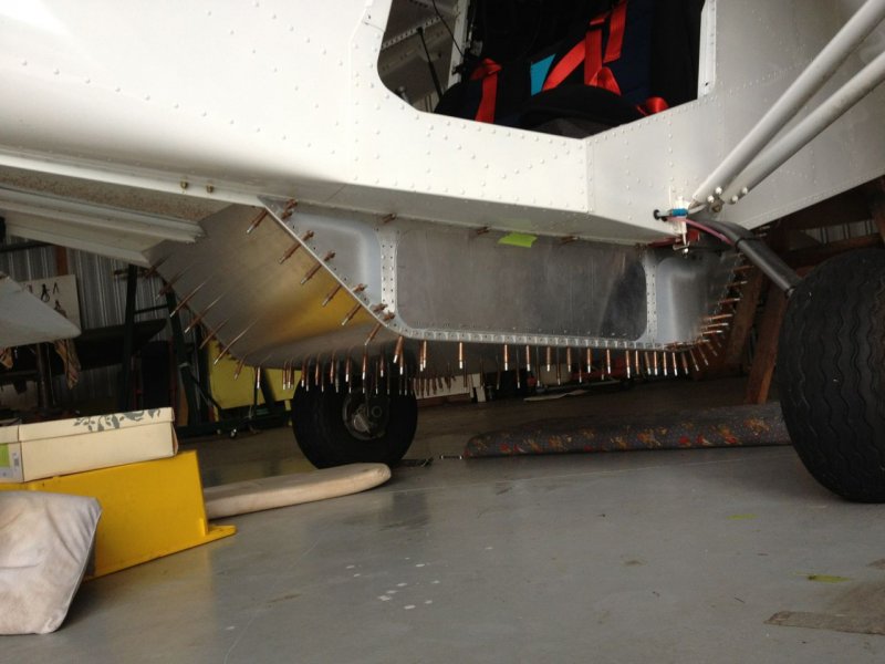

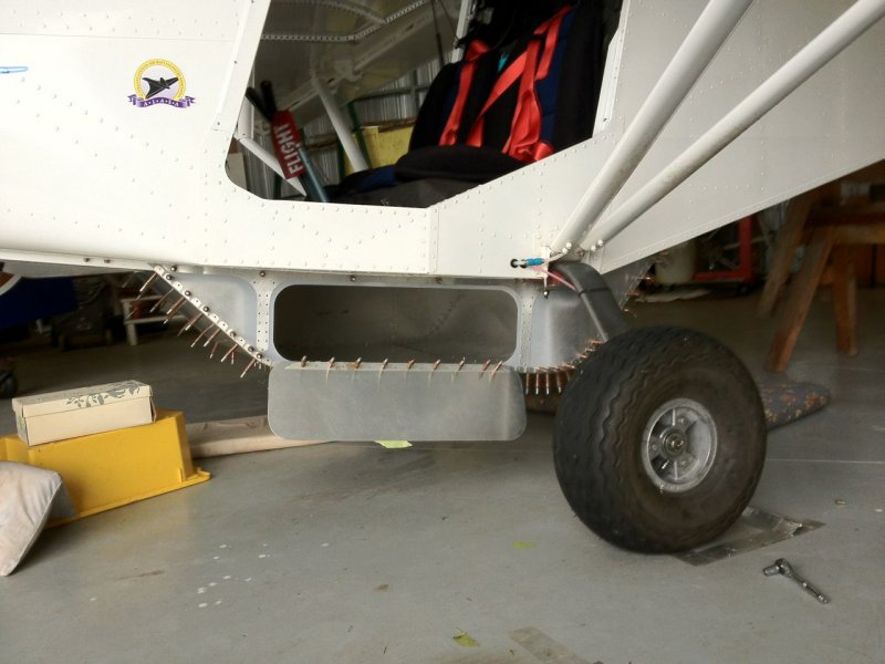

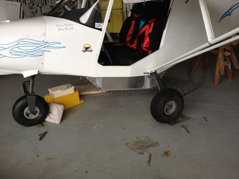

Kyle Communications Posted June 24, 2013 Share Posted June 24, 2013 Steve Donald has made a belly pod for his and the weight is all under the CG and he only loses about 1 or 2 knots max Link to comment Share on other sites More sharing options...
Kyle Communications Posted June 24, 2013 Share Posted June 24, 2013 hahahah your a funny buggar Steve.....I wish I was your weight but some of us are not blessed with skinny genes Link to comment Share on other sites More sharing options...
rankamateur Posted June 24, 2013 Share Posted June 24, 2013 Maybe this increase in MAUW will make the belly pod a useful option to enable some of the increase to be carried as baggage etc? I see in the USA andIitaly they are offered as a factory option. The belly pod from the factory is available in Australia too, just not ex-stock, they would put what ever you want in the box for a special order kit, just that stock kits don't come with a belly pod, and a belly pod, would have to be ordered specially because not too many people want one. Link to comment Share on other sites More sharing options...
eightyknots Posted June 25, 2013 Share Posted June 25, 2013 ...... some of us are not blessed with skinny genes These people seem to be: Link to comment Share on other sites More sharing options...

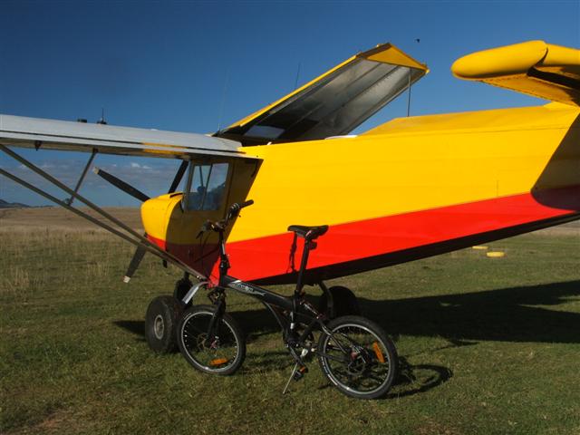

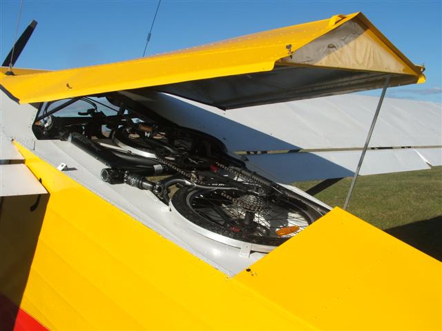

eightyknots Posted June 25, 2013 Share Posted June 25, 2013 Steve Donald has made a belly pod for his and the weight is all under the CG and he only loses about 1 or 2 knots max It seems hard to believe that the speed penalty is only 1-2 knots when you consider that there is about a 45 degree angle slope at the front of the belly pod. I still like Forum member JG3's modification to the classic Savannah which allows him to carry a bicycle around the country. The only difference is that it is above the plane not underneath it. This mod doesn't seem to be possible in the XL or S. Here are two of the pictures from his stolspeed.com website: Link to comment Share on other sites More sharing options...
