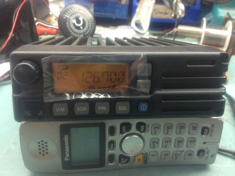

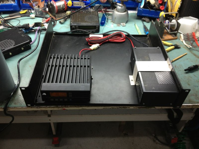

Kyle Communications Posted October 16, 2012 Share Posted October 16, 2012 Just to update things on the simplex repeater. I ordered a new Icom IC-A110 to use for this as it is easier to interface to the simplex repeater unit. It is a base/mobile unit and it will fit in a nice Icom case with power supply so will be a good package to stick in the corner of the shipping container at the repeater site. The simplex module is now wired and programmed and all seems to be working although I am setting the levels in and out for it at the moment. These are programmed into the module using special digital filters internally in the module. I got it all going last night but found if the modulation into it is high it becomes a bit intermittent for retransmit of the audio hence the necessity to set all the levels. This unit is normally used for FM not AM ...I think this is why it is a little more critical. I should have this done today or tomorrow. I will put a dummy load onto it and set it on 118.8 here and see how it goes with the on air signals. If all is ok next week I will apply for the licence and when that comes through I will site it up at Ocean View and see how it performs Mark 2 Link to comment Share on other sites More sharing options...

Kyle Communications Posted October 18, 2012 Share Posted October 18, 2012 I have finally finished fitting , programming and initial testing of the simplex repeater. Its been a bit of a mission doing it with AM radio rather than FM I had a lot of issues trying to get the levels correct and to get a fixed muted audio level. I gave up in the end and am using the headset port in the radio and made some mods to get it to work and sound correctly. Just finished some testing here tonight on the bench by recording the ATIS and letting it play back....sounds pretty good...it sounds transmitting back exactly the same as how the radio receives it. I will play a bit more with on air radio calls tomorrow I have to be quick once the mute opens and switch the radio into a dummy load before it starts to transmit other wise they will hear themselves come back I will try to not let that happen.. I will test it for a few days and then if all goes well I will apply for a frequency. That will probably take 2 weeks or more and I will get everything up at the repeater site...I have a airband side mount dipole that can be mounted on the top of the container .You cant see anything as it is all mounted inside the radio Mark 2 Link to comment Share on other sites More sharing options...

Kyle Communications Posted October 20, 2012 Share Posted October 20, 2012 I am currently uploading a video to youtube to show the operation of the repeater. The IC-A110 is the repeater I have this connected to a RF manual switch. One side is to a antenna and the other side is to a dummy load. The video starts with the switch to the dummy load which of course there is no signal to the repeater. Once I switch it to the antenna because the squelch opens it starts to record what is said. I put it onto the ATIS and I get a 90% fully quietened signal here I leave it on the antenna for around 30 sec then switch it to the dummy load. The squelch then closes it waits 1 second then start to transmit on the same frequency but because I have it on a dummy load now the signal does not go out to air but it is heard locally in my workshop on the A200 I have here in the workshop which is what I listen too most of the time. It obviously has to be on the ATIS freq to hear the A110 transmit Mark Link to comment Share on other sites More sharing options...

Kyle Communications Posted April 9, 2013 Share Posted April 9, 2013 The bandpass cavity arrived from my mate down the Gold Coast this afternoon. I will see if I can get it installed later this week or on the weekend. A couple of pics to show the unit in the rack tray and the size of the cavity Mark Link to comment Share on other sites More sharing options...
