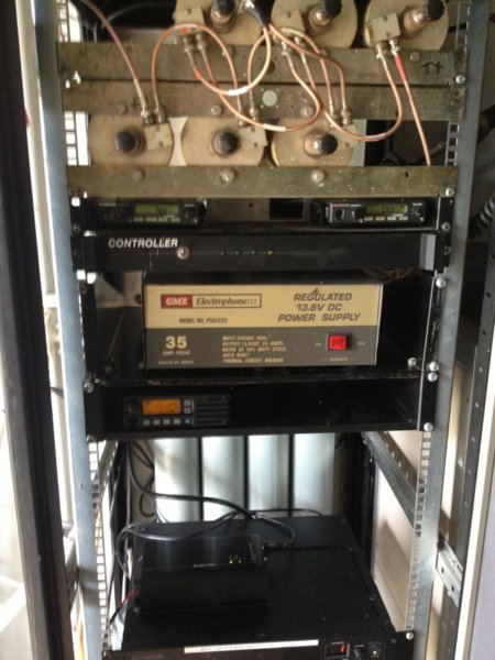

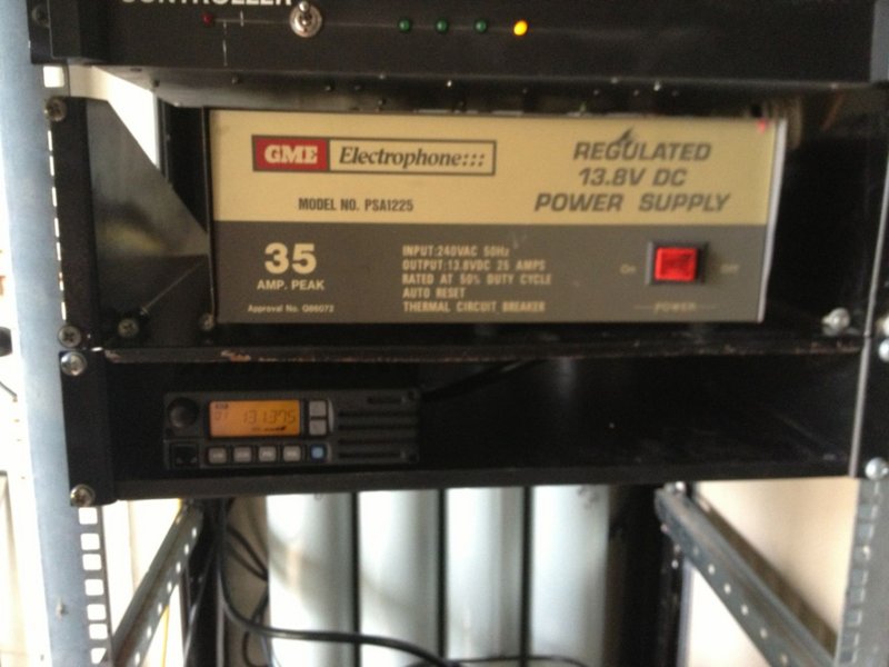

eightyknots Posted April 11, 2013 Share Posted April 11, 2013 The bandpass cavity arrived from my mate down the Gold Coast this afternoon. I will see if I can get it installed later this week or on the weekend. A couple of pics to show the unit in the rack tray and the size of the cavity Mark In January, my dentist told me I had a h-u-g-e cavity and he charged me quite a bit to fill it. But the bandpass cavity is really large! I hope all goes well with the installation, Mark Link to comment Share on other sites More sharing options...

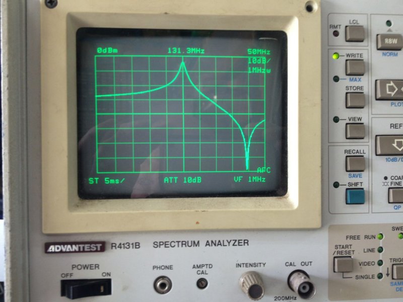

Kyle Communications Posted April 11, 2013 Share Posted April 11, 2013 Here is a pic to show what a bandpass cavity does. Basically it creates a window fr the radio transmitter this protects all other radio services above and below of it the high point at the top lets the receive and transmit signals pass the sloping down sides at the left and right correspond to frequencies above and below the actual transmit frequency of 131.375 mhz Link to comment Share on other sites More sharing options...

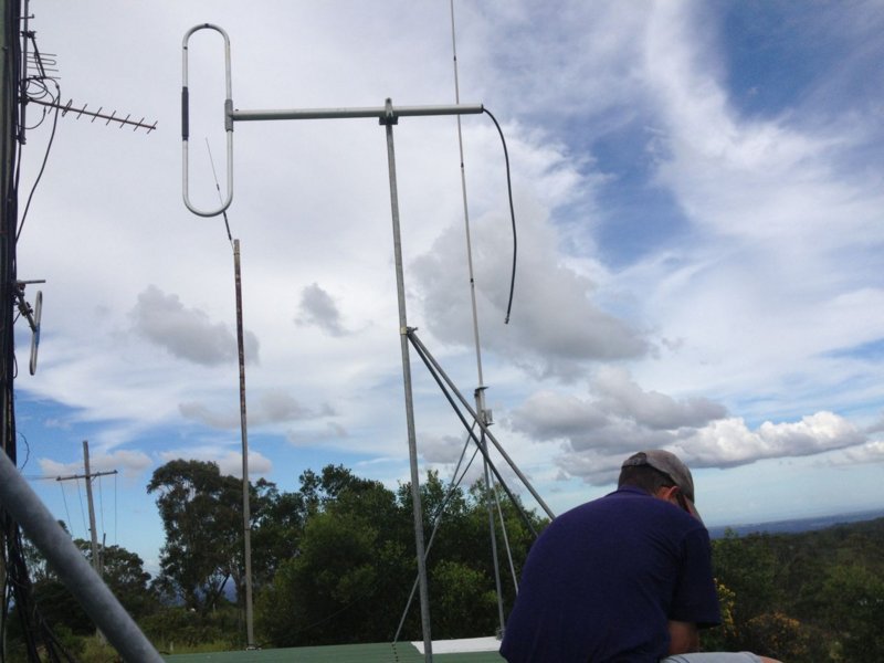

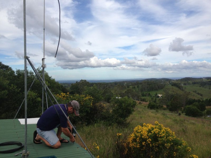

Kyle Communications Posted April 14, 2013 Share Posted April 14, 2013 A few pics of today doing the install.....the one with the edge of the container look hard and you will see the "visitor" we had while doing the install...his name is Joe Blake the red bellied black snake...I think he thinks he is the guard dog there Link to comment Share on other sites More sharing options...
