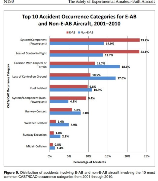

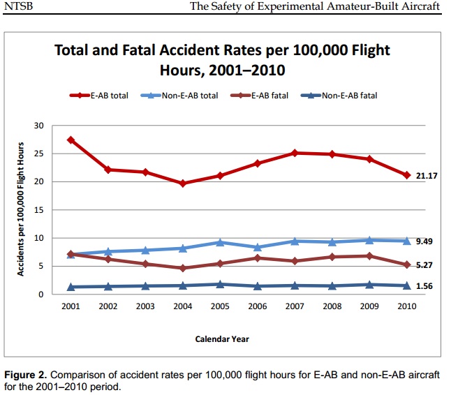

djpacro Posted February 7, 2014 Share Posted February 7, 2014 David, that's a big call, to say that certified aircraft are safer than non certified ! Any facts to back this up or just an opinion ? Link to comment Share on other sites More sharing options...
