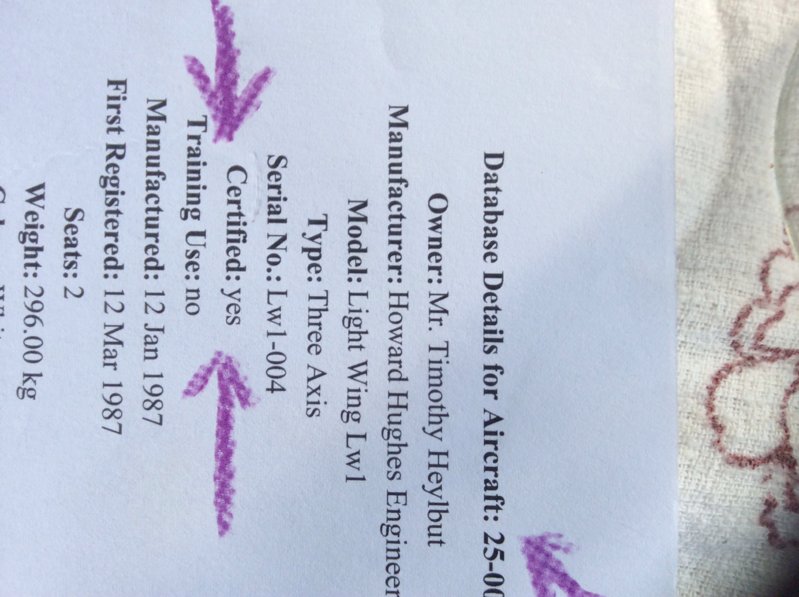

[ATTACH=full]29052[/ATTACH] Mine is 25. LW-1. Says certified?
If factory built and certified, which is the case here then why can't this aircraft be used for training?
Does this mean some 25 registered light wings out there that were built by someone from a factory kit are still Certified?
This whole rego thing is so confusing. I can see why there has been so many issues with the Rego CASA Audit.
Cheers
It
If factory built and certified, which is the case here then why can't this aircraft be used for training?Does this mean some 25 registered light wings out there that were built by someone from a factory kit are still Certified?
Cheers
it can ! Just means at present I have not marked it as being used for training as it's private use
