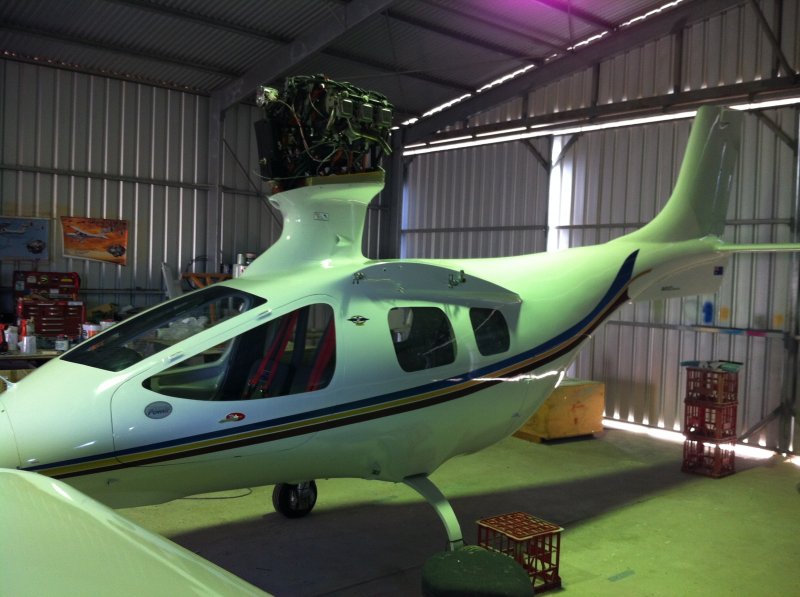

AVOCET Posted May 21, 2013 Author Share Posted May 21, 2013 Some photos of what's been happening Link to comment Share on other sites More sharing options...
Mark11 Posted May 21, 2013 Share Posted May 21, 2013 Amazing work in rebuilding.... I would have thought it easier to start from scratch.... Link to comment Share on other sites More sharing options...
AVOCET Posted May 21, 2013 Author Share Posted May 21, 2013 There was to many good bits that weeny that badly damaged, It cost $100.000 to build the fist one and only $20,000 to rebuild 1 Link to comment Share on other sites More sharing options...

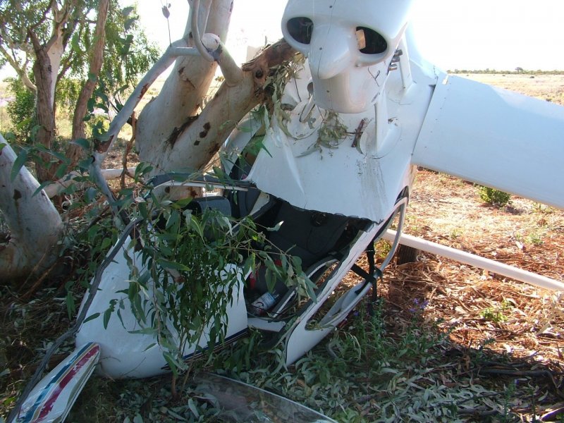

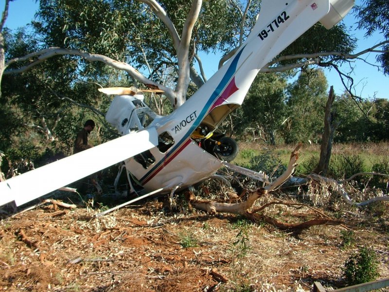

Old Koreelah Posted May 21, 2013 Share Posted May 21, 2013 Crickey Mike, what happened? I must have been living under a rock- I hadn't heard of your bingle. Looks nasty, but great to see you have built. 2 Link to comment Share on other sites More sharing options...
AVOCET Posted May 21, 2013 Author Share Posted May 21, 2013 I think I was the one living under the rock , at the time I didn't really feel like talking about it . I was on my way to the last wide bay air show and near Willcainia NSW one of the exhaust pipes cracked off and fell against the oil pressure sender wire , shorted it out . So I heard a rattle and no oil pressure , 750 hrs on the 3300 I thought a thru bolt had gone , 7500ft an old station air strip below I glided down to land , got to slow turning base to final 30ft agl , kept banking to left , couldn't lift wing , it all happened that fast and bang the tree . Broken sturnum , cut arm , 5days in Broken hill hospital . Anyway , all history now . Took a while to get over it though . 1 Link to comment Share on other sites More sharing options...

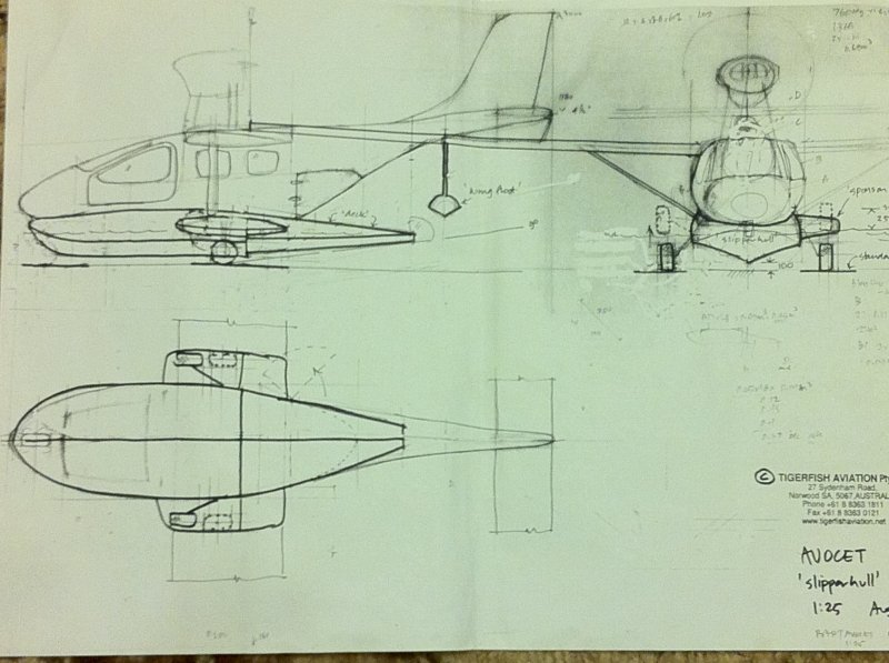

AVOCET Posted May 21, 2013 Author Share Posted May 21, 2013 Thanks for the promp Howard , I think Raa registered ,well it was ! ! I'm stating think it might be time to :to:to: too ,two ; (I just carnt bring myself to say what I realy think ???!!!).still waiting, it ran out 7th April ,i paid the renual 3weeks prior ! Ill think ill just talk about the plane , ...... Nose cones for battery x2 (ballast), Back doors open up for cargo , stretcher , motor bike , camping gear ect , It's got a liquid cooled multypoint fuel injection , fuel injected throttle body , Plane power 30 amp alt,(that bolts to vac attach on the 3300jab. That gives 2 of all the important stuff , (wont stop you having a prang though ) I originlyv had the Idea of building a single bed Ariel Ambulance type that could be used in the third word as a cheap alternative to a helli copter . I had 56 hours up on it so far , easy to fly &very stable in the air , lands easy , it was really a nice surprise when I first flu it , doesn't seem to have any great pitching issues , if I can jump in and fly it , (I've only flown jabirus ) It has the same control responses as any pusher , but being biggish , it's not so pronounced . Ill be getting around to the air shows this year , you could easy make a 4seater , and I've got concept drawings for an amphibious version , (See photos) Cheers Mike 1 Link to comment Share on other sites More sharing options...

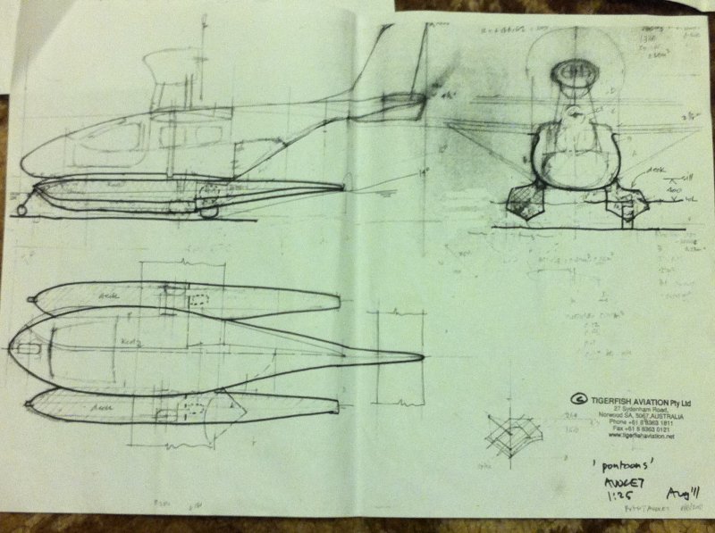

Mark11 Posted May 22, 2013 Share Posted May 22, 2013 Like the amphib and the roomy size (I'm 6' 2") and prefer not to have my passenger or CFI in my armpit ... I'll have one if I can get from wollongong to hobart in one hop Link to comment Share on other sites More sharing options...
AVOCET Posted May 22, 2013 Author Share Posted May 22, 2013 By all means , although the amphibious version is still only a concept .iam looking for interested parties to develop the amphib. Wollongong / Hobart in one go , maybee with a good tail wind and an empty bladder ? Cheers . Link to comment Share on other sites More sharing options...

av8vfr Posted May 24, 2013 Share Posted May 24, 2013 Just an observation which may be incorrect (it happens), but it was originally a pusher but now in the hanger it looks like a tractor config.. if correct, is there a reason? Link to comment Share on other sites More sharing options...
Keenaviator Posted May 24, 2013 Share Posted May 24, 2013 Just an observation which may be incorrect (it happens), but it was originally a pusher but now in the hanger it looks like a tractor config.. if correct, is there a reason? Might have to check your observation. Don't you notice the turret sitting above the cabin? A difference I noticed is that the turret is now a single faired unit whereas before it was standing on four faired tubes. Also, what appears to be a spinner is probably a spinner moulded into the now front of the cowling probably to mimick the shape of a standard Jabiru cowling for cooling purposes. Looking very nice Mike, Regards, Laurie Link to comment Share on other sites More sharing options...
av8vfr Posted May 24, 2013 Share Posted May 24, 2013 Might have to check your observation. Don't you notice the turret sitting above the cabin?A difference I noticed is that the turret is now a single faired unit whereas before it was standing on four faired tubes. Also, what appears to be a spinner is probably a spinner moulded into the now front of the cowling probably to mimick the shape of a standard Jabiru cowling for cooling purposes. Looking very nice Mike, Regards, Laurie The original accident pics shows the prop in a pusher config... To me the prop flange now appears on the front of the donk in the single faired image..(tractor config)?? Link to comment Share on other sites More sharing options...
Keenaviator Posted May 24, 2013 Share Posted May 24, 2013 I think you're confusing a belt driven alternator for a prop flange. 1 Link to comment Share on other sites More sharing options...
av8vfr Posted May 24, 2013 Share Posted May 24, 2013 Could be... just looked like a prop flange above the oil cooler....my bad... Link to comment Share on other sites More sharing options...
